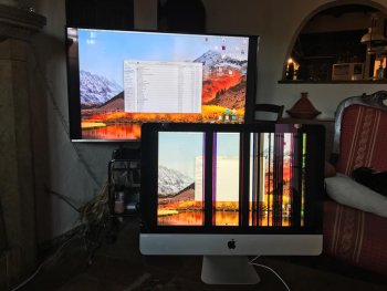

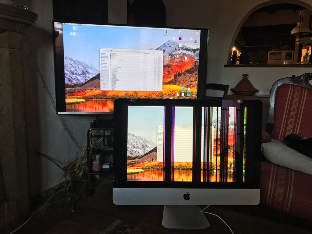

I've tried it with an external monitor and it works perfectly... no lines, no flashing on and off, nothing. So I bought a second-hand LCD and swapped it over expecting this to be the end of my troubles but, no. Only some vertical sections of the screen are visible (image attached).
So, to recap, the original screen is completely blank, the replacement screen is only partially visible, it works fine with an external monitor and, one other thing, the fan is at full tilt in all instances.
My next cheapest option is to change the connection cable to the LCD but logic tells me that with both screens acting differently, this is not where the issue lies.
Any ideas?
Any ideas?
You bought a second hand display. Are you sure it worked fine before you install it? Any hit or pull on the video cable? I'm almost sure the problem lies on the screen
I think problem lies within your imac screen, or screen cable or logic board connector.
Replace screen first, see if that helps..

I saw the display working before I bought it so I know it's ok. I'm going to try changing the connection cable and will post the result in case anyone else is having the same experience.
