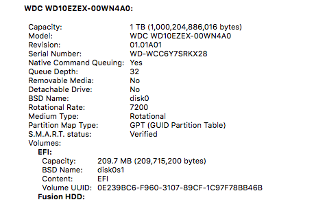

Your answer about the fans is not correct . the HDD do not need special Apple firmware. All modern HDD of any manufacturer use the SMART protocol which is an industry standard the firmware is installed in all HDD currently manufactured. Using the SMART protocol you can monitor a number of variables on the "health " of the disc drive , one of them happens to be its temperature , Apple now uses this variable in place of the "old" thermal pad. If you change your drive and the fans speed up it is because you have not put the HDD temp lead ( which is actually the SMART lead) back onto the correct pins of your replacement disc drive. The confusion comes because the three main manufacturers that Apple uses ( Western Digital , Hitachi and Seagate) have a different two pin connector on the "temp" lead and it goes to different pins on the HDD. If you want to replace your drive because it failed or because you want a bigger one it is advisable ( but not essential) to select your new model from the same manufacturer that your machine currently uses that way the two pin plug will fit , and you can make sure you put it on the same two pins as the original drive. If you do this YOU WILL NOT HAVE ANY PROBLEM WITH SPEEDING FANS PERIOD!! I have changed many drives in Imacs and never had any problem with the fans as I understand how the machines work , even if you change the make of drive you fit , all you have to do is find out which pins that manufacturer uses for the SMART output and fit the correct plug for his pin spacings and you will have no problem. I have attached a file that shows my hard drive , note the S.M.A.R.T. status verified line in the system report , that tells me the OSX is reading the temperature of my drive so if you get this you know you are on the correct pins for the temp monitoring of your HDD.

Having read your text again I will add this , I agree with you if you remove your hard drive and just fit an SSD you will have problems with the Fan , as there is no SMART information to read from the SSD as there is in a HDD ( there is however SMART info available from an SSD its just that Apple have not got round to using it yet) .
However one thing to note is that however you fit your SSD you must enable "Trim" in OSX . SSD's work totally differently from HDD , where you used to "defragment" the drive to speed it up. If you dont enable trim you will eventually find your SSD starts to slow down. Trim enables the SSD to "clean up" the unused memory locations and keep the drive working at its optimum speed. Trim works in the background when the machine is quiet it requires no user interaction.
So, read all of the above my doubt remains the same, if I wanna change the old hard drive with an SSD I will have the problem of reporting the temperature to the operating system to regulate the fans speed?
