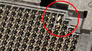

Check the pins in the cpu socket under a magnifying glass, perhaps some of them are bent and causing a short?
If any are bent you can gently bend them back into position with a sewing needle or ultra fine tweezers.

hi again thanks for the reply.
so I checked over the cpu socket with a magnifying glass and found no issues at all there.
the only other thing I can think is the logic board is bad and to be honest I don't think its worth spending anymore time on.
