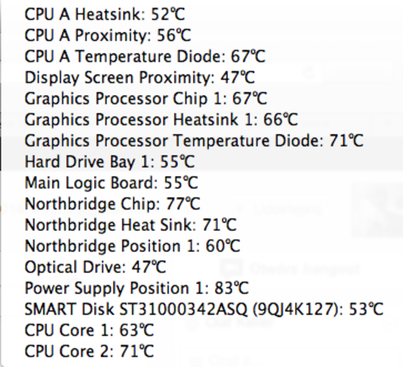

I would like to know what are the safe temperatures in Celsius to avoid fire in my room? This picture below is representing what is going on inside my iMac now.

You don't have to worry about your Mac starting a fire. The Intel processors used in Macs are designed to automatically shut down to prevent damage if they truly overheat. CPU Tjmax = 105C (221F), GPU Tjmax = 100C (212F) on i3, i5, i7 processors. (Source: Intel)
If you're not already using it, iStat Pro (free) or iStat Menus ($16) will give you accurate readings of your temps and fan speeds, among other things.
Unless there is a rare defect in a Mac, most temps are well within the normal operating range, considering the workload being put on it. Websites with Flash content, games and other multimedia apps will put higher demand on the CPU/GPU, generating more heat. This is normal. If you're constantly putting high demands on your system, such as gaming or other multimedia tasks, expect temps to rise and fans to spin up accordingly. It's just your Mac doing its job to maintain temps within the normal range.
It is also quite normal for your Mac to become extremely hot to the touch during intensive operations. The aluminum body transfers heat more effectively than other materials used in computer casings, so you will feel the heat more. This doesn't indicate that it's overheating and will not harm the computer to be hot to the touch.
Your fans are always on when your Mac is on, spinning at a minimum of 2000 rpm (for MBPs) or 1800 rpm (for MBAs, MBs and minis). iMacs have 3 fans with minimum speeds in the 800-1200 range. They will spin faster as needed to keep temps at a safe level.
