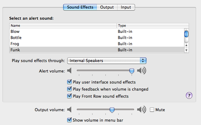

I had this problem the other night with my 24" imac after updating to 10.6.8
Here's roughly what i did to solve it (cant remember exactly)
Go to system Preferences
Click Sound
Where it says "play sound effects through:" i had a few different options. I changed this to internal speakers (i had not other speakers or headphones plugged in)
I dont know why the other options where there because i've just checked on my work imac (21.5) and it only lists internal
hope this helps

I get this

I get this
Out of nowhere, my iMac external speakers stopped working. I checked them using the MBP, they worked. Plugged in headphones, they didn't work.
Did some searching and came across this thread.
I ended up going into systems pref>Sound>Output> Under Type it read 😕 I don't remember.
Went to Sound Effects and selected Play sounds effects through Headphones.
Output volume I had to deselect Mute.
The external speakers now work.
