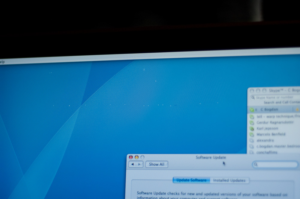

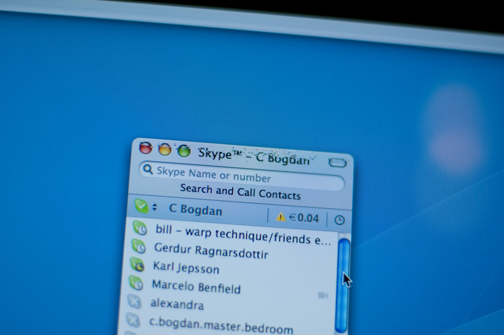

yup. After scavenging these and other forums with interest re the new 24" display issues, I decided to get one today in the Apple Store regent street london. I asked them sales people there if they had heard of this issue and of course they hadnt =)
Have a look. Damn, I really like the mac, but can´t accept this quality since I do quite a lot of retouching of my own photography. Will probably return the machine and try another one or two before I give up..
Do you guys think there actually are any acceptable (in my case) ones around?
If those are dead pixels running through the top of the "Skype" window in photo #4, that panel is seriously sick -- and Apple will almost certainly exchange it without question. The 24" iMacs typically have no more than one or two pixel defects -- and many (most?) have none at all.
Mine has one duff greenie, in a very unobtrusive lower corner.
...it adds character,

Holograph, those pics you are showing don't exhibit the complaints people have been having, you just got a faulty computer. I can assure you if anyone including myself (since I have the same computer) had those artifacts on our screens we would not ignore them and say we're not having any issues.
