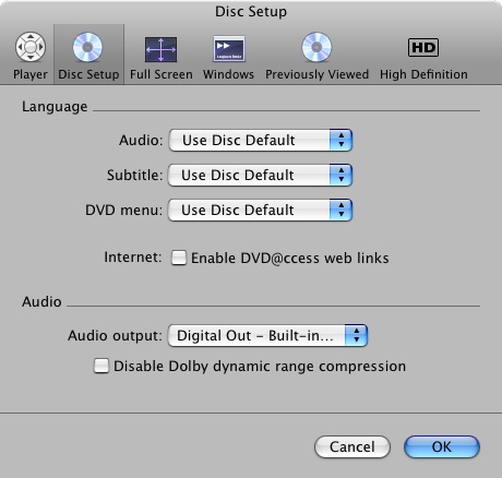

To get full 5.1 Dolby Digital/DTS sound out of your speakers in movies, in DVD player go to Preferences, and set the Audio Out to Optical Out. You would think it would change when the optical cable is plugged in but it does not. After you do this you will get the Dolby Digital signal into the Logitechs, and hear true 5.1 sound. To get it in VLC, do it the same way... Optical audio out is somewhere in the preferences.
"System Out" should be changed to Digital Out, as seen in the screenshot. The status should change on the control pod to DD 5.1.
attachment.php
Maybe changing DVD Audio from Disc Default to Dolby Digital or DTS 5.1 would be a good idea too.
