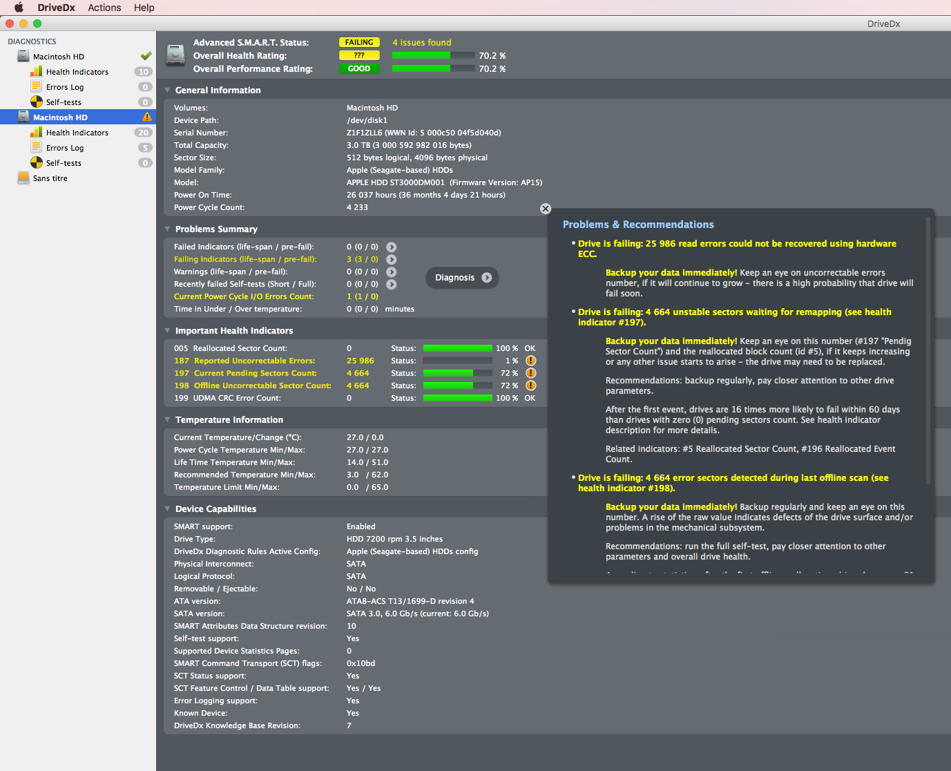

Here are the results. Verdict? I was right?
Thanks for the suggestion of the software, it's neat! My "Fusion" 128GB status is Good with 83% life remaining.
So I replace my HDD 3TB now with a 1 TB SSD EVO 850 or a 3TB Seagate? 🙂
Reactions: killerovsky
IIRC, the value of SMART is that while it may incorrectly say that you drive is OK, if it says it's not, then it is really failing. So your drive is failing. If it were me I would copy the most important files to an alternate media right away.
You definitely need a new hard drive!!! I don't have enough Seagate experience to comment on that specific model (as my HDD usage is mainly from certain HGST and Western Digital models). But I can say that the 850 EVO is an awesome drive that will serve you very well should you decide to keep it, and even when you get rid of that iMac you can throw it in an enclosure and still have a spectacular external SSD.
