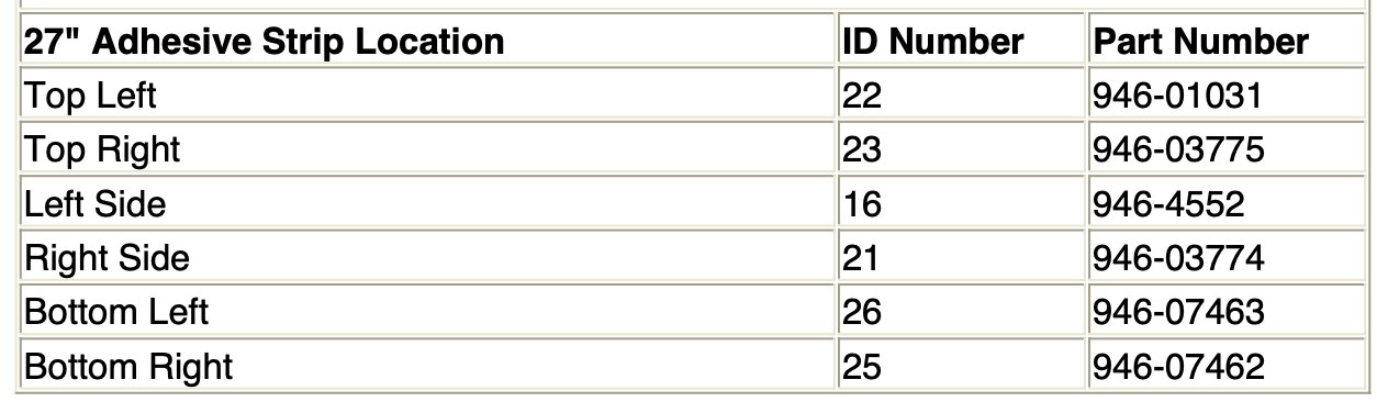

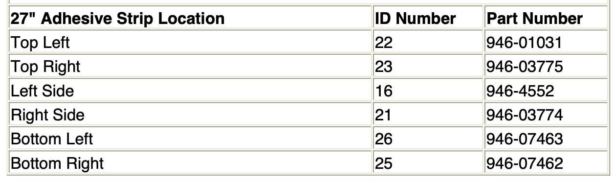

The cheap strips can be very sticky and fine for fixing the 27"screen.
Mine stuck straight away and has been fine for 18 months.
The big problem seems to be the thickness of the tapes.
The ones Apple uses keep the screen glass perfectly flat with the aluminium chin of the iMac. absolutely smooth to the fingertip.
My iMac (a DIY 5K monitor) has much thinner strips, so I can feel the aluminium chin sticking further out than the panel glass.
It's not the sticky tape that is thinner, it's the inner foam core which has the adhesive surfaces on both sides that isn't as thick.
This means it is likely to be much harder to take the screen off again, as the pizza wheel cutter cuts through this soft foam core easily.
If it has to be cutting through the actual plastic backing of the adhesive it will be much more difficult to separate the two sided of the tape to get the panel off.
This means that in future I am ONLY going to source strips marked with the the correct Apple part number on the strips to use in future.
The numbers are like 076-00009 for the full set, but each strip is marked.
Edit: The first number is Apple's build part. The second the repair kit number.
iMac (27-inch, Late 2012) 076-1444 076-1419
Mac (27-inch, Late 2013) 076-1444 076-1419
iMac (Retina 5K, 27-inch, Late 2014) 076-1444 076-00009
iMac (Retina 5K, 27-inch, Mid 2015) 076-1444 076-00009
iMac (Retina 5K, 27-inch, Late 2015) 076-1444 076-00009
iMac (Retina 5K, 27-inch, 2017) 076-00330 076-00332
iMac (Retina 5K, 27-inch, 2019) Refill Kit: 076-00332

The numbers are part of the manufacturing process.
'Any cheap seller' won't be selling them cheap if they go to the hassle of adding the numbers to each individual strip in the set...
Each different model-year set has different numbers.
Do you know of a reputable seller/source?
When ordering online, it's impossible to check whether the seller is honest, and whether the numbers are printed on each individual strip!

This is not my store nor am I endorsing them, but this is the supplier I used in September for replacing my strips after doing a bunch of upgrades inside.
Their kit (I variant I ordered shipped with a pizza-cutter tool and extra cutting discs) used colours, not numbers. What I had to do before the re-adhering step was I laid out the strips on the table in the position they would need to be placed.
In the product pics, you may note red and blue tape markers. The two red ones were for the bottom of the display. The adhesive is quite strong, even before accounting for my own prep work using heat.
