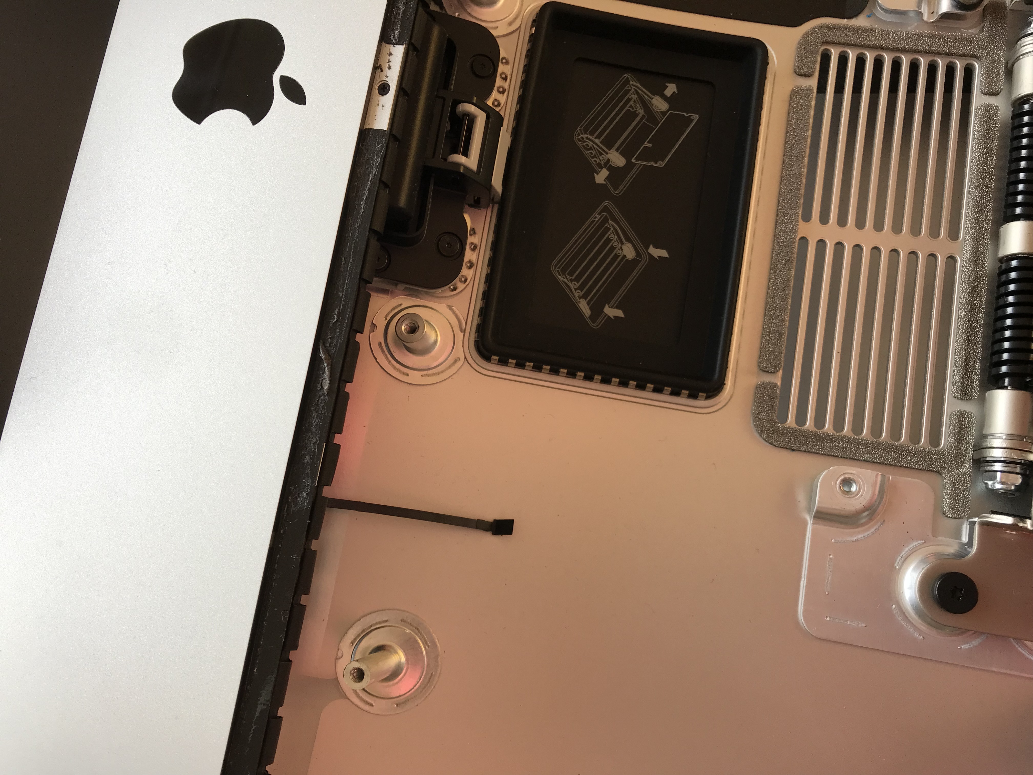

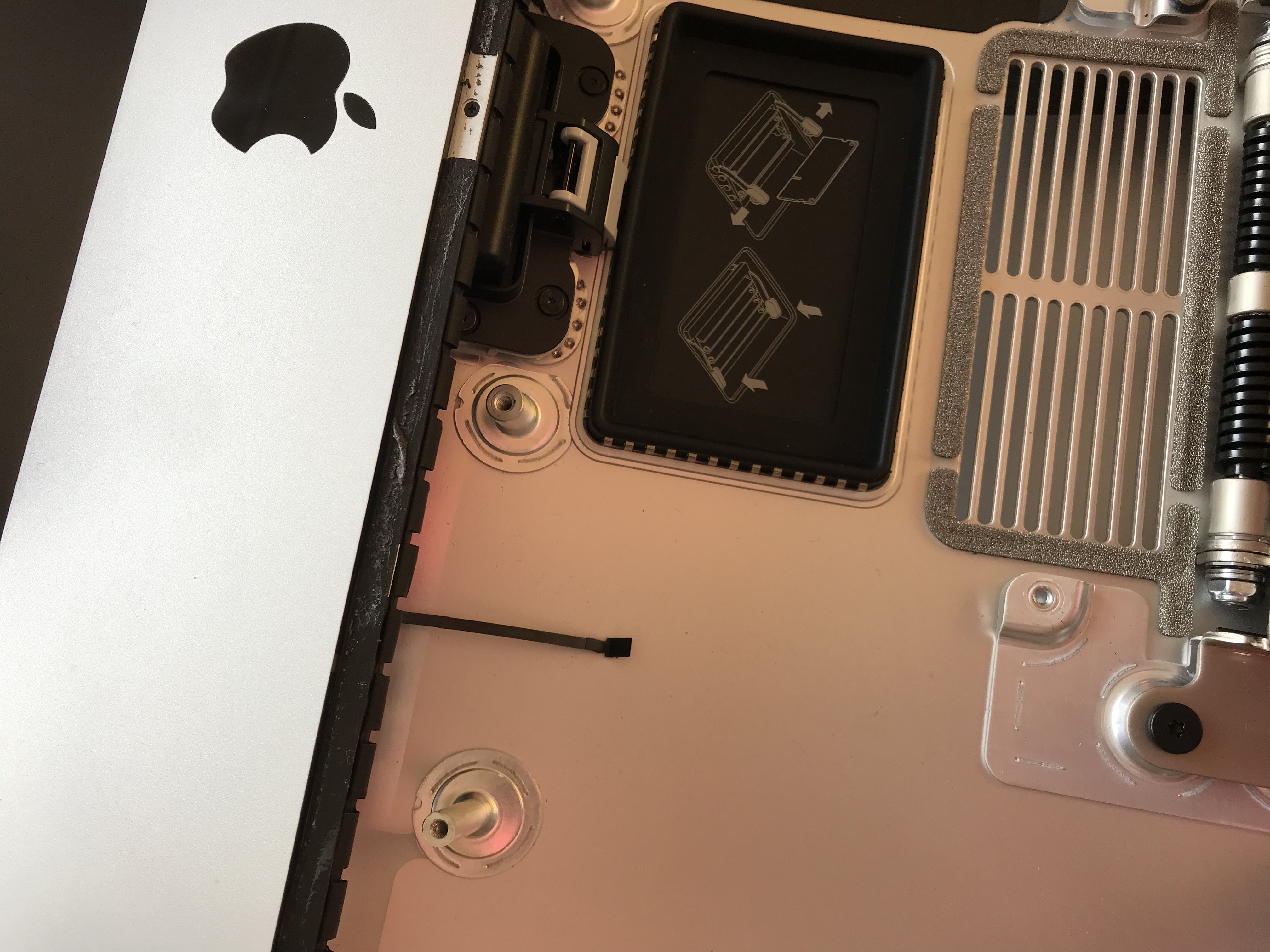

Does anybody know what this cable is meant to attach to on the logic board?

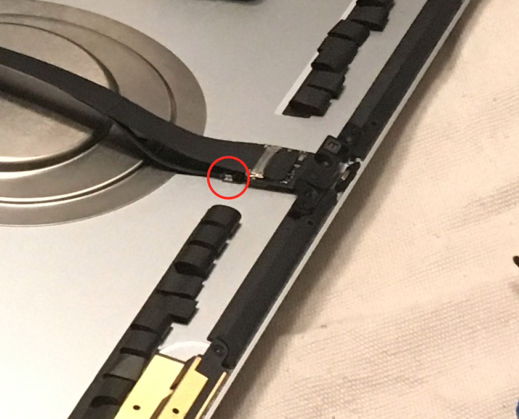

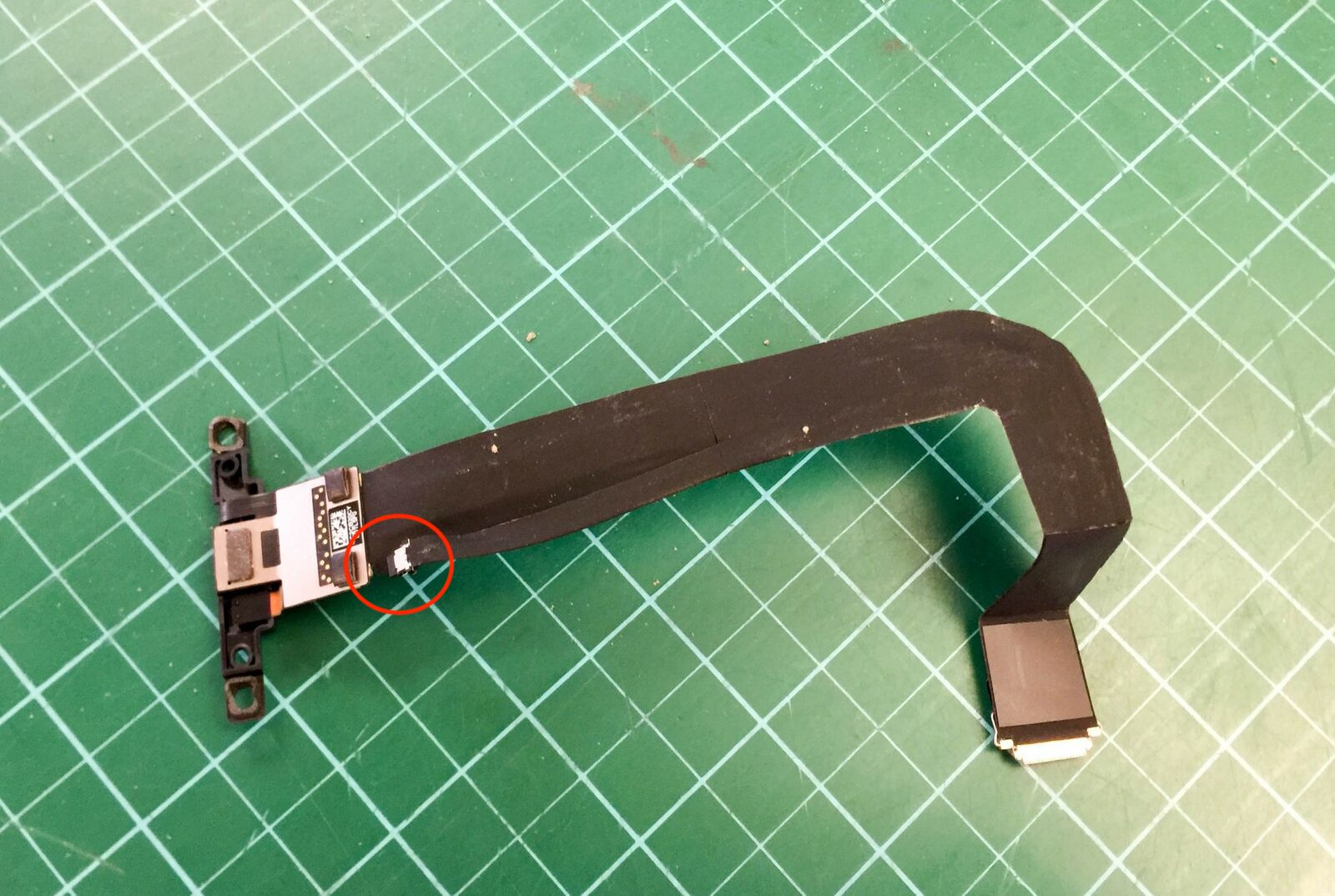

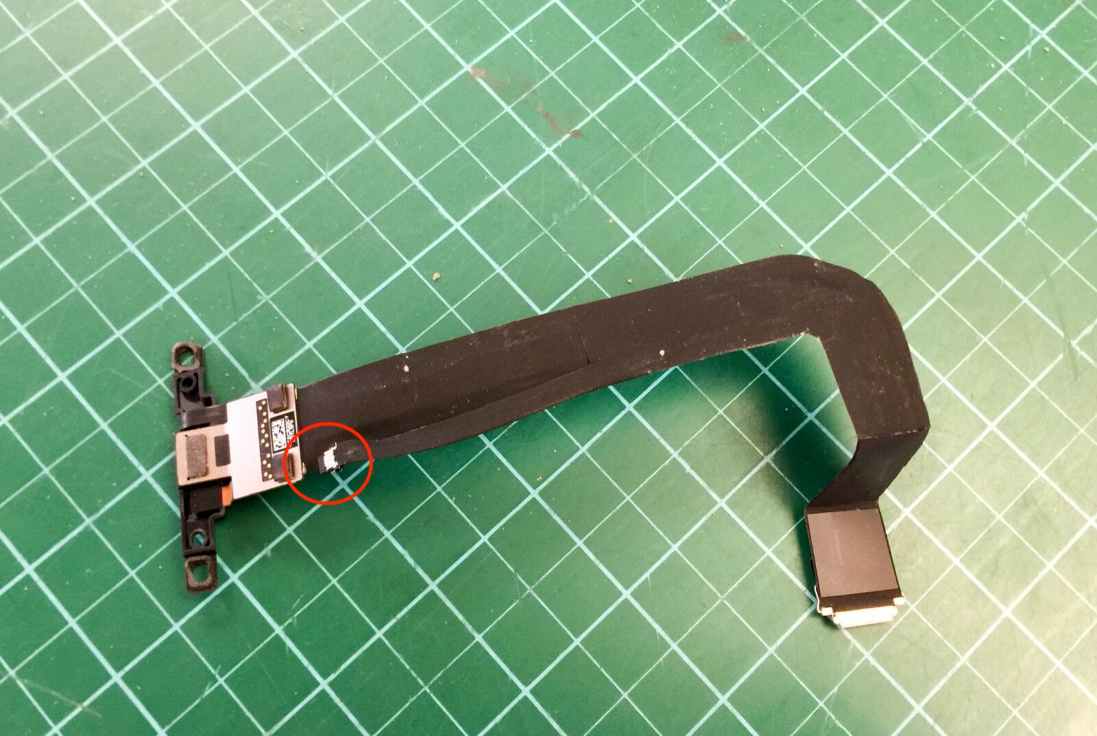

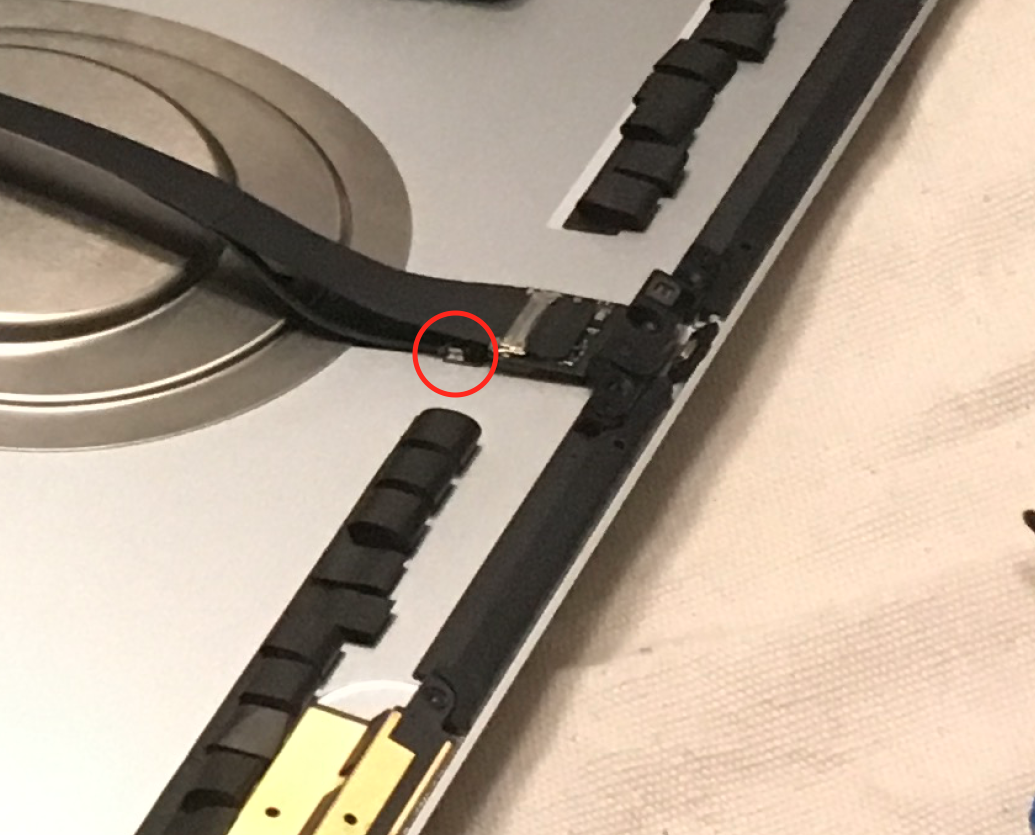

That looks like part of the microphone cable and connector that is integrated into the iSight camera cable.
If that is it it plugs into the microphone on the case (located on the back of the iMac). Here is a pic of mine and you can just barely see it.

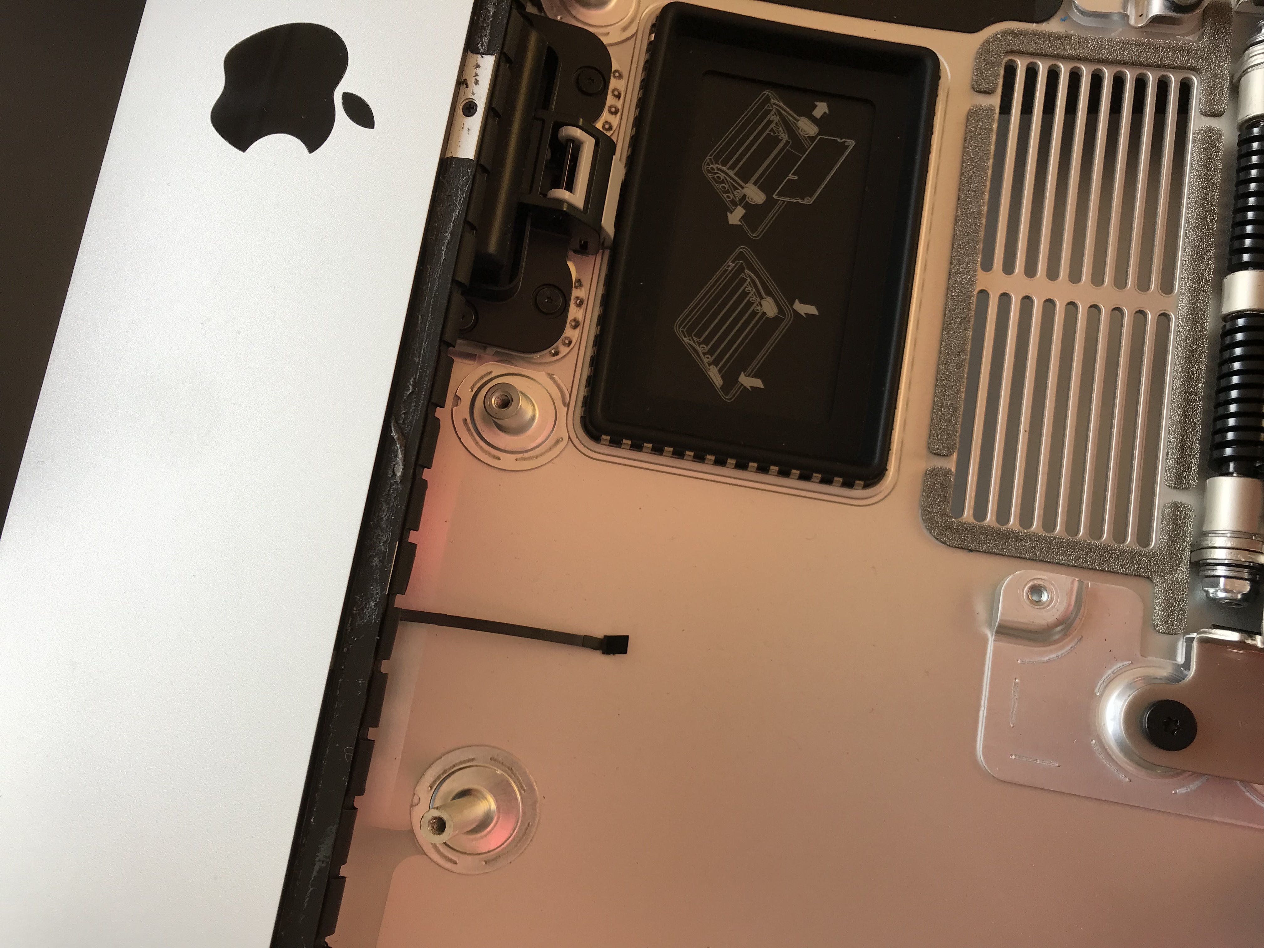

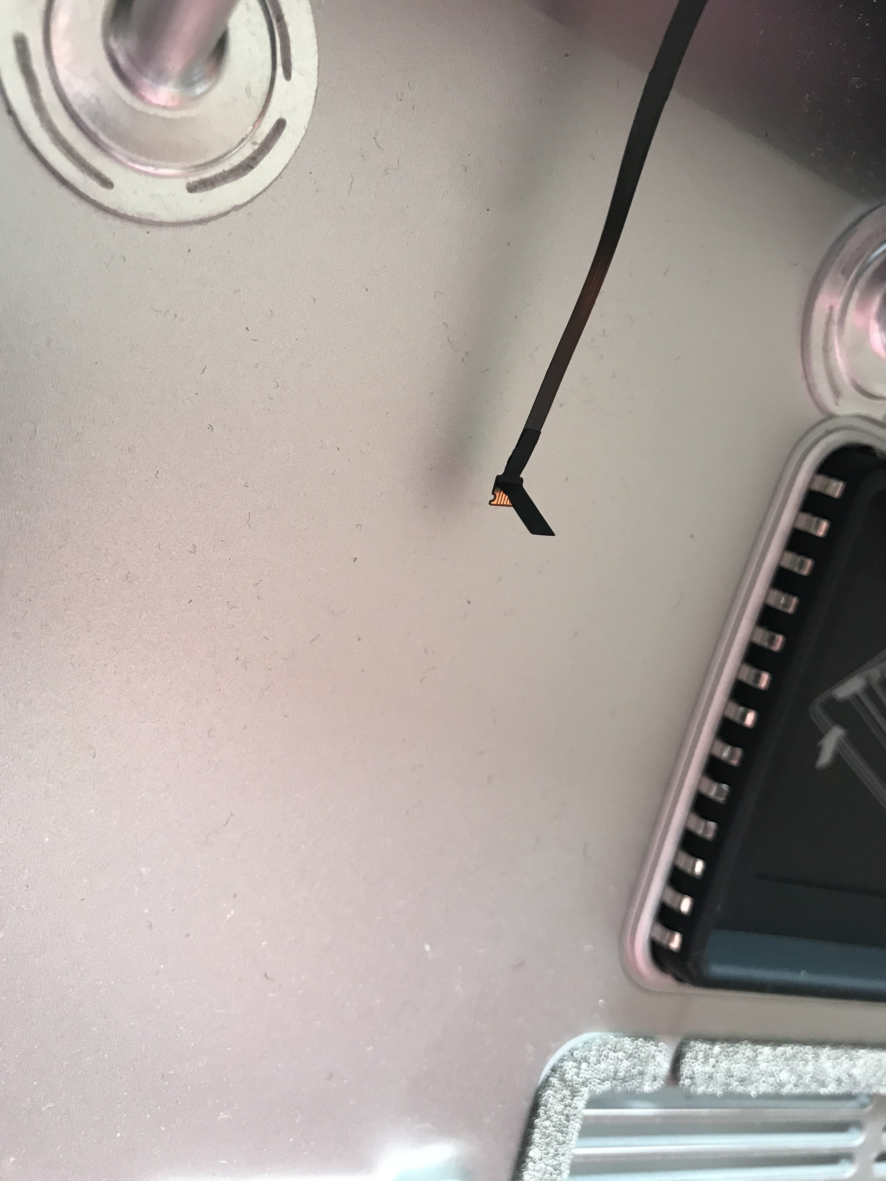

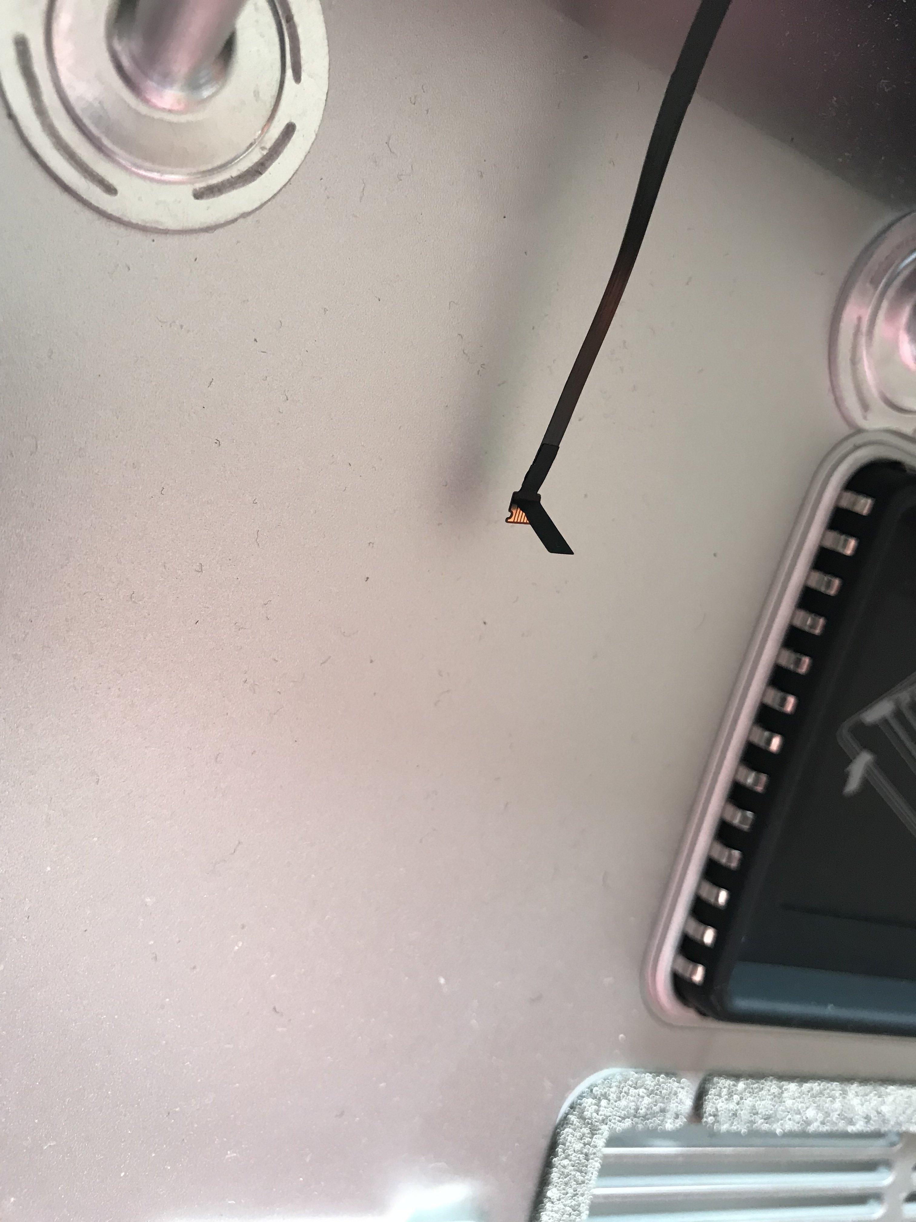

Ah yes it does look like it, but mine is coming from the other end of the iMac...

This is the microphone cable.
See this video:
(9:24)
Yes! Thank you.
