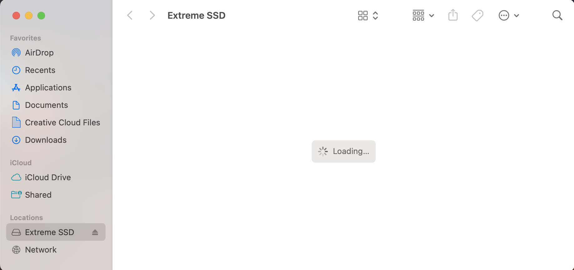

iMAC 27" 2020 I have an external drive for photo storage. The Mac recognizes it but took a very long time to load (several minutes). It now has Ventura and never finishes loading.
Update, I have a Scandisc Extreme SSD that the MAC recognizes, but will not load - just keeps saying "loading". I also have a Seagate backup plus hub and get the same from it. This computer has always been slow to load these drives but since Ventura, they won't load at all. The Seagate reports OK after running the repair utility. I guess both drives could have gone bad at the same time, but doesn't seem likely. Any help appreciated.
Can you take a screenshot? I'm actually not sure what you mean by "just keeps saying 'loading'". The Finder window?
The Mac shows the drive on the desktop. When you click it to open, then the above window opens with the spinning wheel but never quits loading.
It may not help but are you able to see it in Disk Utility and try a repair? As far as I know only Disk Utility is able to fix APFS problems. Third party utilities just put their own wrapper around the same commands Apple uses.

Update: After trying a lot of suggestions that did not work, I got a notice that 13.2 update was available. With nothing to lose,I installed the update and everything seems to work now. It is still slow to load files, but it does work. after initial loading, transfer seed seems OK. Thanks for all the suggestions.

Thanks for the question/suggestion on the backup. Yes, I have another backup but neither would work until the latest update. The drives are formatted ExFAT since files go back and forth to pcs on flash drives. I've been told that APFS won't allow that. You can tell that I don't know a whole lot about the computer workings, although I am trying to learn. Normally I just use them.
