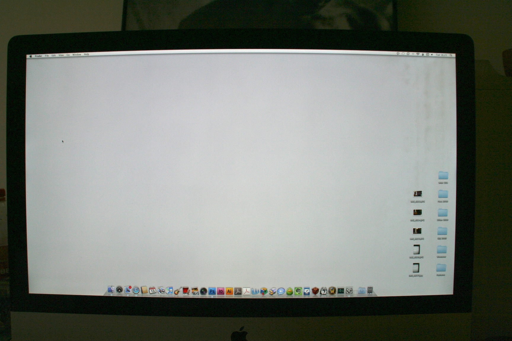

The black spots are starting to come back, AGAIN. They just replaced the panel a few weeks ago and already I can see them. It's something else thats obviously causing this problem. This is beginning to be frustrating. Its not easy to lug this thing back and forth to the mall for them to see it. I hope they replace the whole damn thing. This is what I get for buying this thing when it first came out.

From the posted pictures, those black blotches look like they could be some kind of mold. The fact that they spread, or spontaneously appear after time, is a characteristic of mold. Mold spore contamination could have been on the panels' front plastic sheets before fabrication.

Just posting to share with you guys that my brand new 2 month old 27 i7 iMac developed similar problems on the upper left and right of the screen. Perhaps the heat has a denigrating effect on the screen? This one does get much hotter to the touch compared to my C2D iMacs...
Will be sending this to the shop soon.
