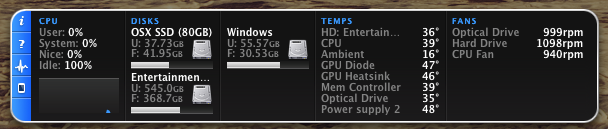

Hmm. I am by all means no expert but I find it a little strange. Here are my temperatures and fans speeds after watching a .mkv 1080 movie
if the internal temp sensor is providing an inaccurate reading then your fans will run a lot higher to either compensate for something that could possibly not be a problem...
has your computer shutoff from overheating at all?
you could try SMC fan control and force the fans to run at a normal speed and watch the temps and see if they climb..
