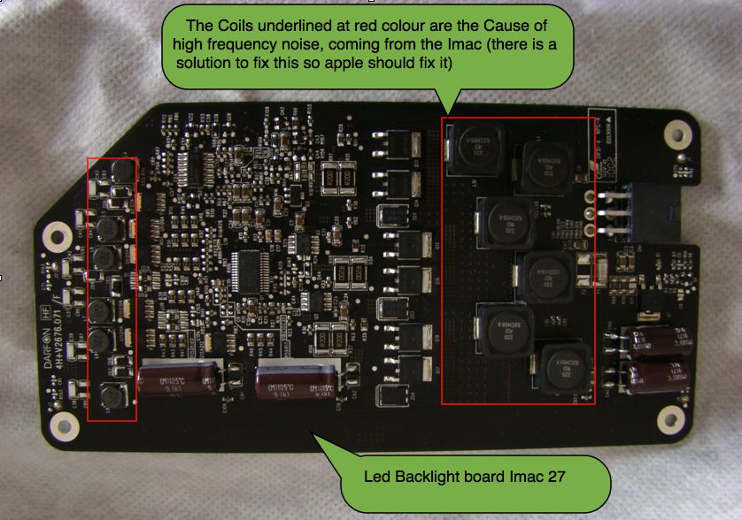

    I received my Imac 27 I7 and after the initial setup, I notice that the computer was making an high pitch noise coming from the left corner, when I change the screen brightness to minimum or to maximum the noise disappears, if the screen brightness is between 40 to 90% the noise starts again, as I´m an electronic engineer, I decided to disassemble the imac to search the cause and I found it. The problem is caused by the coils from the led backlight board, see picture and youtube video for better understanding, if someone on this forum works as an electronic engineer at apple, please check it and address this issue to the development team of the circuit.
    You should push the volume up to listen the high frequency noise coming from the coils in the video.

    I couldn't hear any noise (too high a frequency for YouTube?), but a buzzing converter points to a stability problem of the screen LED power supply - a shame really.

    And unfortunately, many type of LCD screens have this problem. Its nothing new and not only limited to the iMacs.

    Hi Tony,
    Sorry for the late reply, If you go to the store with the computer, it´s very difficult to hear the noise because there is so much sound frequencies around your ears, therefore you and the technician have to listen to it, in a quite room, to completely trace the noise coming from the iMac, otherwise the technician would think that you are crazy and won´t believe you.
    I made some tests and I can say with 100% confidence that:
    Buzz noise = to power supply
    High frequency noise = Led backlight board
    Best regards.

    The technician told me that he fixed - changed both the power supply chip(?) (from inside) and the backlight supply, and guess what: 1. the buzz noise remains exactly the same, 2. the high pitch noise remains the same. It is as if he didn't repair anything..
