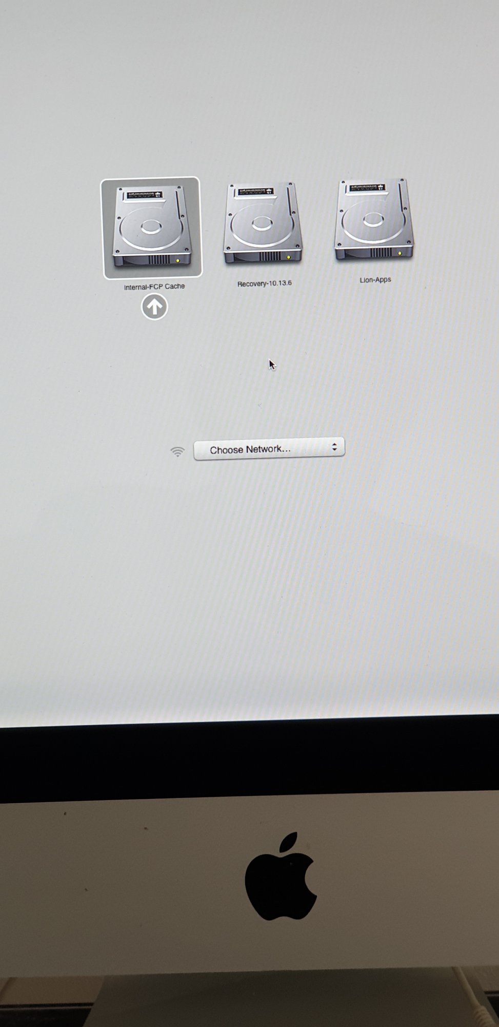

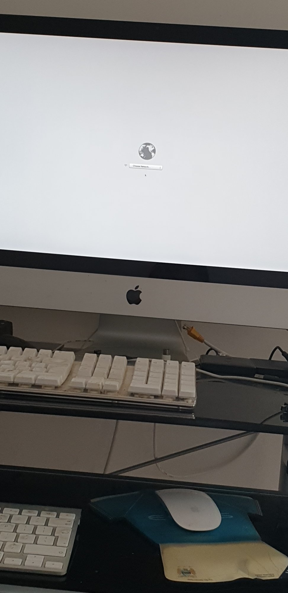

Ethernet unplugged only wired keyboard left plugged in.Started mac again,pressed D and it loaded with starting internet recovery screen and spinning globe and now it asks me to choose the wifi network

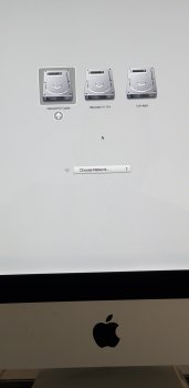

Restarted it,Pressed and held D and it goes to the starting internet recovery screen and choose network like in the image i posted
That is new to me. At least you know you can get into internet recovery.

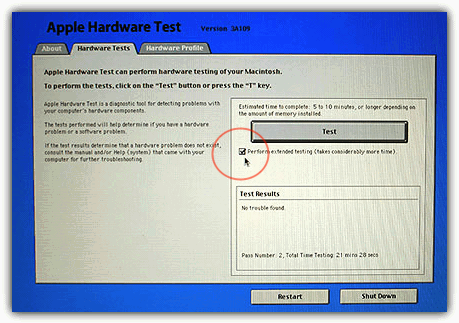

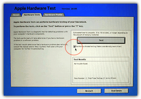

How do i do the long test?
IIRC, there is a little button to select, see the screen shot, it is in the read circle:

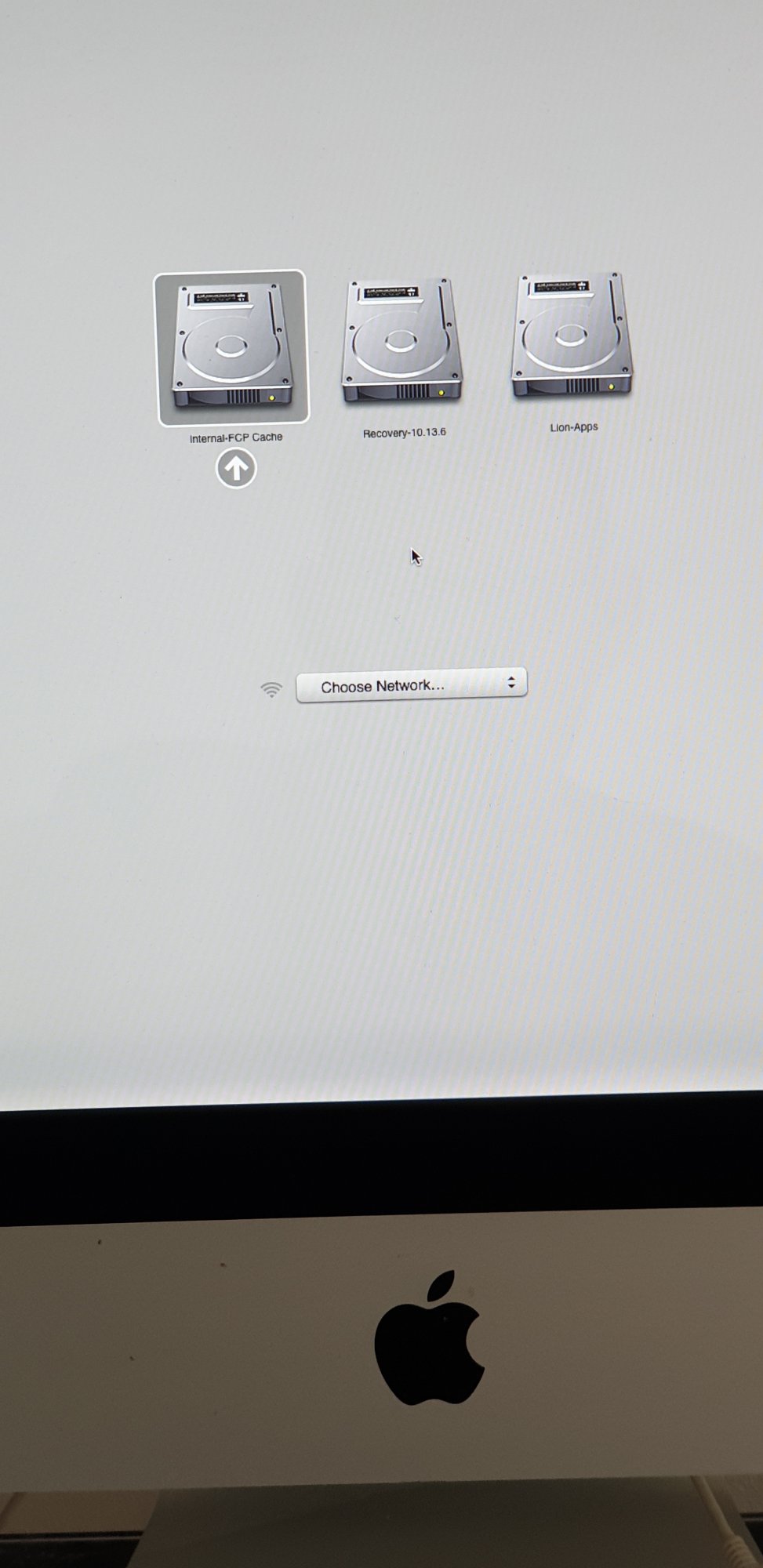

I just tried "shift" to boot to safe and i now get three drives show up with arrows which didn't happen before.I click recovery and it just goes to grey boot screen (see image)
I also know the drive has been grinding for a few weeks on startup and it takes a while to stop and about 10 minutes before i can use mac properly so i defo think drive is the problem
