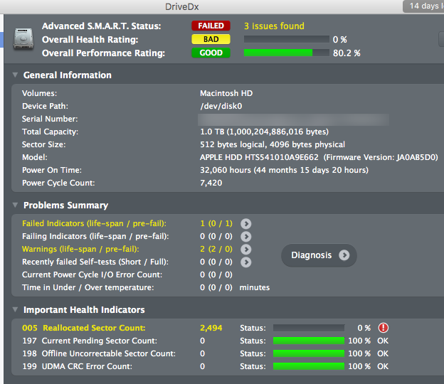

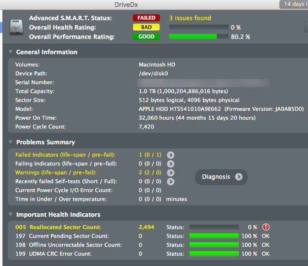

I've had the same symptoms on my iMac (21.5-inch, Late 2013) 2.75 Mhz, 8GB RAM, 1TB HDD for quite some time, and decided yesterday to run some tests. EtreCheck, Disk Utility, and DriveDx all reported the same thing... the hard drive is going/gone.
I just ordered a replacement (a new iMac), but will use the suggestions in this thread by @Fishrrman to use this old one (iMac) for some other purpose.
I just ordered a replacement, but will use the suggestions in this thread by @Fishrrman to use this old one for some other purpose.
Using an old one for any purpose is not a good idea. Dying hard drives are volatile.
Just give it to some repair shop. Or open it and use an acrylic box to make it into an exhibit for it served you well in long years.
I agree, I've had a good run with it. It isn't work the cost of repairing it though. Since I have no plans on using the internal drive, I see no problems with using an external bootable USB SSD to boot from (as previously suggested) and another external drive for data. It won't be used for critical purposes.
