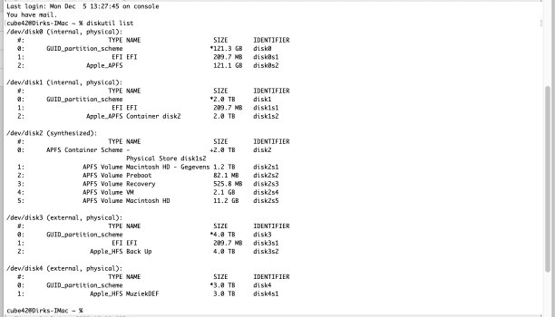

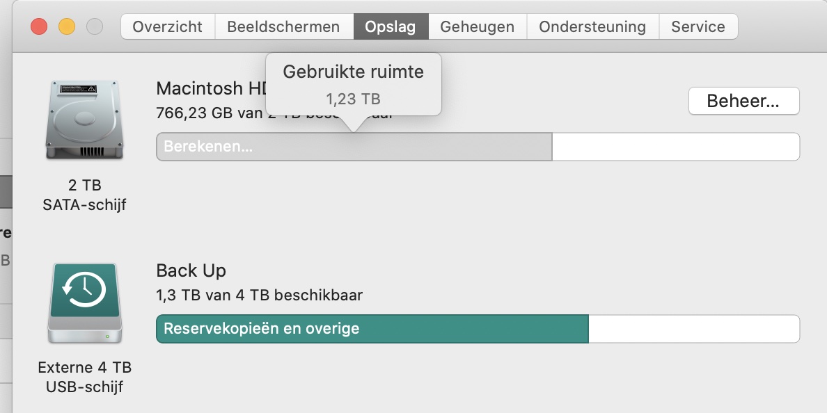

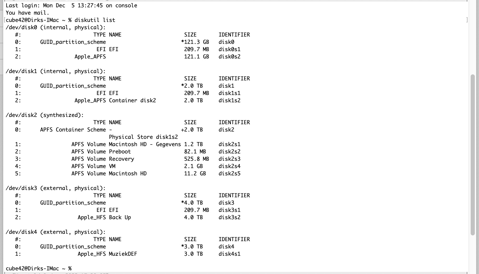

My 2 TB Fusion drive has become a SATA Drive of 2 TB. I have an IMac 27 inch late 2015 with a 2 TB Fusion drive. After an update my computer crashed. I had to install the OS X from the OS that came with the IMac. I have updated everything to OS Catalina 10.15.7 and i use the Time machine back up to restore. But when i started the IMac i noticed that everything was soo slow.. `everything works slow. Opening apps, opening windows...slow. And then i noticed that my Fusion drive was a SATA drive! If u go to about this mac and then go to 'storage'. then u see that it is an SATA drive instead of Fusion. What can be happened? Is this why my. machine is so slow? Does the IMac not see the Fusion drive?

Looks like your [previously] "fused" drive got UN-fused in "the crash".
That is, it is now "in two parts":
- the 128gb SSD portion
and
- the 2tb HDD portion

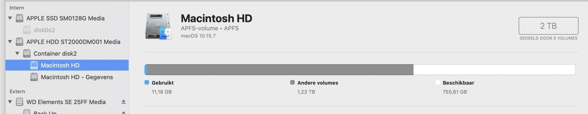

And... your "restore" got put onto the 2tb HDD portion (which of course is a platter-based HDD and is slower).

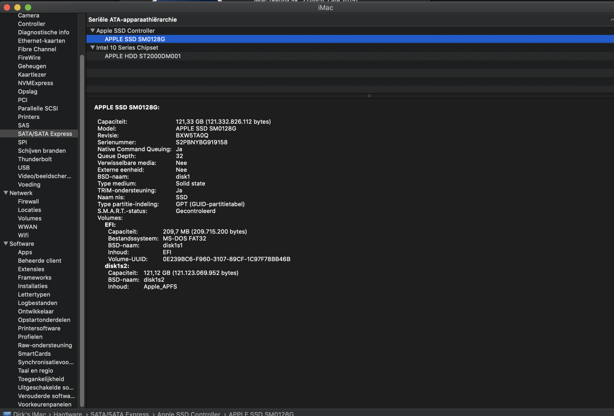

I agree with @Fishrrman that you no longer have a Fusion drive. One can see from the 'diskutiil list' output that disk0s2 (121 GB) isn't being used for anything. Since you are running from just the HDD, it makes sense that response time is slower.
