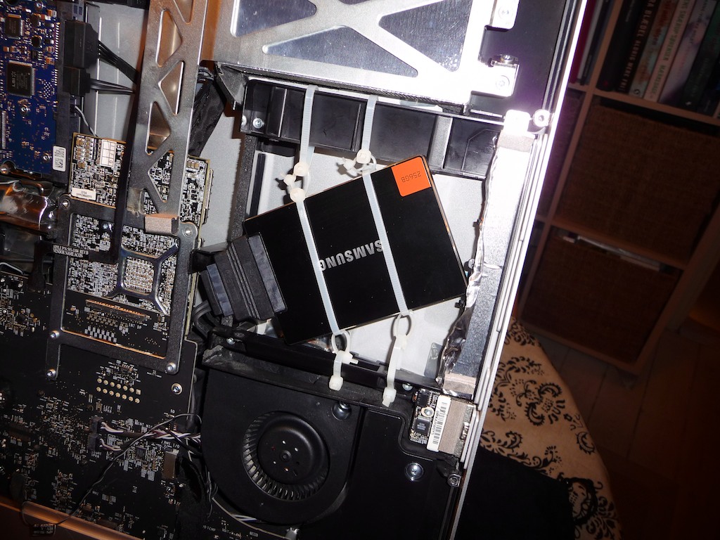

I have a Imac 27" i7 late 2009 (Model Identifier iMac11,1) and wanted to throw in a SSD drive (Crucial M4) to replace the optical drive.
The hard drive is still good so I thought I could use the SSD as the boot drive and the old internal as the secondary drive. Is there any advantage to physically putting the SSD drive in place of the original hard drive. Are the cable connectors the same for the HD & optical?
Any advice is appreciated!

Just created a fusion drive and everything runs fine and fast 🙂. I used a samsung 830 256GB ( disk0) in the optical bay, and the internal 2G ( disk1) in my iMac late 2009 i7 and used this guide :
http://www.petralli.net/2012/10/anal...nal-hard-disk/
Did a fresh install of 10.8.2 on the new drive and used migration assistant to migrate from my Supersuper clone of the "old" disk (800 GB 🙂 )
Worked like a charm 🙂
No need to buy a fancy caddy etc. Just get an adapter to connect the SSD and use the case from the optical drive. I used plastic strips and the SSD sits rock solid. (see picture)
this is the adapter you need :
http://www.av-cables.dk/sata-stroem-adapter/stroemadapter-22pin-sata-til-13pin-slimline-sata.html
Enjoy

haha .. you may want to cover or block the disk slot ... if someone sticks a disk in there, you will have to disassemble the iMac to get it out. 🙂
