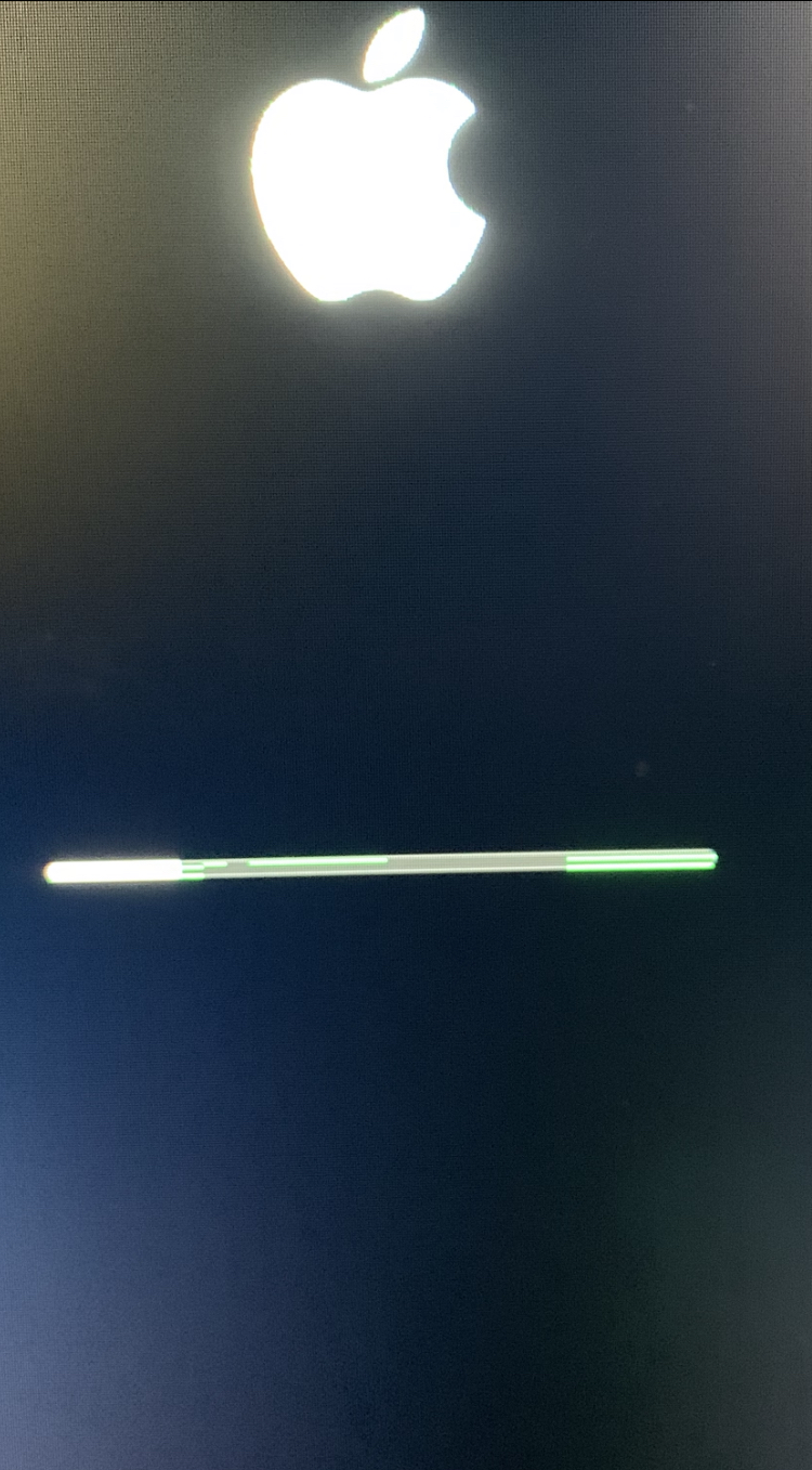

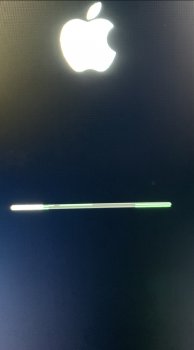

Hello,

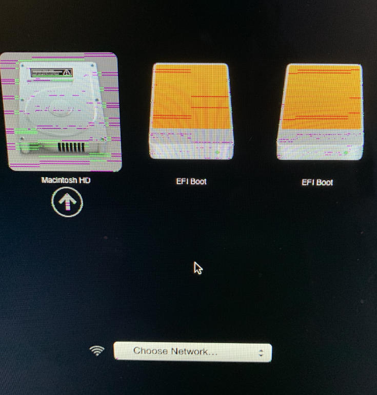

Please, help me diagnose this problem with iMac 27” (late 2013; NVIDIA GTX 775 XM). iMac stucks during the startup:
- OS doesn’t load. Loading bar stucks in the middle or so.
- What’s more, loading bar is distorted, with green artifacts.
- All those known startup shortcuts don’t work (verbose mode, recovery, single user etc.)
- Works only single user verbose mode, but frankly saying I don’t know what can I do here.
- As usual, hardware test says everything is OK.
- I have bootable backup on external drive, but it doesn’t load, it stucks same as internal drive.

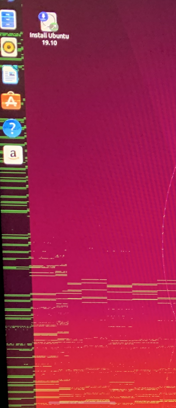

- iMac starts under Ubuntu in safe graphics mode, but GUI is distorted (again, green lines everywhere).
- I can use iMac as target drive.
Is my GPU failing? Has anybody else had this problem?

It sure looks like a failing GPU and all the symptoms you describe also indicate that it's a GPU problem. A late 2013 27" iMac has its GPU on a separate card but it's very difficult to get at it. You can google for various fixes. Also take a look at the replacement procedure on ifixit. www.ifixit.com
