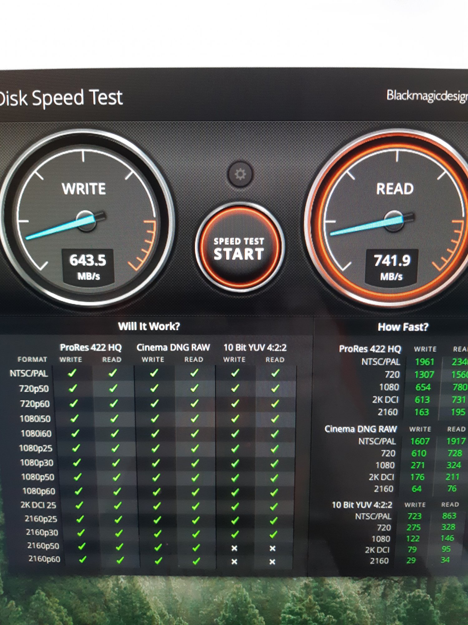

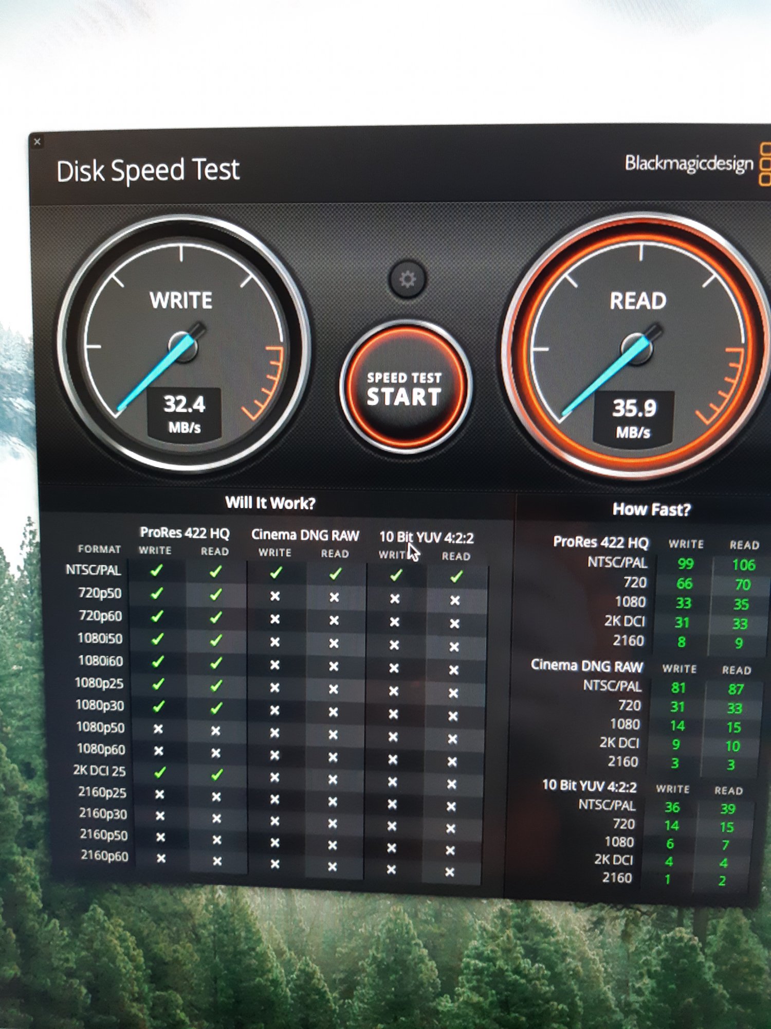

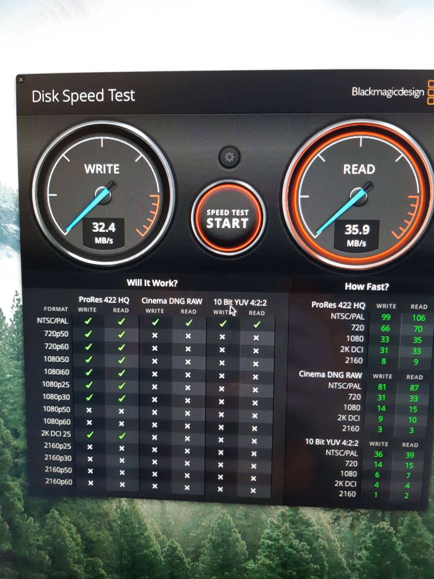

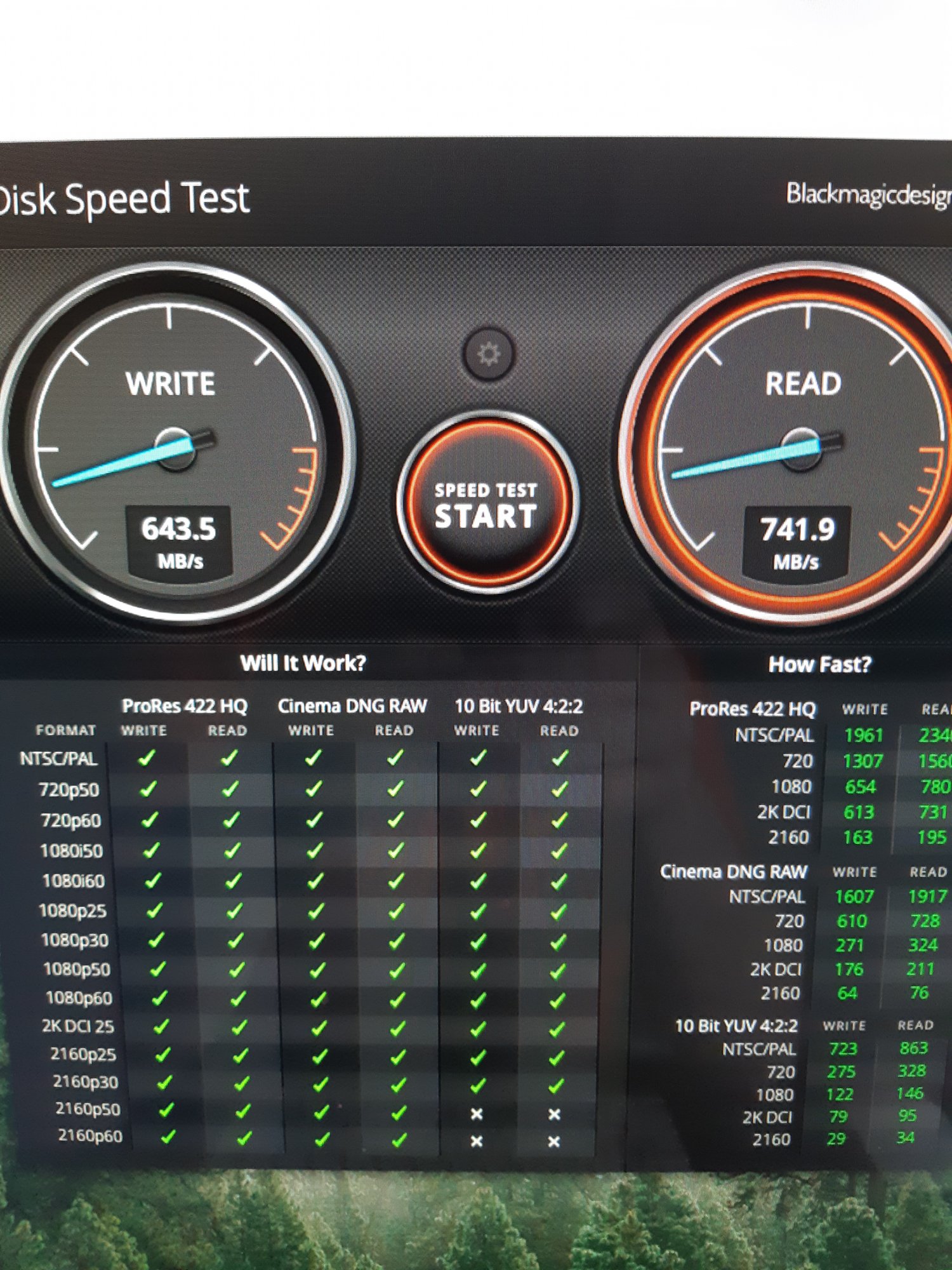

I just completed an upgrade on my late 2013 IMAC. I bought the 1TB PCIE from OWC (Aura X2) and kept my old HD for storage purposes. I followed OWC's directions (video) to the tee and it was super easy. Took me about 1 1/2 hours because I was taking my time. Using OWC's upgrade kit and had no problem at all with any of it. I recommend that you take your time getting all the old adhesive off using "Goo Gone" .... works fantastic. Then clean all surfaces with rubbing alcohol before reapplying the new adhesive. Well I have to tell you that the results are UNBELIEVABLY FAST. Using the app BlackMagic, I was able to increase my read speed 22X. Here are the before and after results. Honestly, no one should be afraid of doing this upgrade if you take your time.
