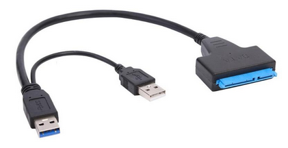

I have a USB SATA but the problem is how to get external 12V connected. I have no intention of using this disk on permanent basis but there are som files on the disk that I need to copy
That piece of hardware is designed to use on normal 2.5in HDD or SSD, which only use 5V power.
Buy a real 3.5in USB enclosure with independent 12V adaptor, it's just several bucks.

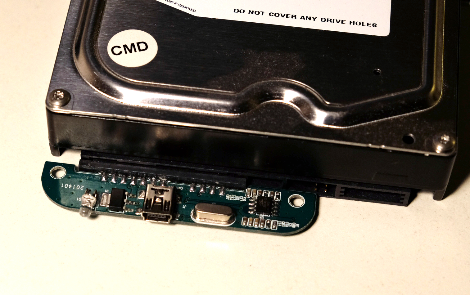

The drive that you posted a pic of in reply 13 above...
Is that "circuit board" we see at the bottom just "plugged into" a socket on the drive itself?
If so, can you remove it?
If so, remove it and THEN take a new pic, and show us what's there.
It looks to me like a SATA drive that has some kind of custom-designed attachment board.
But if it's NOT removable, it WILL NOT WORK with any standard "SATA" enclosure nor will it work with USB3/SATA docking stations.
Yes it can be removed. It's a SATA USB device

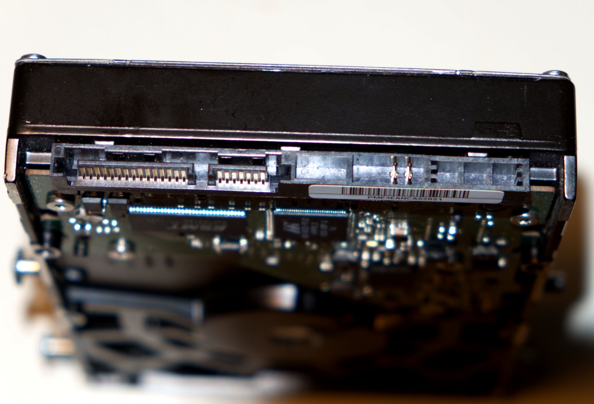

"Yes it can be removed. It's a SATA USB device"
Then get a USB3/SATA "docking station".
DON'T get the 2-bay version.
Get a 1-bay version. That's all you need.
