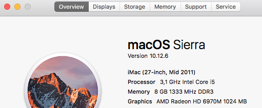

Hy folks!
Since a month or two my iMac 27 (3,1 GHz Intel i5) is bugging more and more.
After a nights rest during startup it needs to reboot a couple of times before getting to work. Normally it fires up normally and during the first couple of minutes it suddenly goes dead, several times.
Occasionally it goes dead as well after having been working properly for hours.
I suspected the HD so I did a clean install last Friday but the problem persist......
Disk utility says everything ok. Apple hardware test (extended) showed no errors...
How can I figure out where the problem comes from?

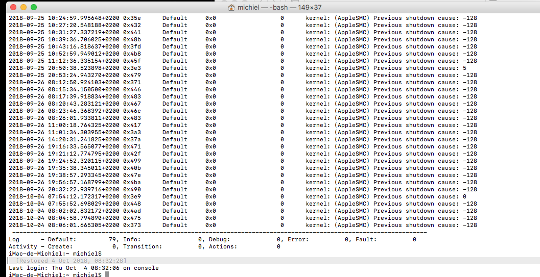

Well, you could try looking through Console for the shutdown cause. Should be under system.log, search for 'shutdown.' Not sure how informative thats going to be though. Alternatively... hmm.
Ok, try opening terminal and running:
log show --predicate 'eventMessage contains "shutdown cause"'
A previous shutdown cause of '5' was normal user initiated, '3' was a forced-restart/shutdown, '0' was a power interruption, and a negative number indicates a fault. When I tested that it took a few minutes to parse the logs.
https://eclecticlight.co/2017/02/28/mac-shutdown-and-sleep-cause-codes/
Ok, thanks so far. I did the terminal thing and get the "128" warning so a Kernel panic. That's way to vague to solve the problem for me. But anyway I'm informed that it is not hardware related.
