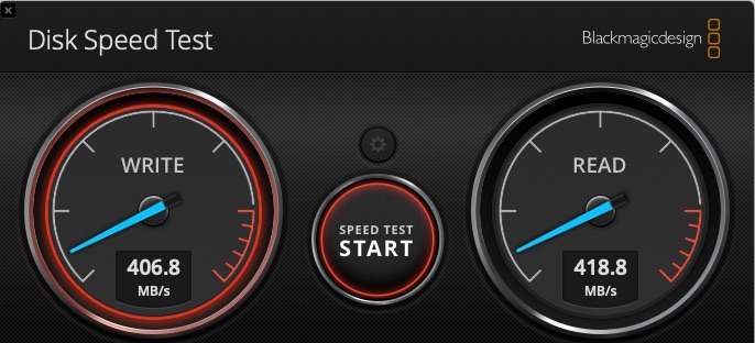

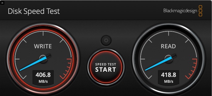

2013 iMac USB attached 1TB Samsung T5
And yes we boot and run from this external USB SSD, which is infinity faster than the busted 1TB internal spinner. The T5 sits nicely between the stand and screen on a Kleenex box which also keeps the screen roughly vertical since the stand hinge is also broken 🙂
