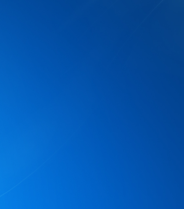

i have installed Catalyst Driver 09.12 woth the tool from hardwareheaven.com and after i found out the screen looks terrible wrong if i uninstall the Ati driver the screeen looks ok. but the drivers crash and the yellow dots coming on the screen.
and the only solution i found is go lower the the native reseloution.
any having the same issues
sorry my english i'm from Denmark🙂

i have allready installed Windows, but i think it the problem is the Ati drivers, the gradient on the screen looks teriible with the ati drivers on det desktop and viewing pictures, but not when i'm watching movies and play games.

The iMacs have an issue with the color on the screen. It seems they have a yellow tint issue which makes the colors in certain areas vary. The iMac section of macrumors is filled with people having this issue. I don't think it's the ATI driver.
No, I just installed these drivers too and there is a gradient on the screen, as if I'm in 16 bit color and not 32 bit.
I have installed Win 7 64 bit on my i7 iMac as well and installed the modded "ATI Catalyst 9.12 Suite for Windows 7 (64 bit)". I have the same issue that, though games run much smoother, the colors seem to be 16 bit instead of the displayed 32 bit. Is there any way to solve this? I had to go back to the old Win 7 ATI driver, because I like full color ;-)
