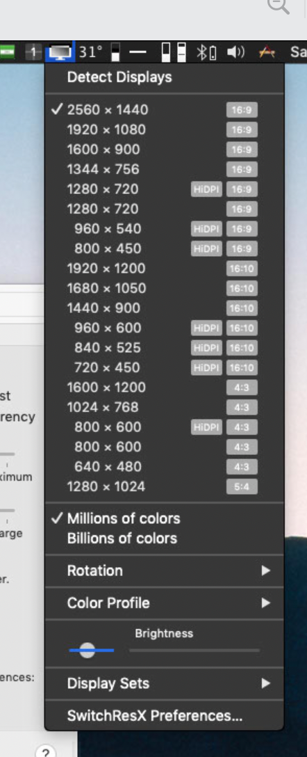

- The weird colors problem
What I've found is that this is a result of the color depth used by macos.
By default it's on billions of colors and this is what results in the orange / bad colors.
What I've done is using a tool like SwitchResX ( in my case I have a license but using it in trial mode will also work ) if you look
at the menu in the status bar at the bottom you have the possibility to select the color depth, just change it to millions and everything
gets the right color
This might not be a "solution" if you need some color accuracy like for photo / design work but for everything else I've not noticed
any difference.
For me this is a 100% fix I hope this helps others.

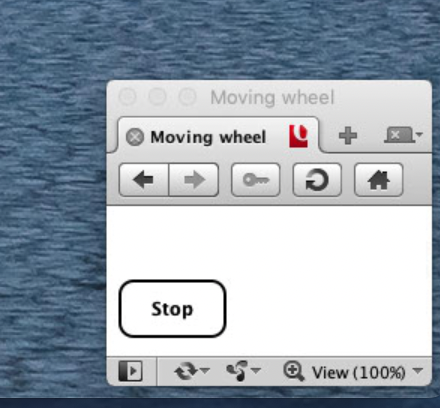

For this I found a crazy workaround which is to have opera browser ( one of the last versions before the change of the opera engine ),
I'm using 10.63 which runs fine in Mojave and the browser itself does not suffer from the graphics weirdness ( I think it must use different graphics libraries which are not accelerated by the gpu ).
In Opera I just create a very small window size and open a local page I've created from some looking around the net.
This page basically runs a javascript function which I've tried to adjust to use the smallest amount of CPU possible ( not 0 I'm afraid but low
enough ).
This function keeps drawing in a loop a box moving from left to right, the box is white on a white background so we don't see it but
the SO has to draw the changes anyway so it forces display refreshes, etc and this makes all other windows "behave" normally and
the graphics weirdness is almost completely removed.
It's not 100% fluid but much better, some apps are perfect other as long as their window is not too big are perfect also the rest
I think are 90% there ( they really look like a normal window moving 😀 ).
Just make Opera start at login.
Adjust it's position to be in the bottom right corner for example and make it show in every space. After logging
in just click the start button.
The code is at the end of this post.

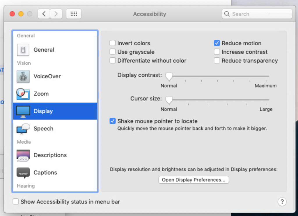

- General UI effects
For this you can activate "Reduce Motion" in System Preferences / Accessibility / Display.
This helps but things are not completely smooth.
You can also change the "Minimize" effect to "Scale" that works much better.
( 20260216 edit ) - I think activating Reduce Transparency also helps ( I'm not 100% sure on this on it
may be just in a very small number of situations )

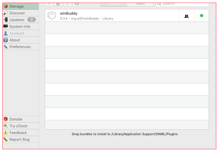

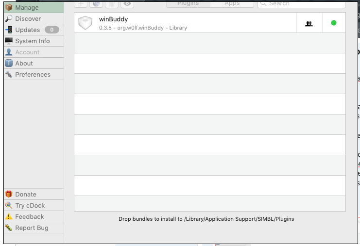

The solution for me is to use a free software developed by w0lfschild callled mySIMBL that
is available on github at
Note: mySIMBL requires that SIP is disabled so this may not be a solution for everyone.
Note 2: mySIMBL also only works for 64bit cocoa apps
mySIMBL is the continuation of SIMBL / EasySIMBL and is a software that allows someone to develop plugins
to add / change the way macos apps work on the fly.
mySIMBL as I said is opensource and has a "repository" of plugins than can be installed directly from the app.
Plugins can also be added manually if not on the repository or are new.
All of the plugins are opensource and the source code is available on github for anyone to modify/enhance if
wanted.
Knowledge of programming with Xcode is a requirement of course.

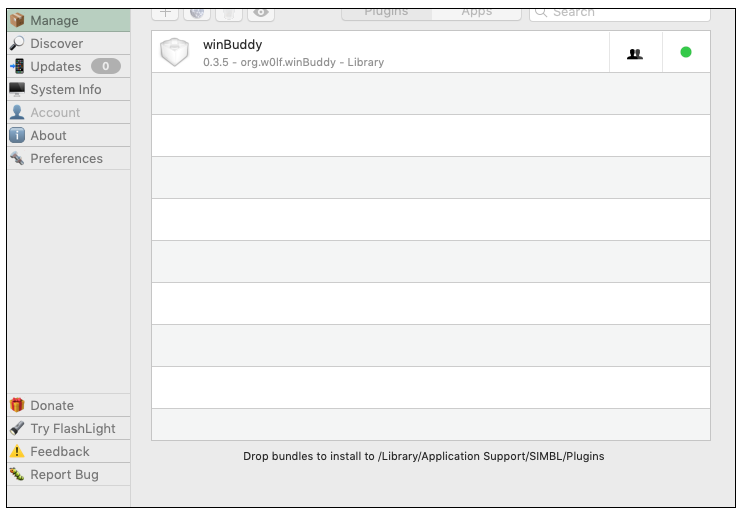

There is one plugin developed by w0lfschild that I found extremely interesting to use as a solution for the
graphics performance issues which is winBuddy.

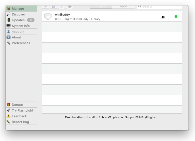

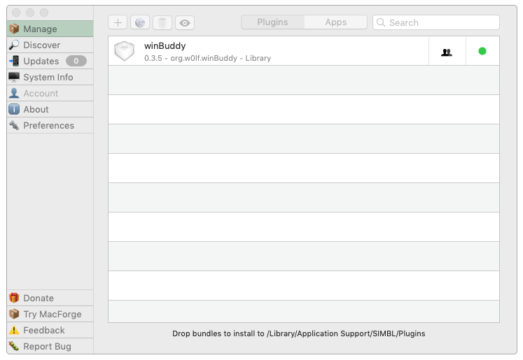

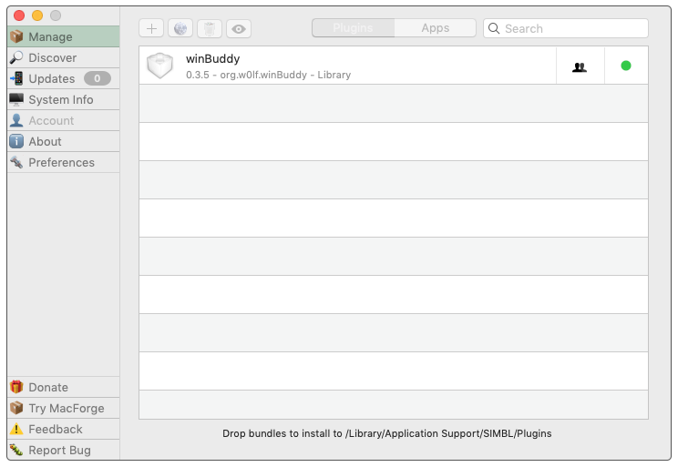

After activating winBuddy all apps have their shadow disabled and a square border drawn around each window
and all the graphics corruption on windows is removed ( see below ).
winBuddy ( standard )
As you can see the red and the black border and no shadows versus the same windows with a shadow.
winBuddy also allows configuration on a per app basis through a menu added to the application being used.
As you can see this allows you to "adjust" some other properties besides the window border and the shadow.
These setting are persistent on app close and are reapplied when opening the app again.
As I said out-of-the-box this is a solution for the graphics corruption issues but I wanted more so I downloaded
the source code and started adding more stuff.
winBuddy ( my version )
I replaced the borders with black / dark gray and gray ones and also added rounded corners to the windows.
I also added some other features ( I'm still working on some of them ).
You can see the changes on the new winBuddy menu
So the new features are for the window resize and move actions that also present graphics and performance issues
on these systems.
I'm posting the plugin executable for anyone that wants to try it and will post new versions when released.

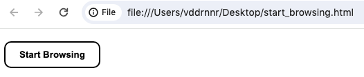

Firefox and Chromium
After running the browser it seems nothing works very well ( clicks do no action ).
To fix this in both you have to change the startup page to a local html file in your Desktop for example.
This file has the following code
HTML:
<html lang="en">
<head>
    <meta charset="UTF-8">
    <title>Moving wheel</title>
    <style>
    #wheel{
        height:22px;
        width:22px;
        border-radius: 12px;
        border: 2px solid white;
        background:#fff;
    #line1{
        width:5px;
        height:20px;
        background:white;
        margin-left:48px;
    #line2{
        width:20px;
        height:5px;
        background:white;
        margin-top:-53px;
    #line3{
        height:5px;
        width:175px;
        background:iblack;
    #start-btn{
        padding: 10px 20px;
        margin-top:10px;
        color:#000;
        background-color:#fff;
        border:2px solid black;
        border-radius:10px;
        font-weight:900;
    #start-btn:hover{
        background-color:#eee;
   </style>
</head>
<body>
    <button id="start-btn" onclick="window.open('https://html.duckduckgo.com','_blank');window.close('','_parent','');">Start Browsing</button>

When opening this will show on your startup page ( example using Chromium )
Just press the "Start Browsing" button and a new tab will open and the initial one is automatically closed
and then you can browse without problems.
Note: this fix is not 100% on Firefox, sometimes after browsing for a while the refresh button on the quit menu
option / shortcut can stop working.
I'm trying to find why this happens.
As a workaround for refresh you can just go to the url box and press enter to refresh the page.
