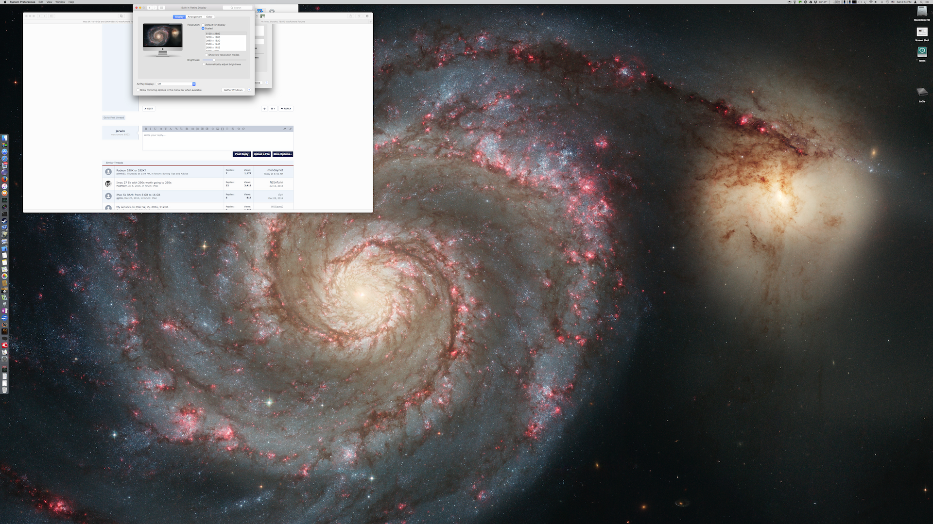

Regarding the max settable display resolution in OSX, does it do the scaling thing like the rMBP does (where the highest desktop res is still less than native) or can you actually set native resolution? How does this work?
Hold the option key down while selecting the "scaled" radio button. Apparently this is quite useful when trying to force certain games into 5k mode. Otherwise, it's too small for comfort.
Thoughts: running the i7 4.0 ghz machine with 24 gigabytes of ram. CPU has been up almost 15 days now and am running 24 gigabytes of ram on this unit, my memory pressure is 11%.
I'm running the 290x (I wanted the 295 but I could either have the i5 and the 295 or the i7 and the 290x and I NEED the i7 for some of the critical apps I use). Gaming wise I am able to run X-Plane 10 at 5k and run Elite Dangerous smoothly at 4k (I've run it at 5k and it still plays fine just not quite as smoothly). This is under Mac OS X.
Any other questions? It geekbenches well over 15,000 if those numbers mean anything - close to 16,000 actually (I'm just running the 32-bit version so it likely benches over 16k in the 64-bit edition).
