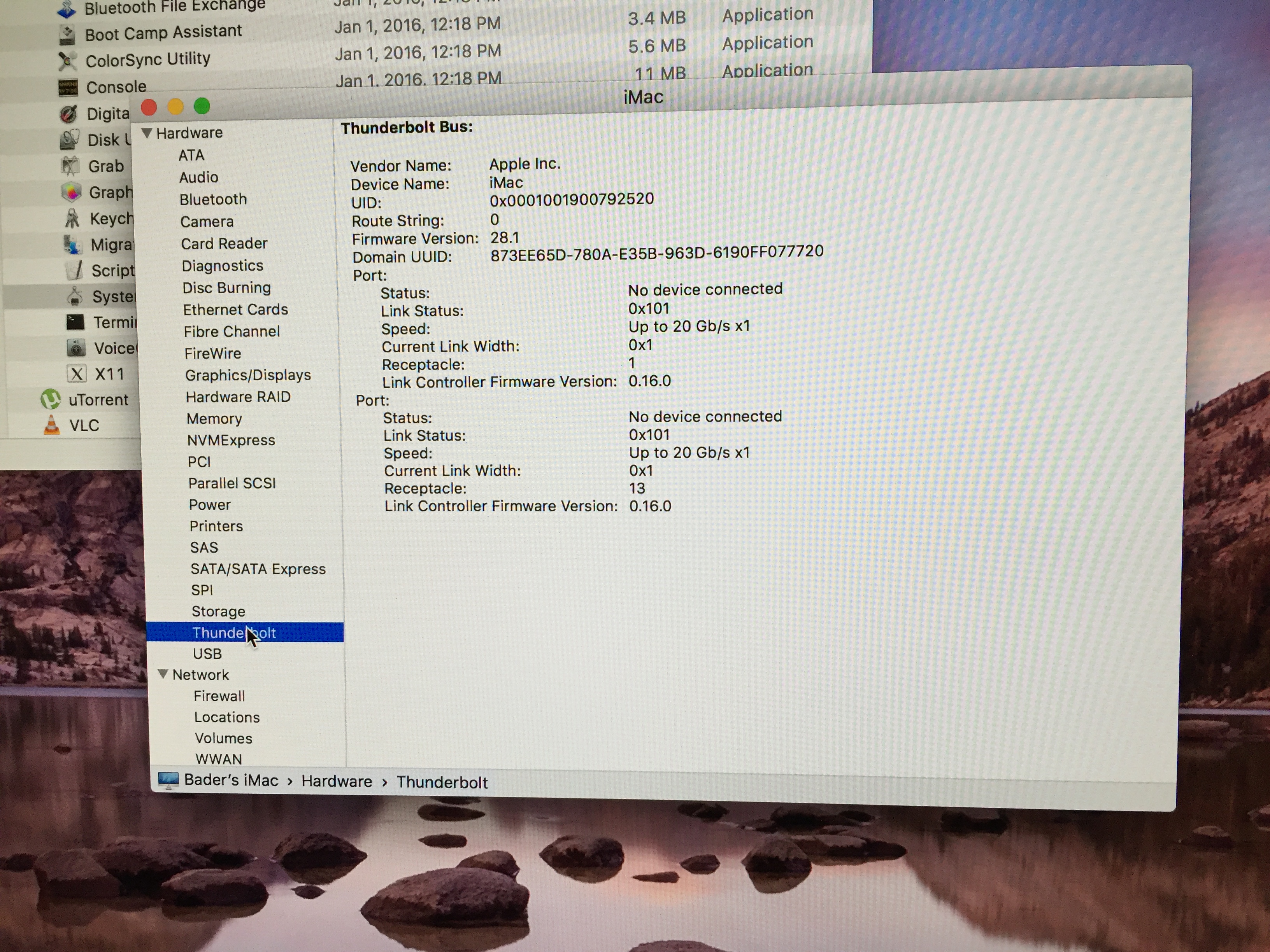

What else have you tried? That might help me and others get an idea of what it might be. Also, is both Thunderbolt ports recognized in the System Report?
How could I double check the Thunderbolt ports in the System Report?

What Samuelsan2001 said is probably a better solution. But if you want to find it you go into About This Mac -> System Report and then in the left hand side there is a tab called Thunderbolt.

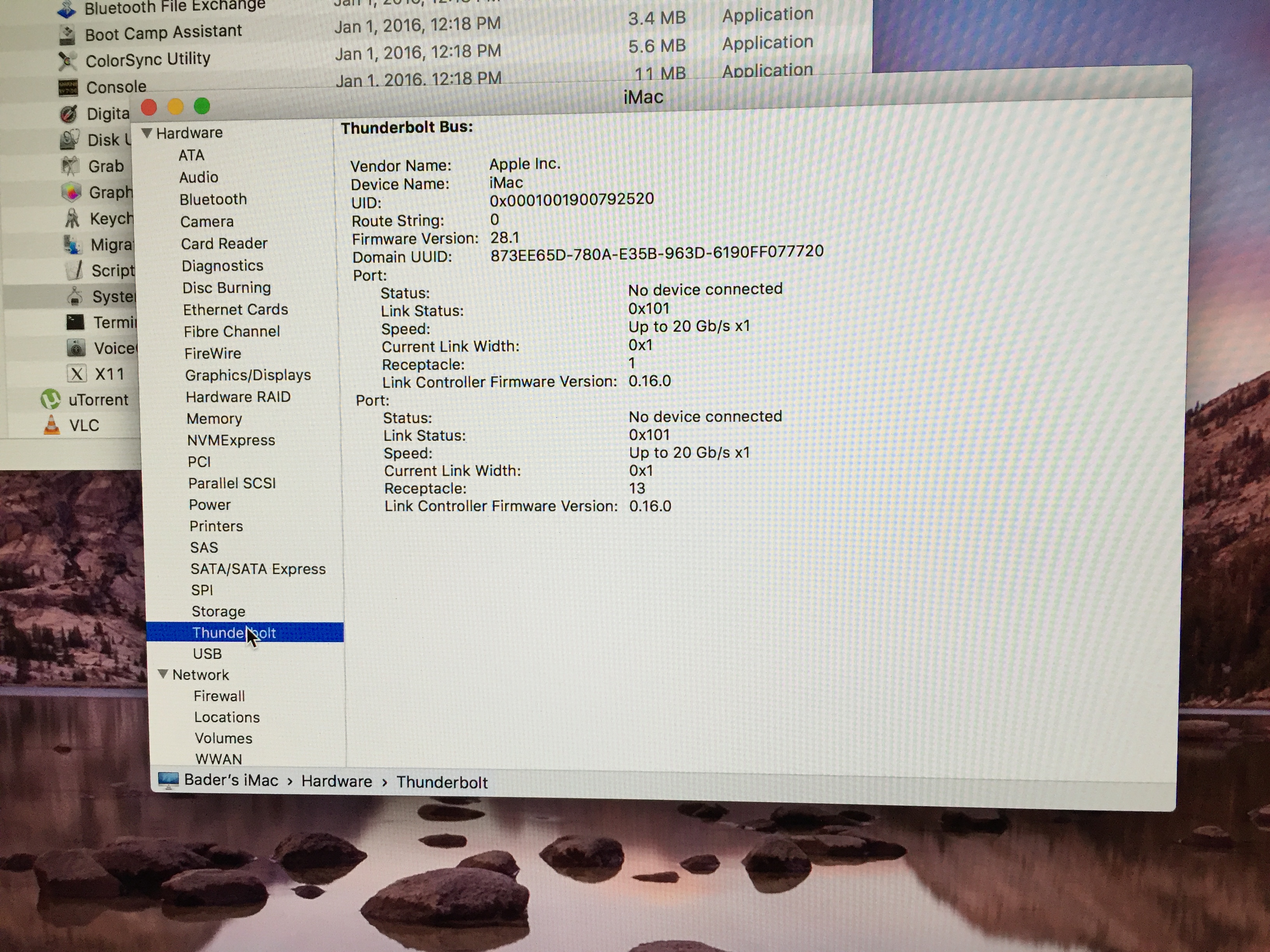

I checked the System Information, it seems that the port is fine, a screen photo is attached!
Keep in mind that the Mini Display port was unplugged during the report!

It worked!
I conducted a PRAM reset and it worked!
