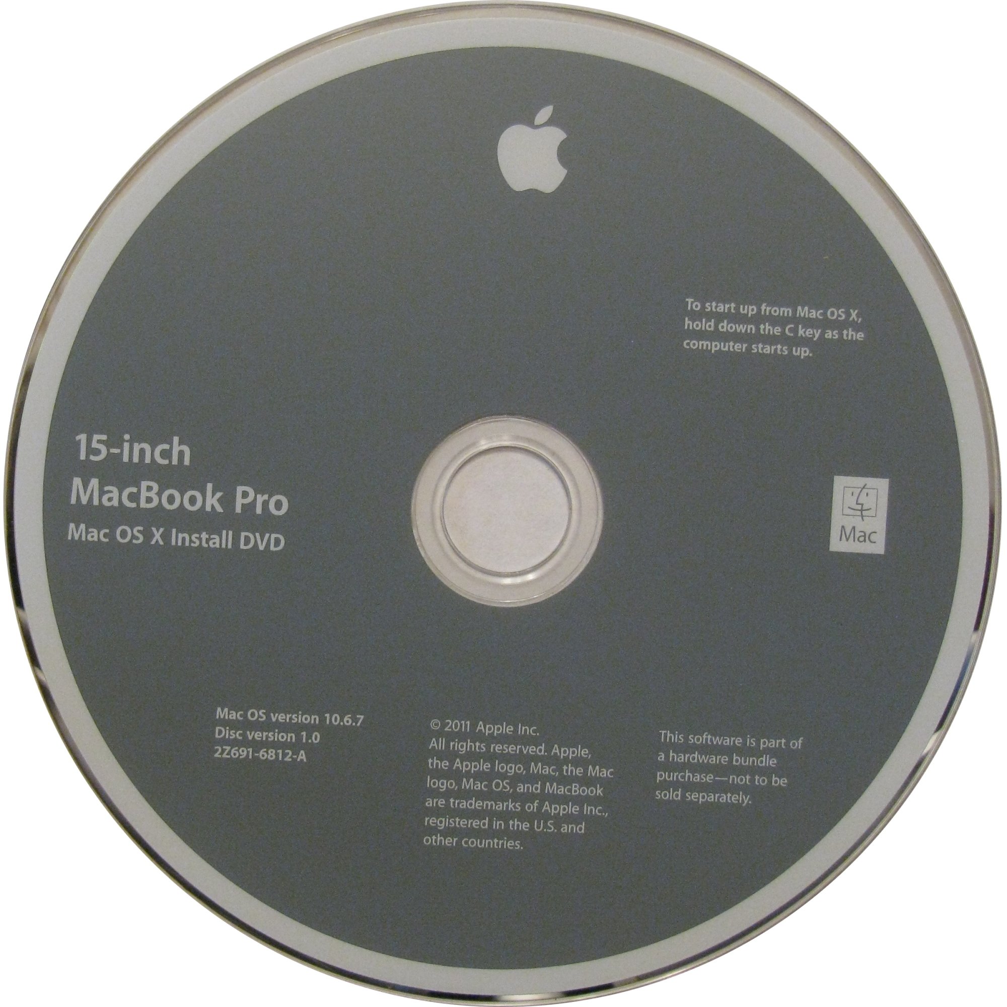

The Disk says 10.5.2. I posted my number if anyone would care to call and help me out. 504-422-2022
I would just about bet that you have the Gray Restore disk. It would look like this.
If that is the case, there are two things to consider:
1. It is hardware specific. It will only load properly on the exact hardware the disk is intended for. Hopefully this disk is from the iMac originally. The later 2007 units and 2008 models shipped with 10.5.2. That's a good sign.
2. There is almost no way that the last OS that the iMac had was 10.5.2. It was quickly updated after release and I would bet it isn't running anything less than 10.6 something.
This would mean you should use the disk, select Utilities from the top menu, and open Disk Utility. Use the app to select the internal hard drive (usually called Macintosh HD by default) and format it to completely erase it. You want to choose Mac OS Extended Journaled and make sure to select "Options" and choose GUID Partition Map.
Reactions: TheShortTimer
Ok so I formated then booted from that disk and it says this software cannot be installed on this computer.
