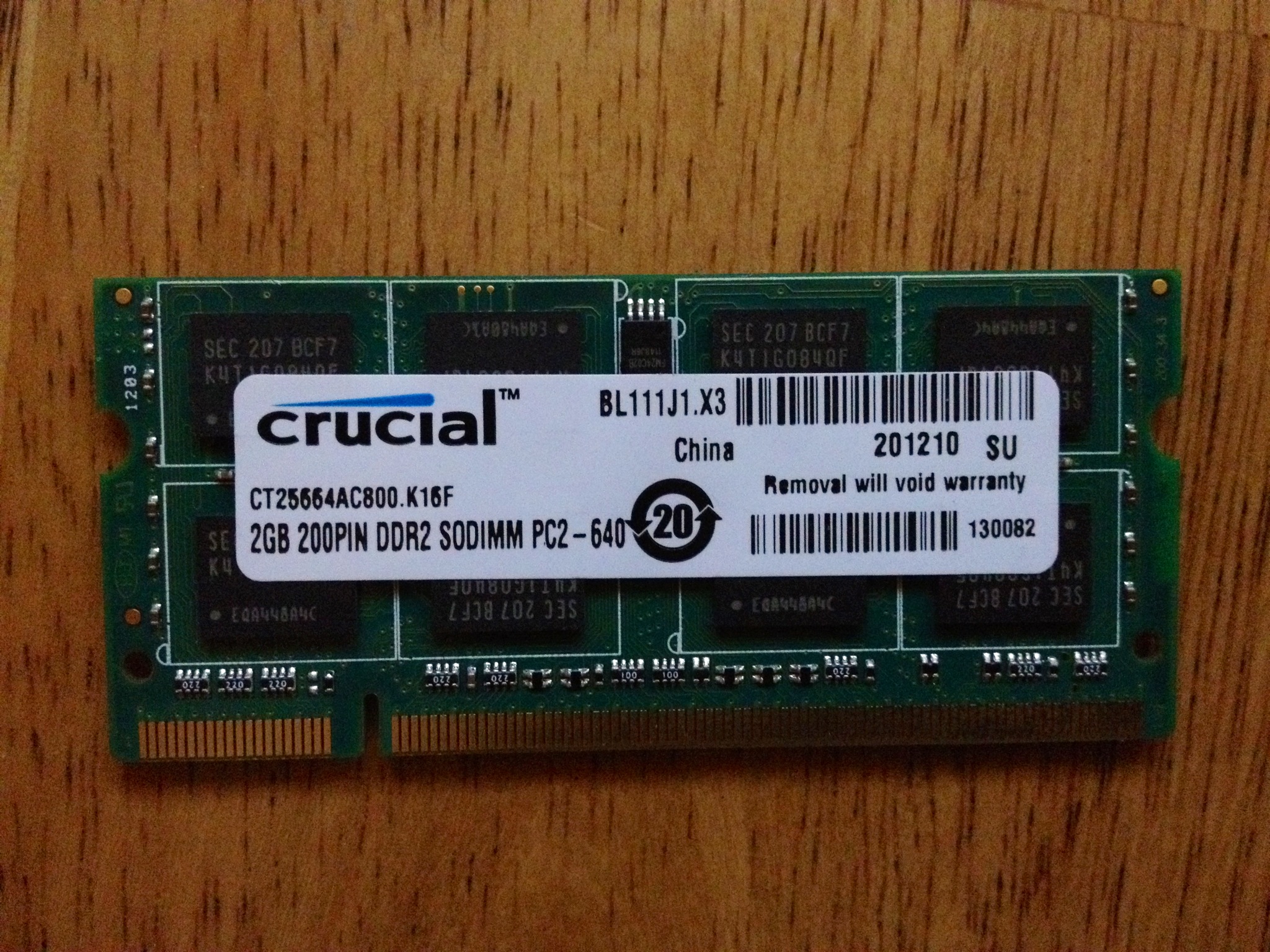

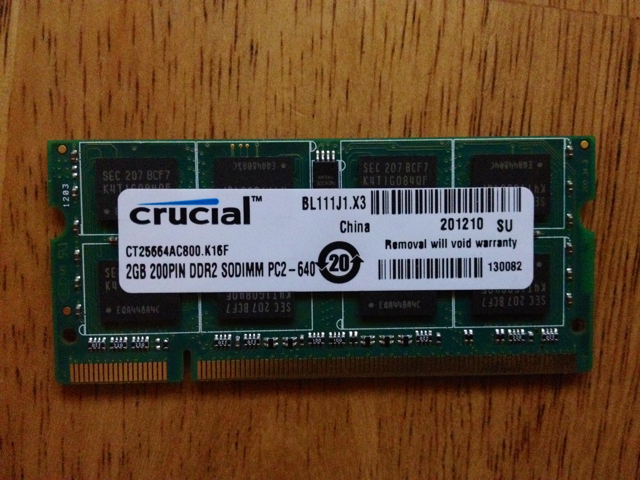

What are the exact specifications of the new RAM and exactly what brand and model is it? Please answer all questions.
here's a photo of the RAM let me know if you need anything else. thanks

^^^These 2GB sticks are PC2 6400. Exchange them to PC2 5300 (stock memory frequency for your model) and it will be OK. Analogical situation is in Mini 2010. Some Macs with some types of RAM just acting like this.
