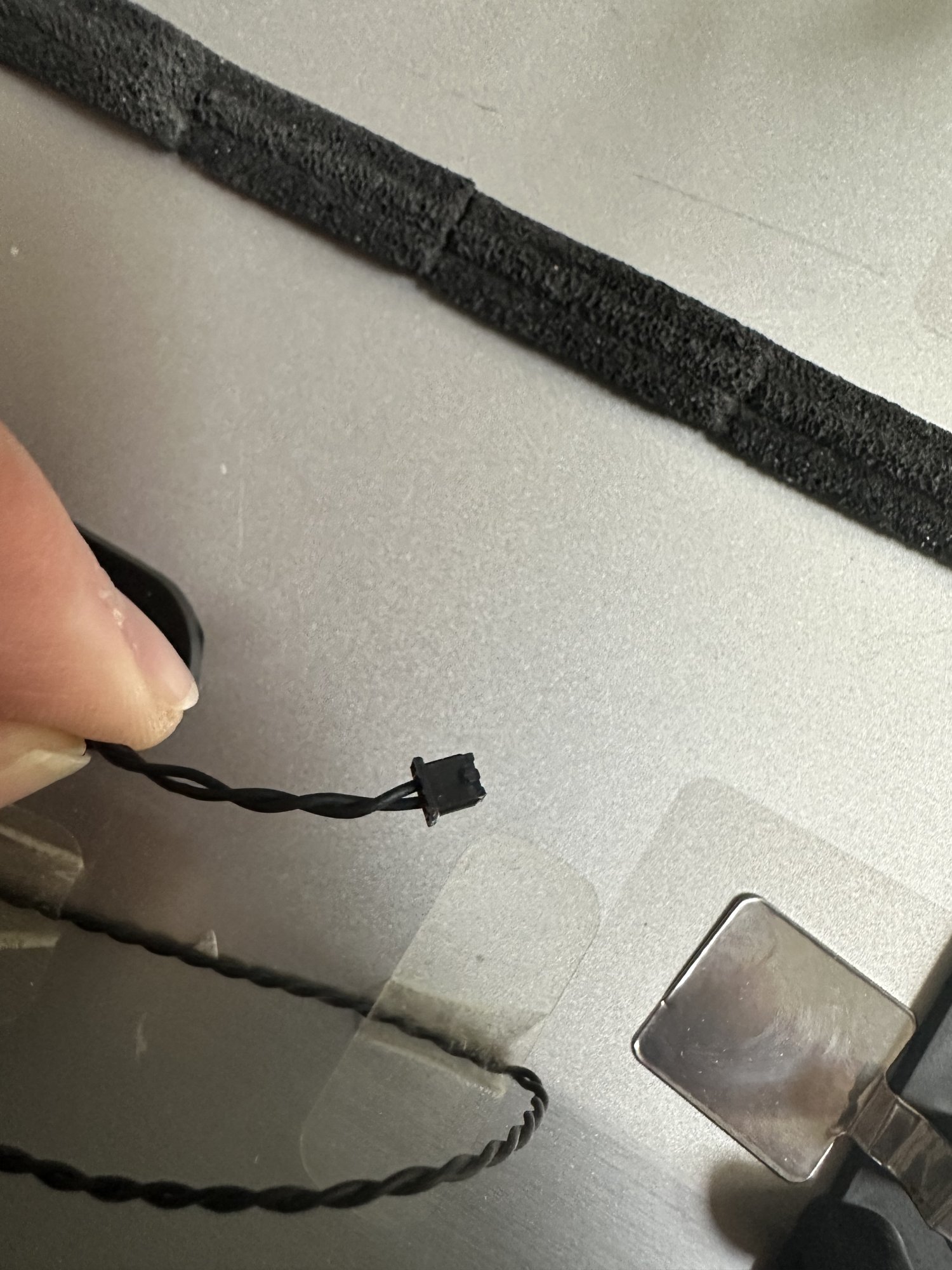

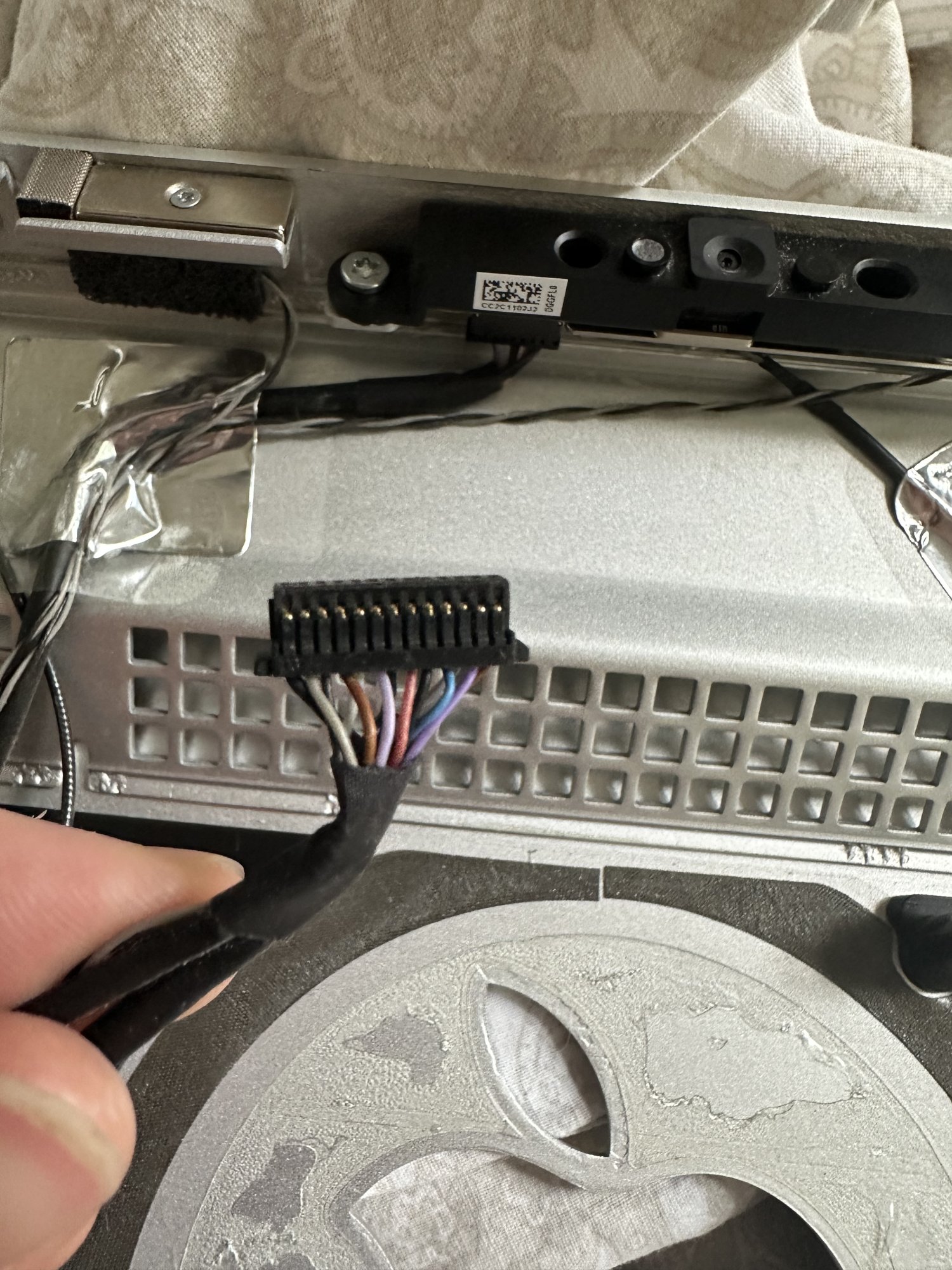

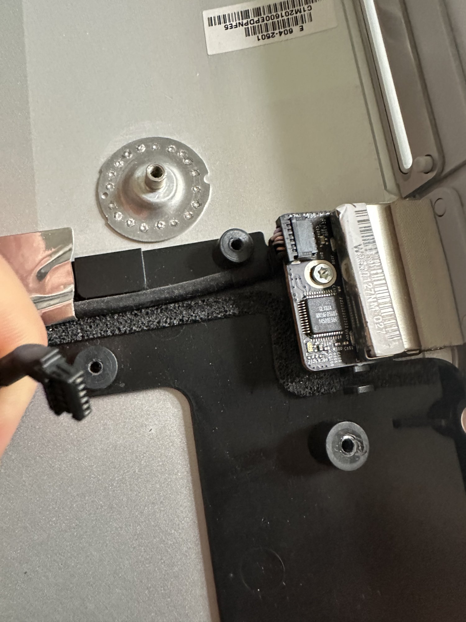

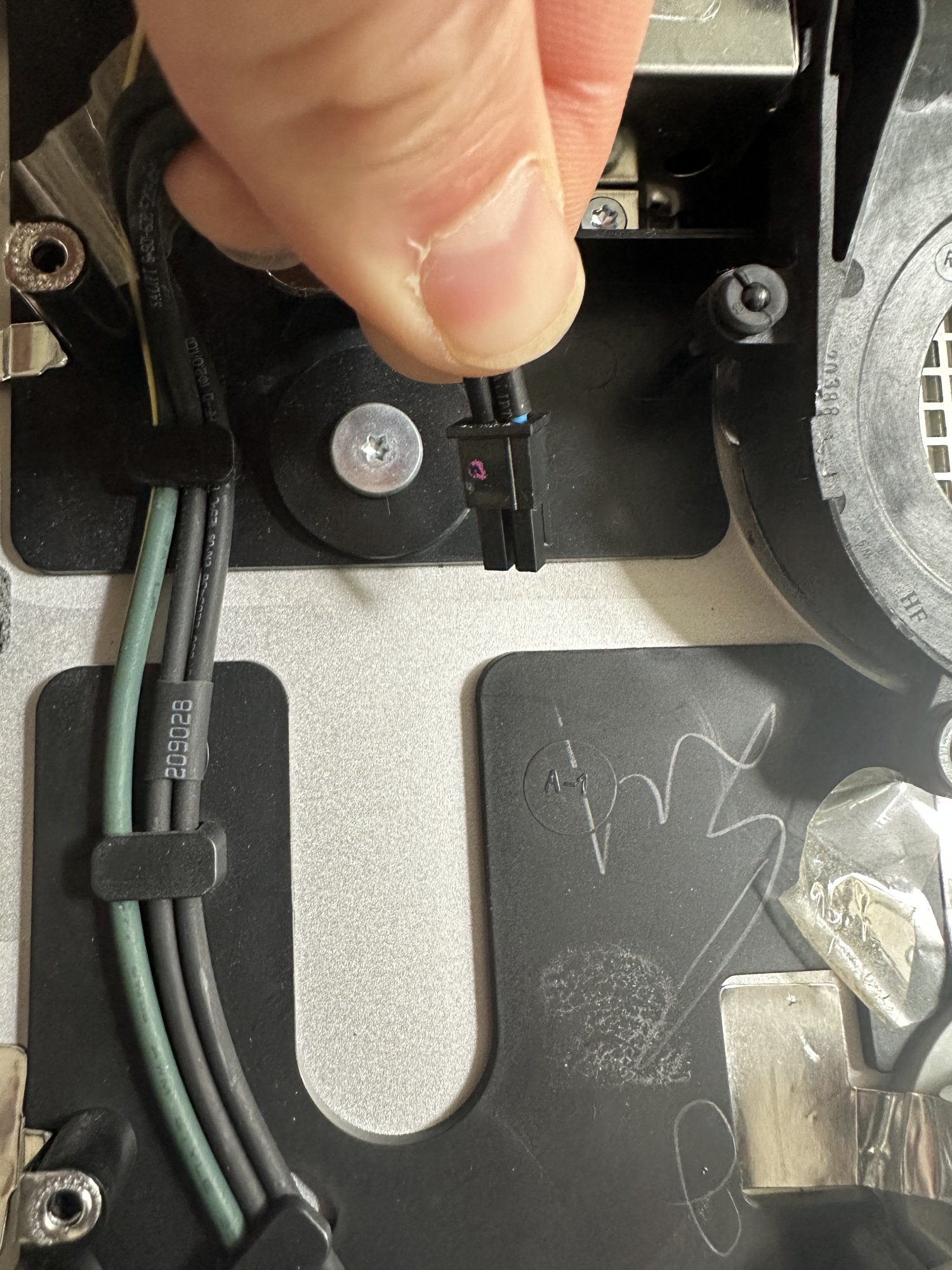

I’m working on a iMac conversion to standalone display. I have the board kit, usb module and want to connect all the different extras like camera, as card reader and so on. I want to build all the different usb cables for it to connect to the existing connectors on the camera and SuperDrive and so on. Does anyone know what these connectors are called and size?

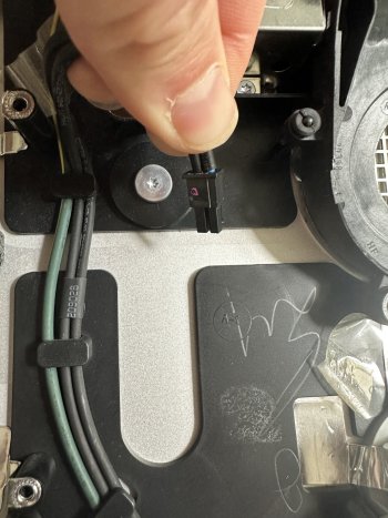

Power connector is 2 pin and 6mmx3mm, power button is 3x2mm. I have JST connectors but these seem too big. Any help is appreciated.

@wargeron
The problem is that you can’t buy these miniature sockets with wires already soldered on.
They only come as one-sided parts designed for attaching (with soldered pads) to a pcb.
You would need a microscope soldering station to work at this miniature size.
The power supply socket is a 2 pin Molex Micro-Fit 3 plug.
It is also used in A1418 21” iMacs, and the iMac Pro, both of which have sockets with wires attached.
The multicoloured wire 13 pin plug looks like a 13 pin Molex Pico-Lock 1.5mm pitch plug.
You can stick the pins of a JST ZH 1.5mm pcb socket into this plug to connect to it.

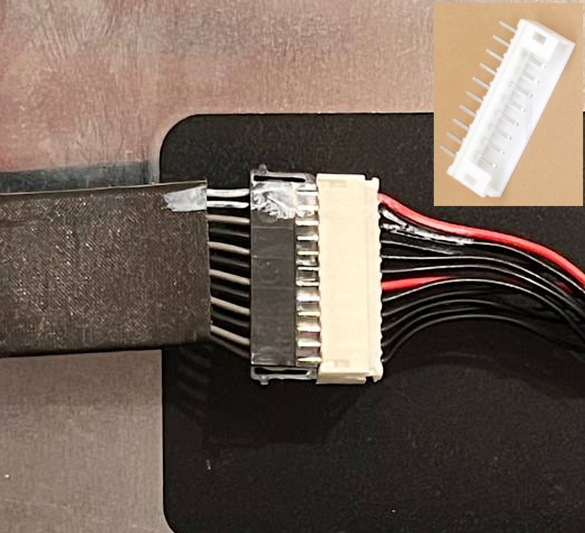

This pic is the DIY connection to an iMac backlight cable plug, using a JST ZH socket pushed into the iMac plug, and a 12 pin plug with wires connected to the socket:
The other smaller 1mm pitch plugs are so far unidentified as they don’t appear to be in the Molex catalogue.
There are alternatives with the same pitch, but not quite the right form factor to be a proper match.
The 1mm pitch equivalent is JST SH, which is sometimes known as STEMMA QT/Qwiic in Arduino catalogues.
