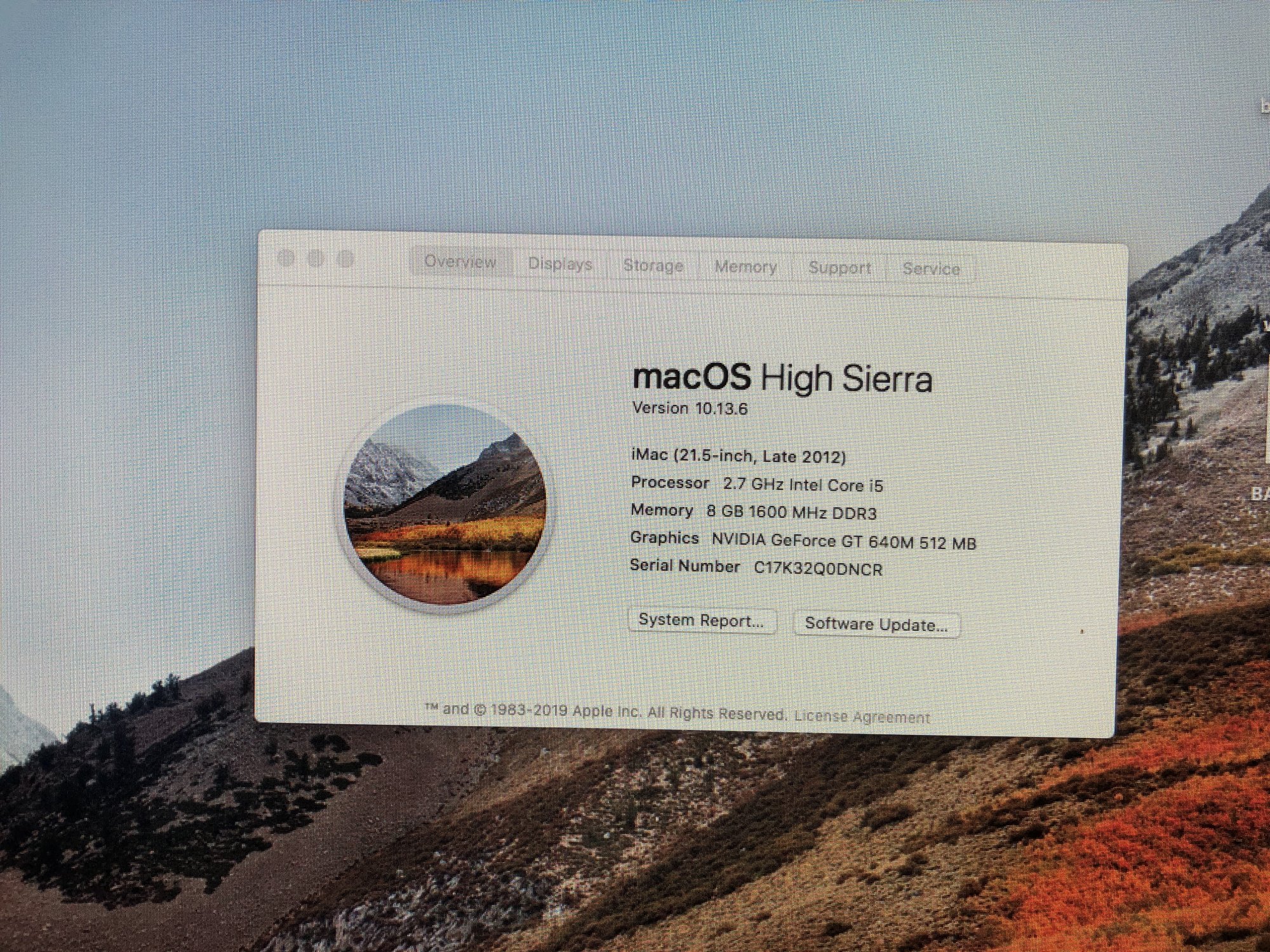

It's a 2012 imac.

Everymac.com indicates the most recent OS for the 2012 imac is 10.15 "Catalina".
I suggest that you install that -- NOT High Sierra.
