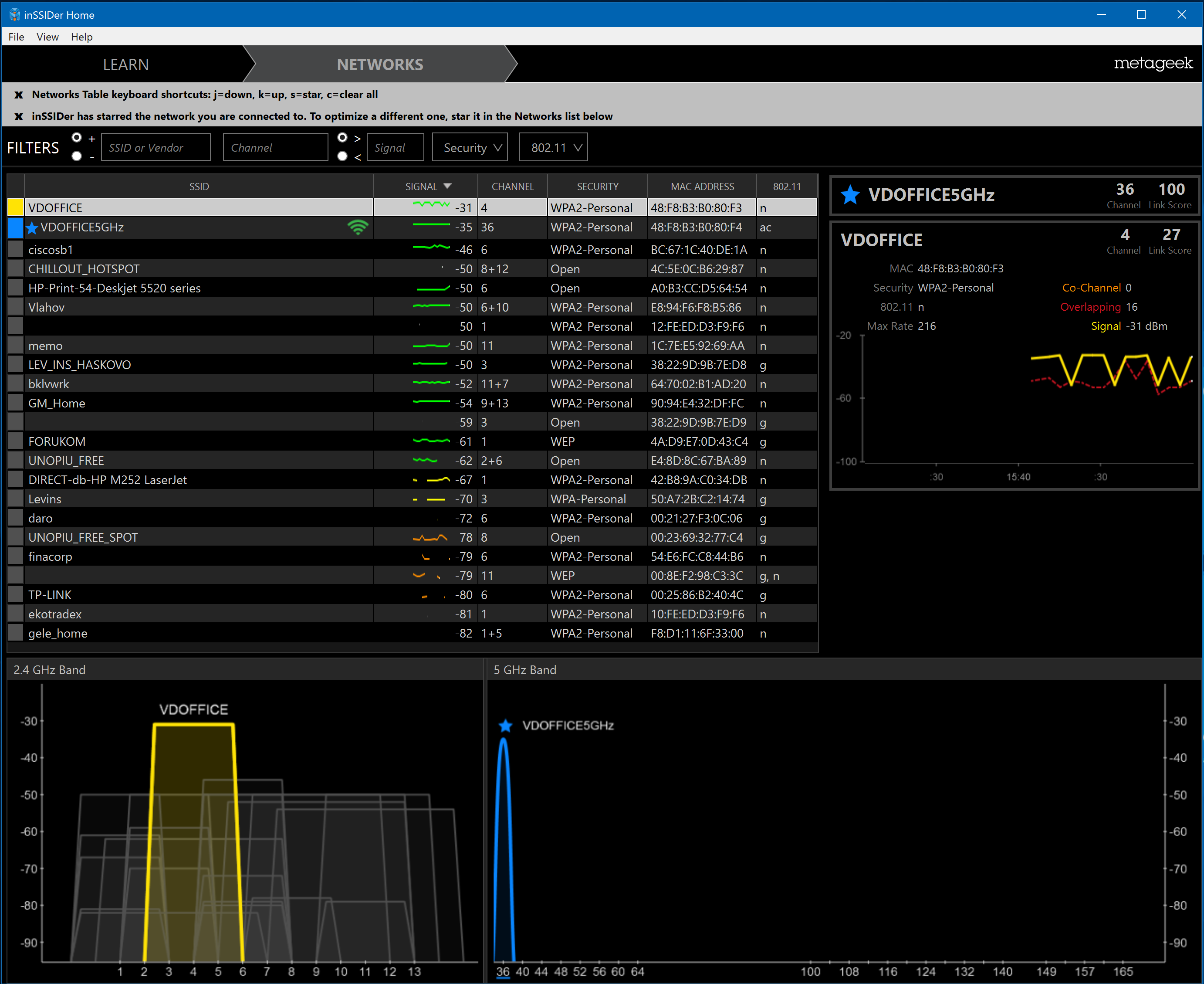

Have you tried using different channels to see if that helps your wifi?
The 2.4GHz band is useless, see attached image, my network is in yellow. On the 5GHz band I am the only network - any point playing with the channel?
Yes, because you may find something that works better. It also won't hurt you further if you try changing the 2GHz channel as well, i.e., you have nothing to lose but everything to gain.

Update on changing channels:
I changed the 5GHz to channel 48. In the last 1 and 1/2 hours, my TxRate has been from 1053 to 1300 Mbps and stable. This is promising.
I changed the 2.4GHz to channel 11, but this band is only for guests and other devices. We will see how this goes.
