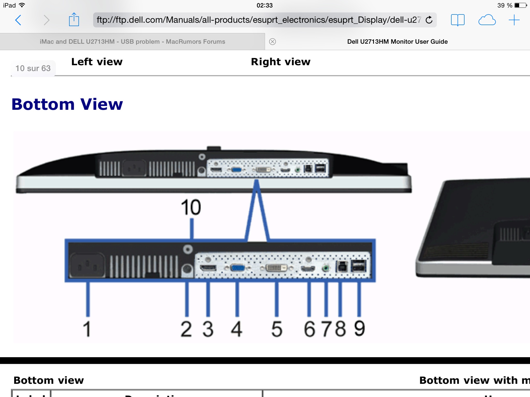

You can't expect USB to work if you don't connect it to your Mac.
And you are not going to lose one port by doing it, as USB in and USB out is not the same shape/connector.
The "USB in" is #8 in the attached picture. Displayport does not carry USB.
Edit: you fixed it while I was replying 🙂
