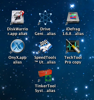

Hi andrew,
as davids says, you have to use commercial Utility app for fixing something like that.I use these utilities - you (and everybody else) should have at least one of these...:

Hi andrew,
