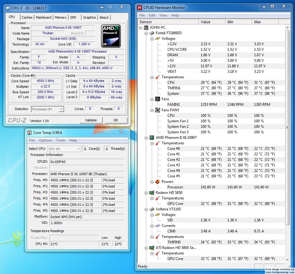

I have plenty of proof, I review remember? 😎
BTW, I'm not posting just to annoy you, I'm posting because everything you're saying is confusing people, your not stating facts, just hear say, in my opinion.
So, look at the pics and look at the maximum temperatures. x6 in the 30-40's, i5 in the mid to high 60's, and i7 in the mid to high 70's. Even though the Phenom heat sensors are off 10c (thats the current agreement from what ive seen), then lets say my x6 is really in the 40's to 50's. Even if that were 100% true, it still runs 10-15c cooler than an i5 750. So again, I'm right bout that.
Now, the i7 is in the 70's, same exact clock speed as the i5 750, and its still over 10C hotter. Now, I know the i5 was water cooled, but my water cooling loop cools the MOSFET's/VRM's, 5850 GPU, SouthBridge, and the CPU. So really, it only about 2-3c better than the i7 on air. So again, I'm right, and there's your proof. 🙂
