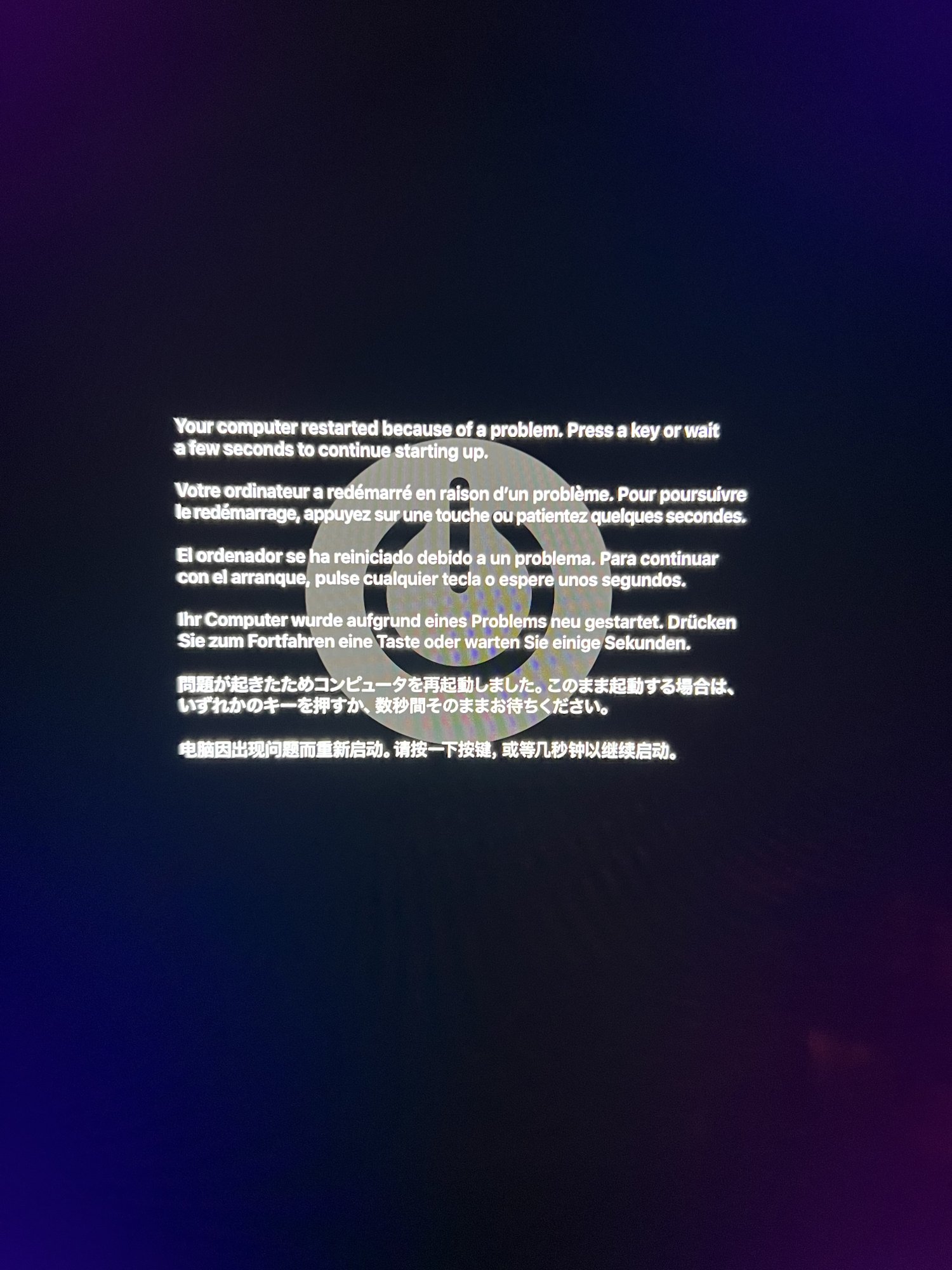

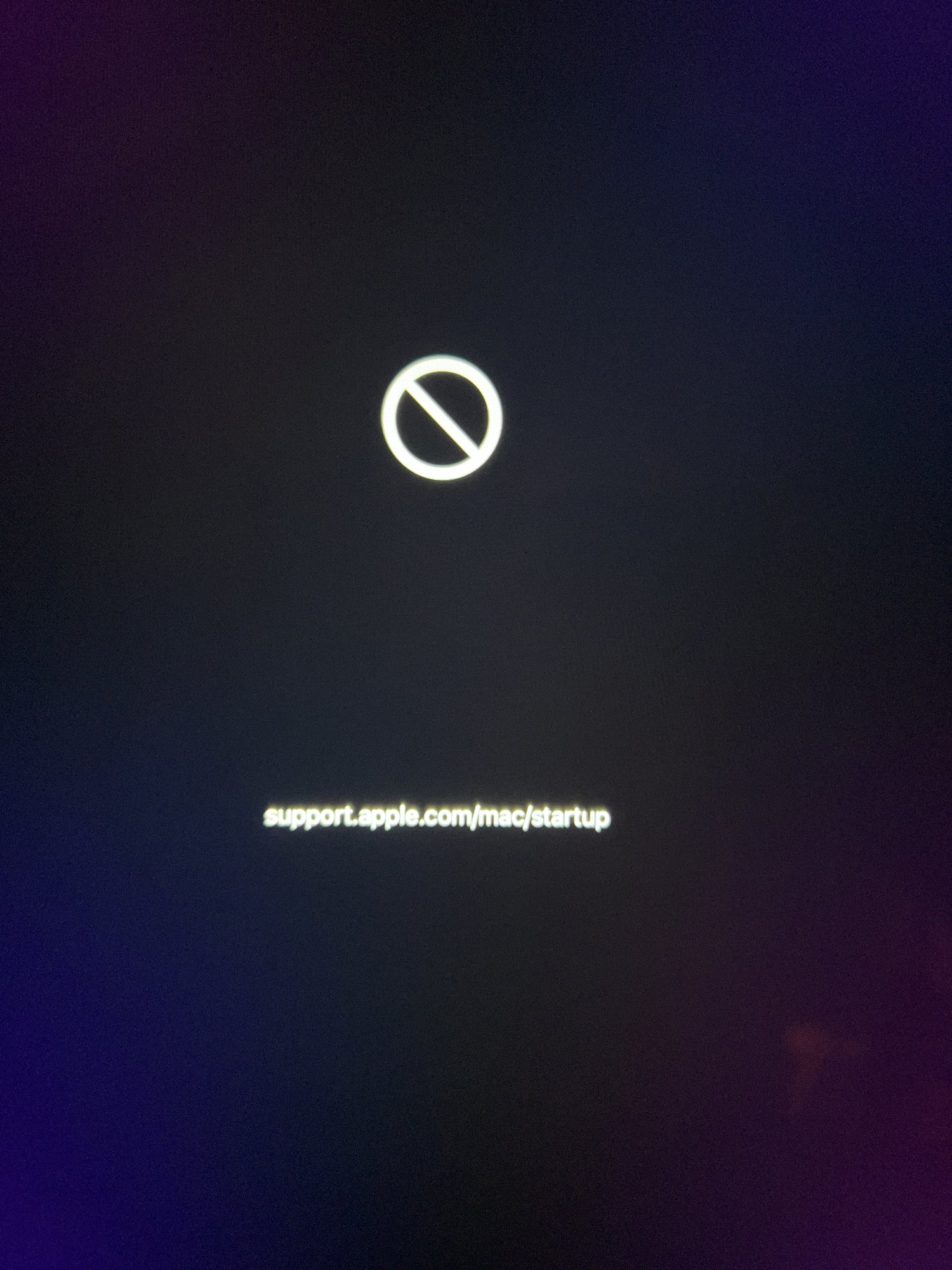

My Late 2014 iMac has been stuck in a boot loop. I keep getting the screen where it says "your computer restarted because of a problem press a key or wait a few seconds to starting up". I am also getting a screen that says "support.apple.com/mac/startup with a slash symbol. See the images below. I have reset the NVRAM and SMC. I have created a Mac OS Big Sur USB bootable drive. Whenever I boot into that, I can see the bootable drive. Upon selecting it, the computer attempts to reboot into it then goes right back to the error screen about my computer restarting because of a problem. I am also getting this same issue when attempting to load the internet recovery.
I did upgrade my hard drive from the fusion to a Samsung SSD a few years ago, so I don't have the recovery partition anymore. I'm somewhat at a loss of how I can fix this iMac. No internet recovery, no usb bootable installer working, no recovery partition. I am stuck in this boot loop.

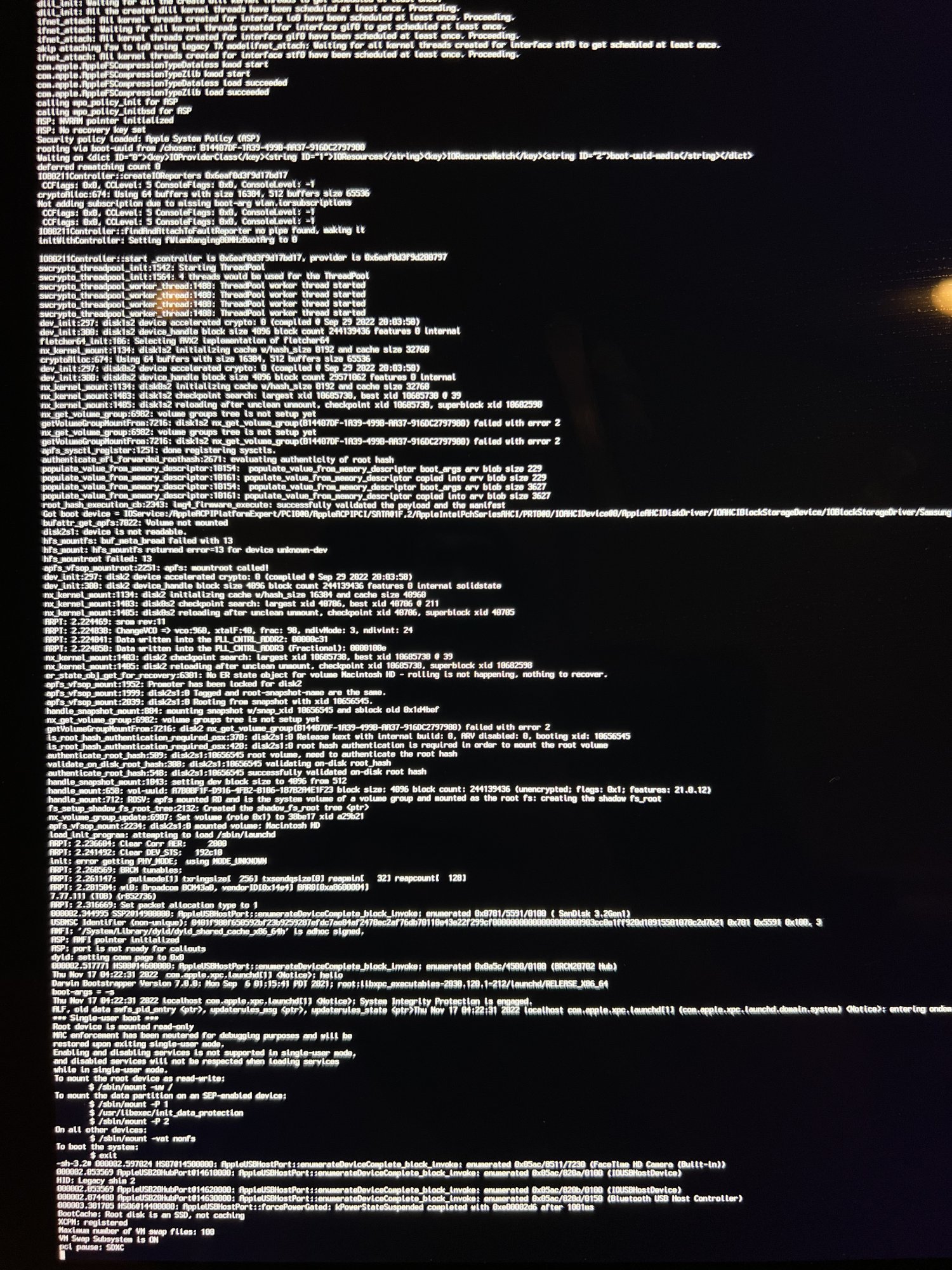

I can stay in this mode all day. Not sure what all of it means. I tried the fsck -fy but all I get is “error: container /dev/rdisk2 is mounted, repairs in a mounted container is not supported yet”
