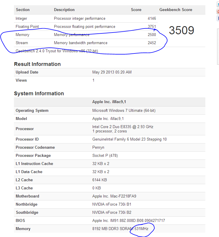

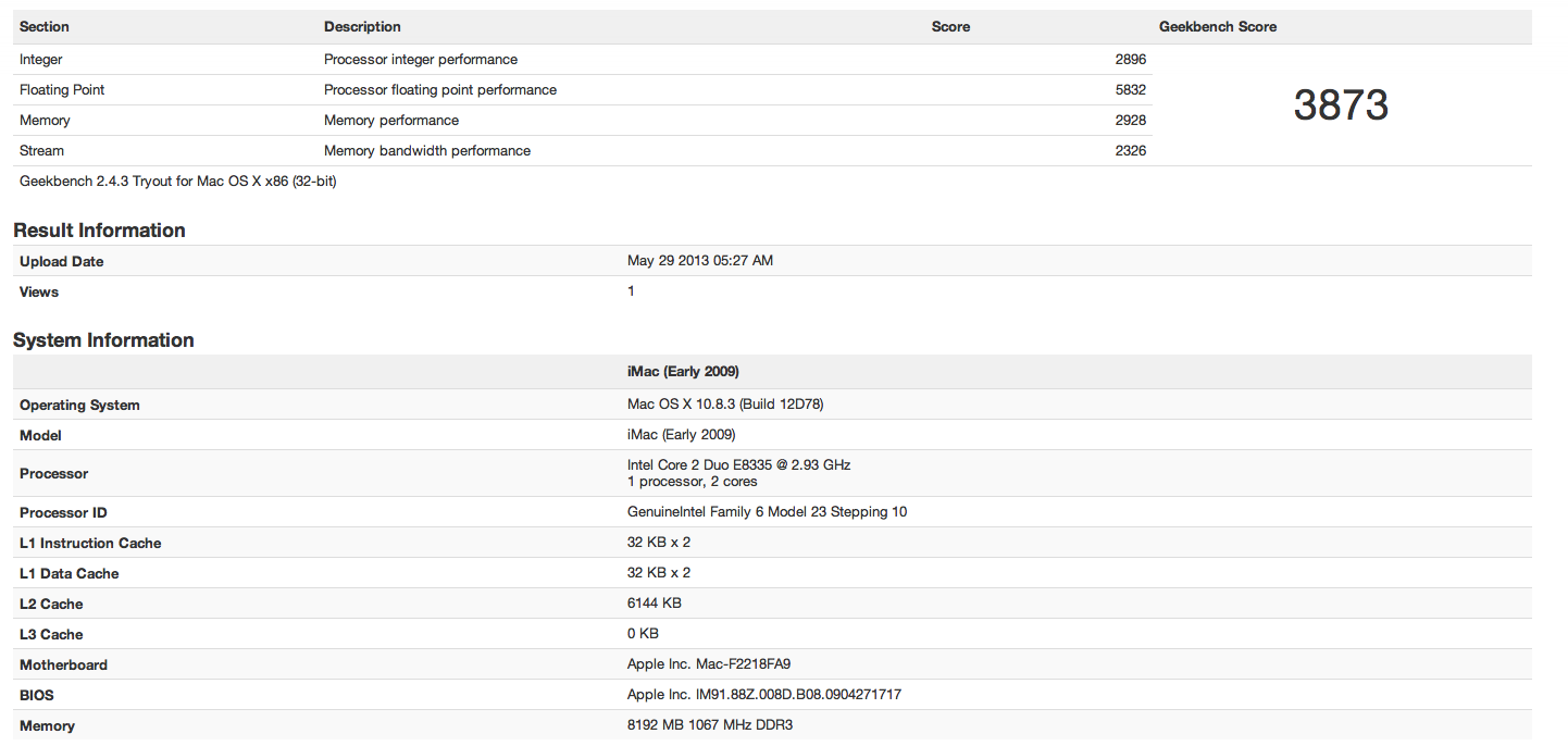

Umm I saw the stat in CPU-Z. Decided to run a geekbench test since it is cross platform and so I can compare stats
Mac:
Windows:
So it does seem that something is different on windows
If it was running at half speed your score would be far lower than that. You won't get identical scores between platforms.
