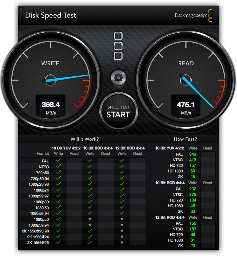

Hi,
Thanks for your input. Don't worry I bought the device specifically so I could take it apart and void my warranty, if something is going to fail it would most likely be the actual drives or power supply anyway 🙂
However good news. I noticed that the latest Crucial M4 firmware mentioned improved power up times and response. I upgraded the firmware and sleep now workings without a hitch, even with the Little Big Disk totally powering off when the iMac goes to sleep.
I am now very happy with my iMac / external SSD Raid 0 setup 🙂 And just for good measure here are some benchmarks.
Paul

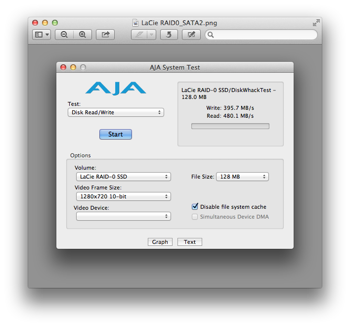

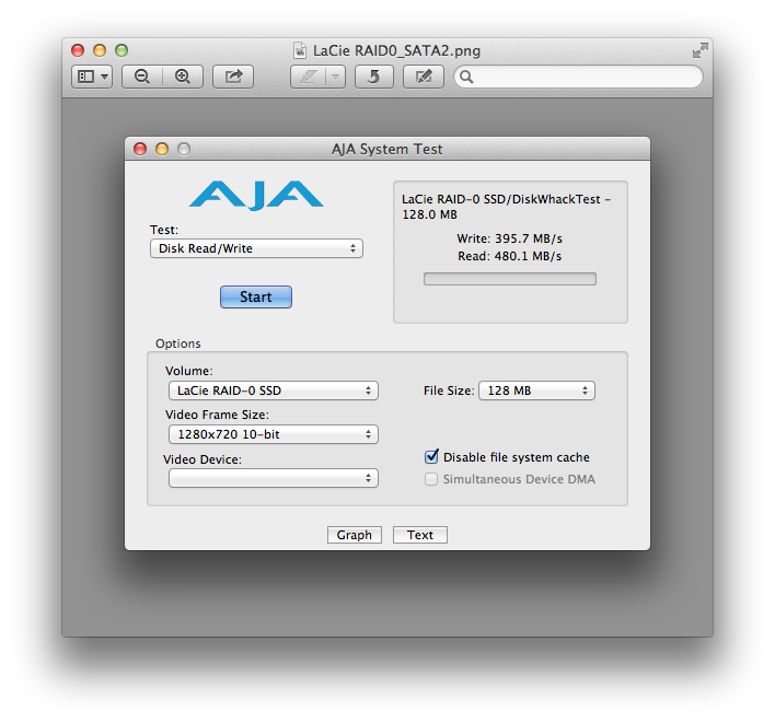

Hi Paul,
I have done the same "transplant" as you did on 2 LaCie "LittleBigDisk" enclosures and installed Crucial M4 SSDs in place of the hard disks. I am getting similar results as you with that test program and mine are working great as well. I have 512GB drives in one, and 256GB drives in the other and they are configured as RAID-0.
I have noticed that the test results posted here for actual oem LaCie LBD-SSD units do have a higher data transfer rate than I am seeing, so there may be something to the firmware issues mentioned above by "LaCieTech" several months ago. Both of mine do have SATA-III controller chips in them, but firmware changes could be involved. I would be interested if he could candidly expand on this topic ... ?
-howard
