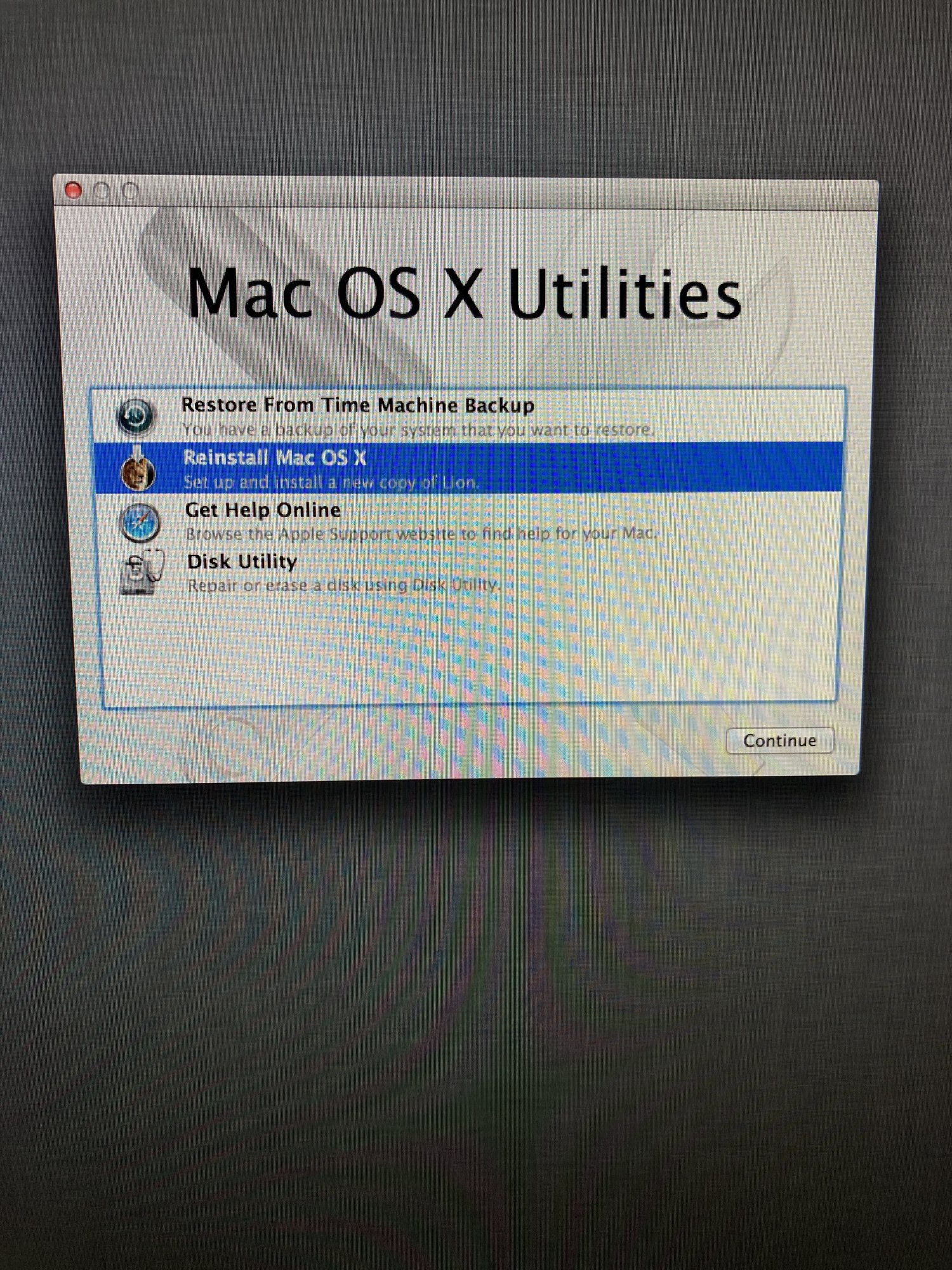

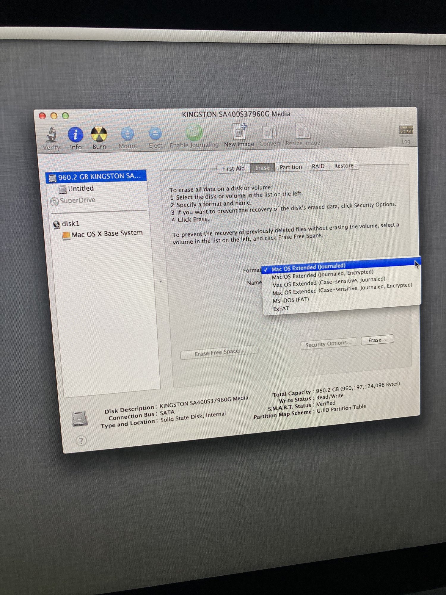

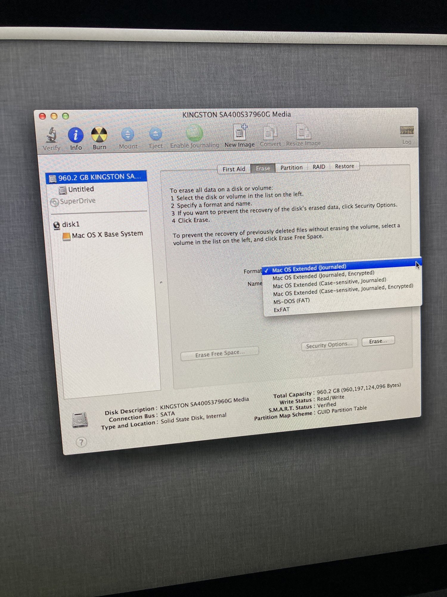

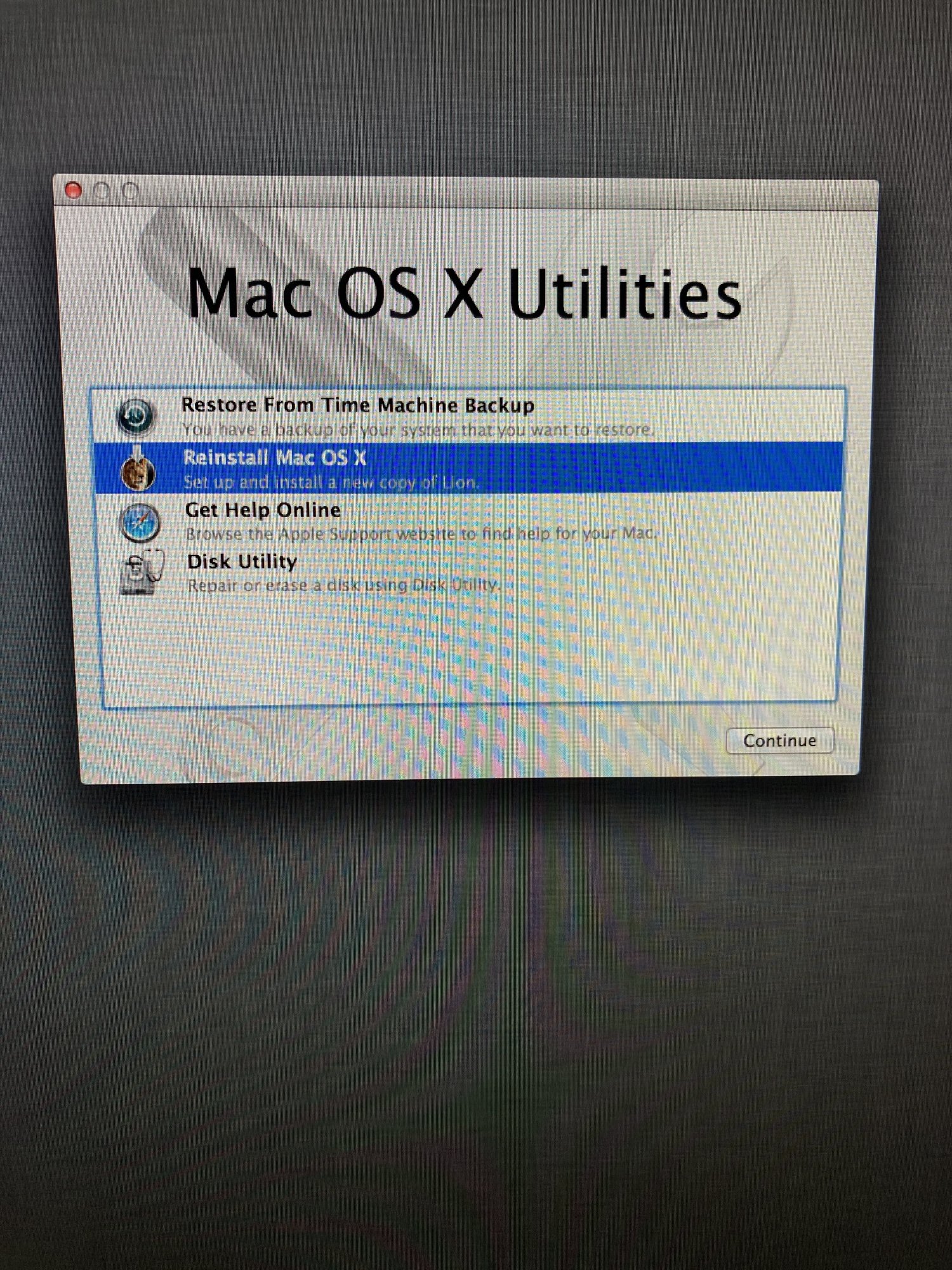

From internet recovery my option to format the drives are as follows:
This is the menu, no options to install anything but Lion

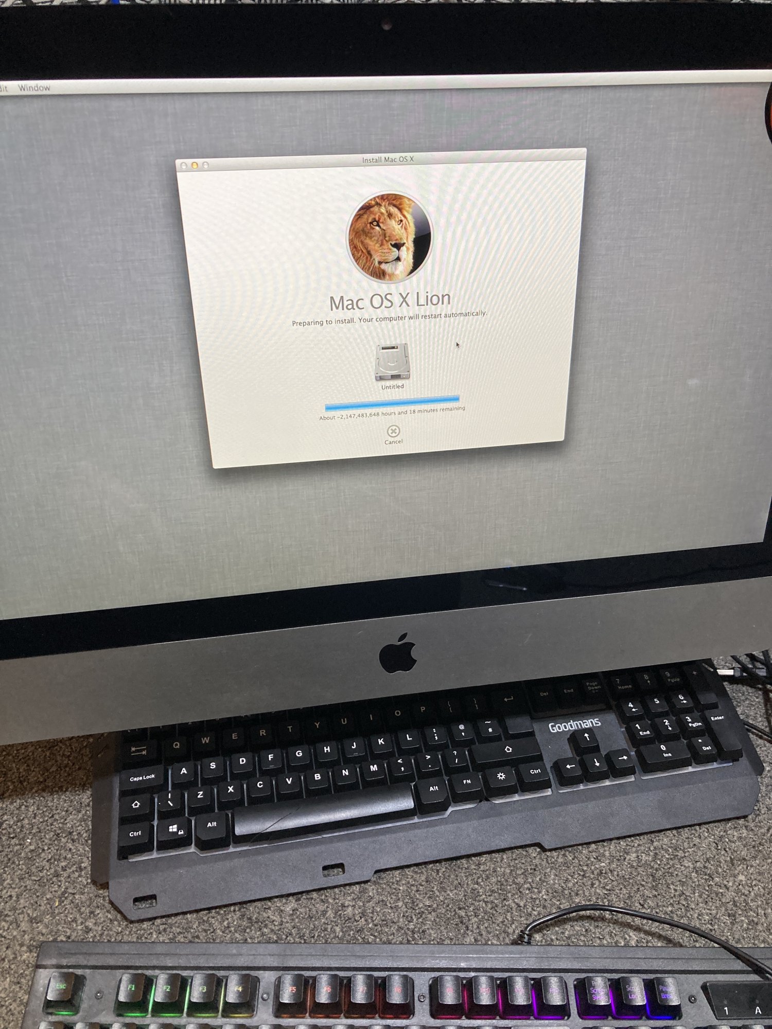

Created a bootable usb with OSx Lion. trying to hold options (alt) on start up to load boot menu to no avail.
Do you have access to another, working Mac?
If so, what version of the OS is running on it?
Do you have a USB drive around (either HDD or SSD)?
Just wondering... how did you create the flashdrive?

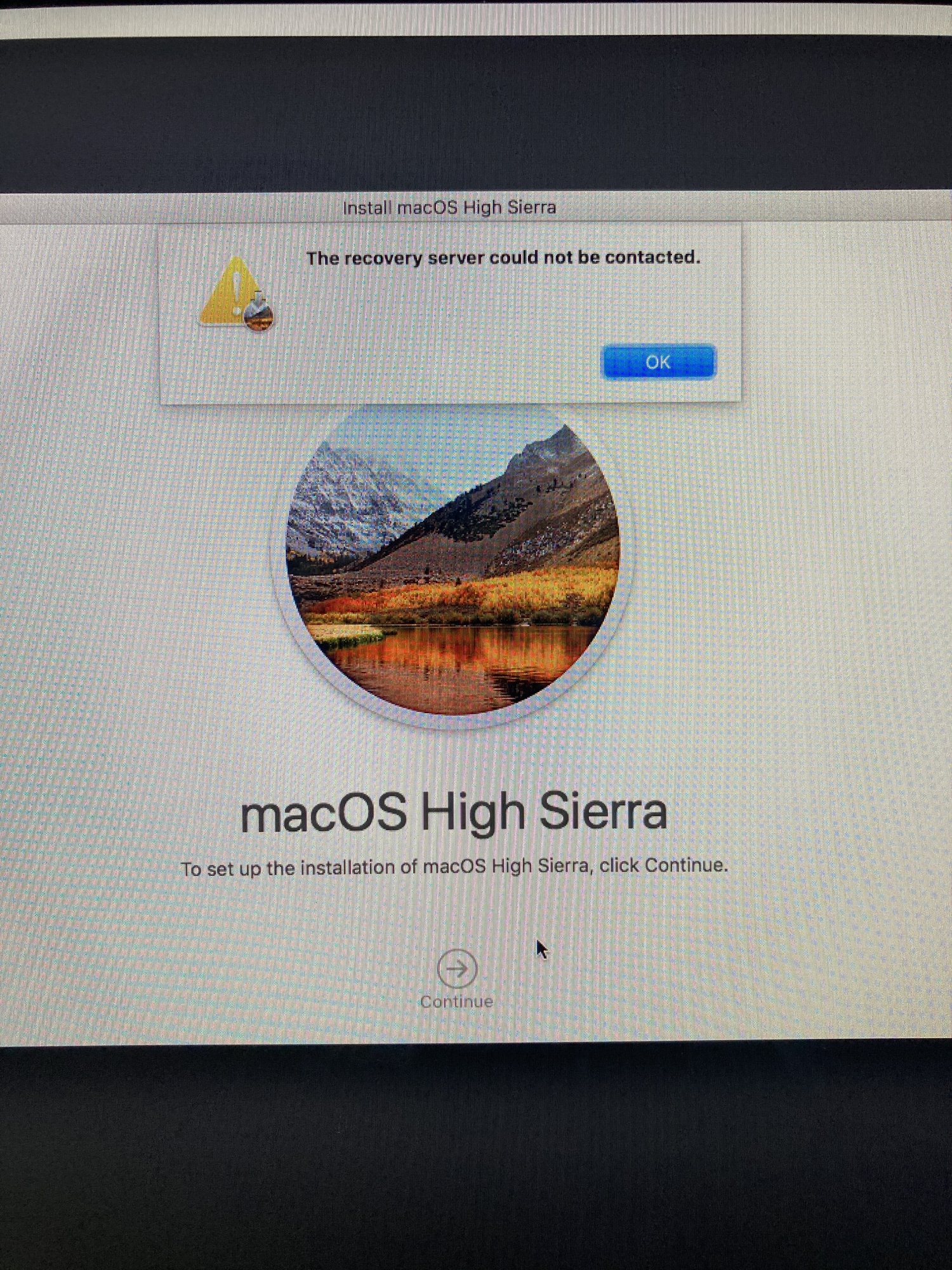

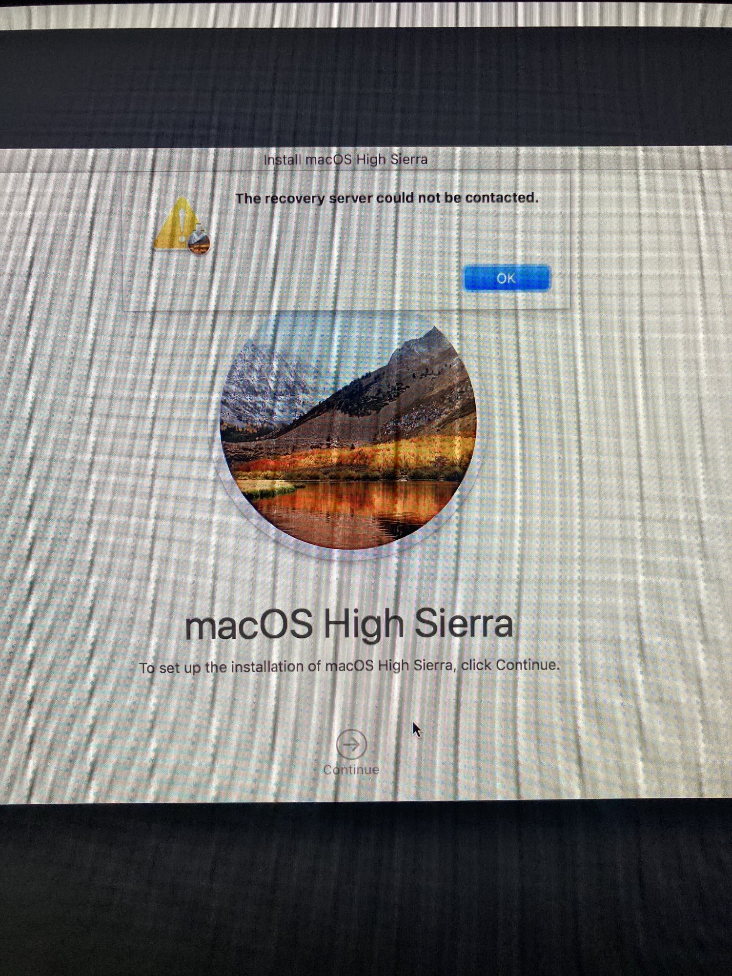

Okay so using a bootable usb with Lion gave me the same errors but using High Sierra I got the following…
The Disk Utility looked different and allowed me to format to APFS
I know a previous comment advised Big Sur but is that not OS 11?
You need access to another Mac.
You should use a Mac to create the bootable flashdrive, NOT a PC.
Also use a Mac to download the OS installer.
It looks like 10.13 "High Sierra" is the OS you want.
Or... 10.12 [Low] Sierra might be worth trying as well.
You could use the free utility "Install Disk Creator" to create the flashdrive.
Another option (maybe better):
There's a new free utility called "Mist".
It will download and create a bootable OS installer with just a few clicks.
You MIGHT need an Apple Silicon Mac to use it, however.
I'm thinking you're probably going to have to get "outside help" to resolve things, if you can neither get the installer to work through internet recovery or by using a bootable flashdrive.

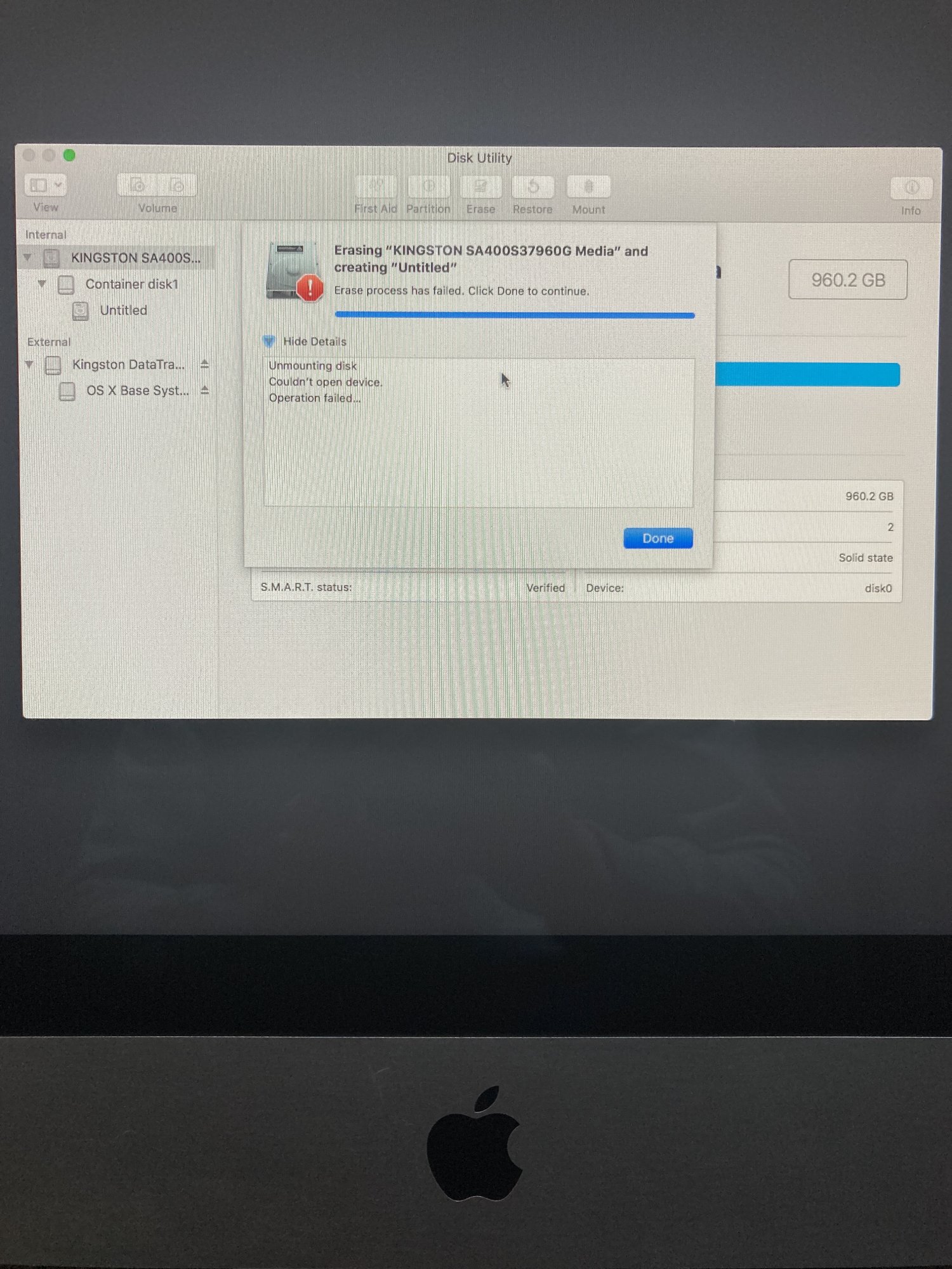

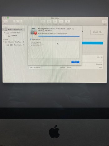

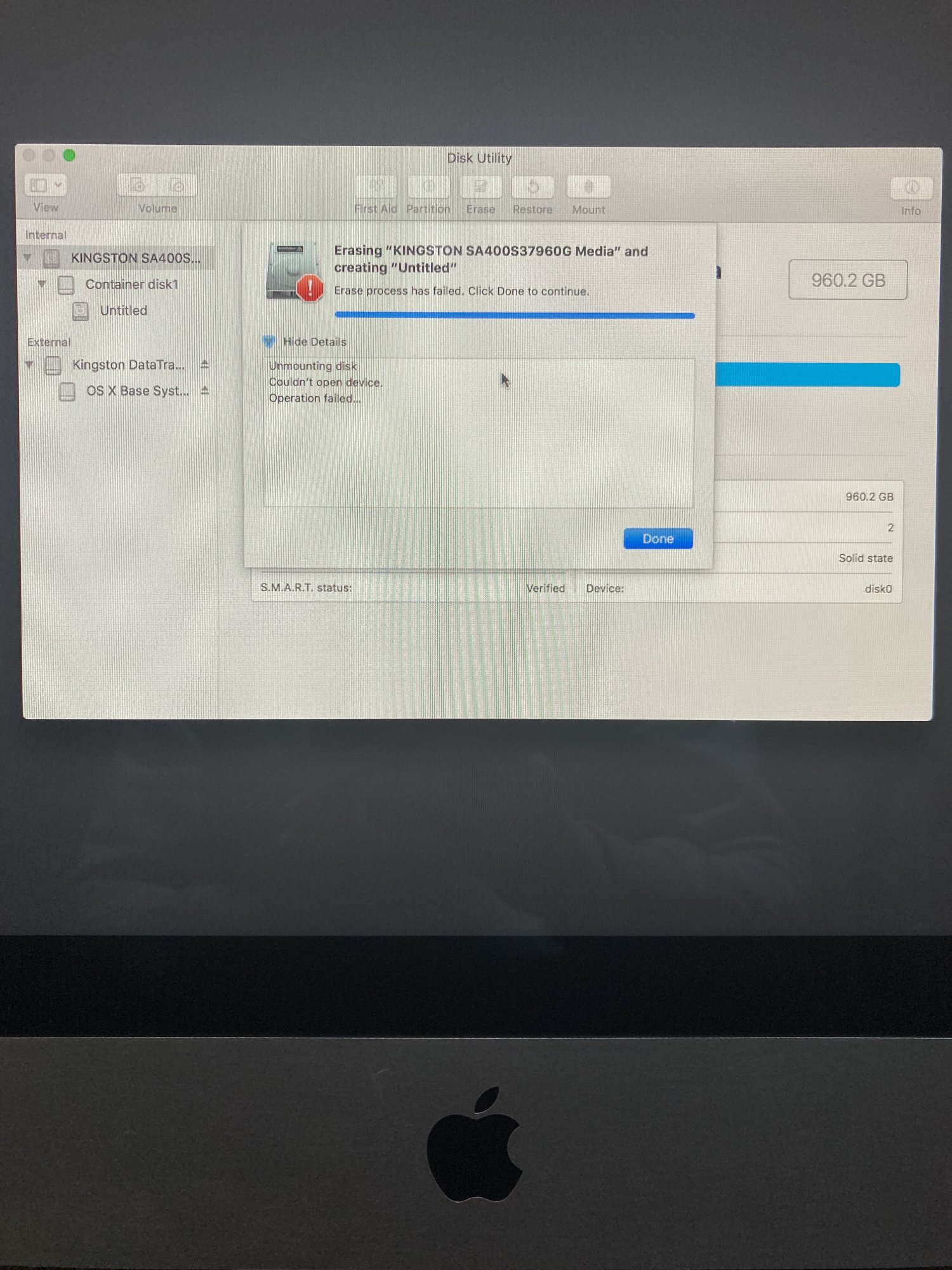

Any reason I can’t format the SSD now?
Do you have an EXTERNAL USB drive of some kind?
Either a platter-based hard drive (HDD) or an SSD?
If you do.
Connect it.
Use disk utility to erase it to "Mac OS extended, journaling enabled" (DO NOT use case sensitive)
Try to run the installer again, but this time "point" the installer to the external drive.
See if you can get the OS to install onto the external drive.
I’ve got USB, and a few SSDs. Fixed the formatting issue using terminal though
Okay I’m gonna try that now. Been stuck here for 10 minutes
Managed to get around it, still getting the error “can’t download the additional components needed to install Mac OS X” when directing to a different drive (64gb USB)
"Managed to get around it, still getting the error “can’t download the additional components needed to install Mac OS X” when directing to a different drive (64gb USB)"
Are you trying to connect via wifi or ethernet?
Ethernet is better.
Move the iMac if you need to.
(no promises)
