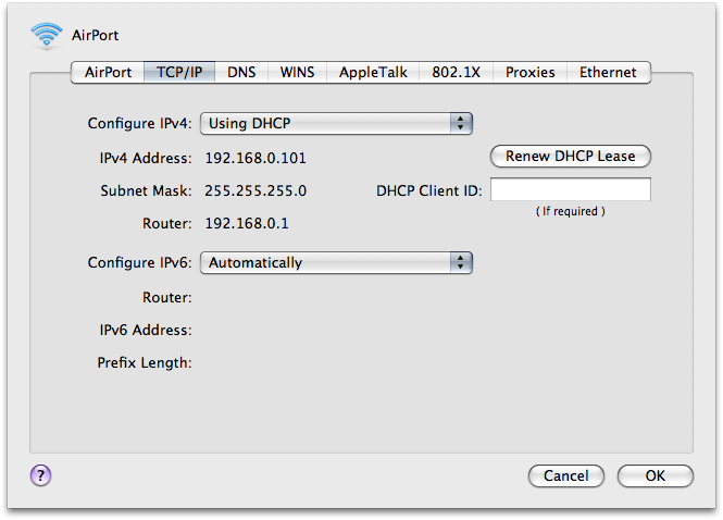

Take a look under
 -> System Preferences -> Network -> AirPort
Verify that your settings look like the attached image. If so, you could also try renewing the DHCP lease.
You've probably already done all of this, but that's all that comes to mind.

thanks BlueRev. Those are the current settings and I have renewed the lease. Unfortunatly when I renew the lease it seems to allow a connection (on some machines including the iMac) for less than a minute. Then back to no connection on any machine.
