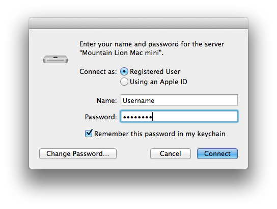

I assume you're connecting to the server through the shared section in a Finder window?
Are you checking the "Remember this password in keychain" option below the name / password fields? This should allow you to connect without reverting back to Guest. If you ARE checking that checkbox and it's still prompting as guest then you may need to clear the keychain entry for it in Keychain Access.
Yes thats right, connecting through the finder window. The remember... option is ticked. Do you mean clearing the "guest" entry in keychain or the username entry?
