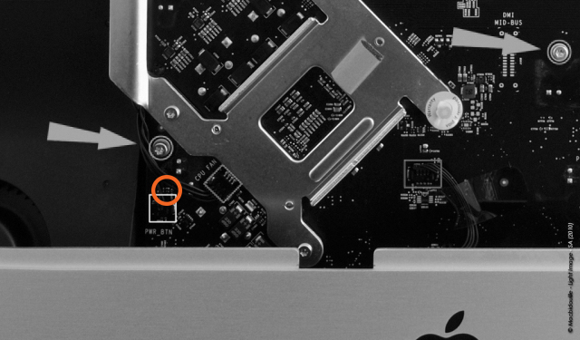

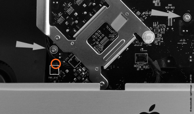

When I replaced the drive, I must have pulled to hard at something because immediately when I push the power button, the CPU fan starts spinning at full speed. I triple checked if everything was connected and there seems nothing wrong.
I know that when you replace a hdd, the temp sensor disappears and your HDD-fan also spins at full speed, but this I've managed to fix through some free software. The CPU-fan still reads 0 rpm.
I've did some research and found someone on macrumors-forum who has put a resistor on the CPU-fan connector, this isn't a full fix though, it just makes your CPU-fan run slower. So when a higher rpm is needed, this isn't possible.
I couldn't find the link but somewhere else I've found someone who saw that when he unplugged the Power button connector, a tiny resistor had come off. Check attachment: the orange circle marks the spot (sorry for the other arrows)
I've brought my beloved iMac to a computer specialist, let the resistor solder back on (new one, same kind) but without succes.
Anyone had some experience with this and/or has a solution rather than buying a new logic board or iMac?
Help is appreciated!

Did you figure out what was wrong with iMac finally? I'm having the exact same problem with mine, except no resistor is missing from the board...
Thanks!
Matt
