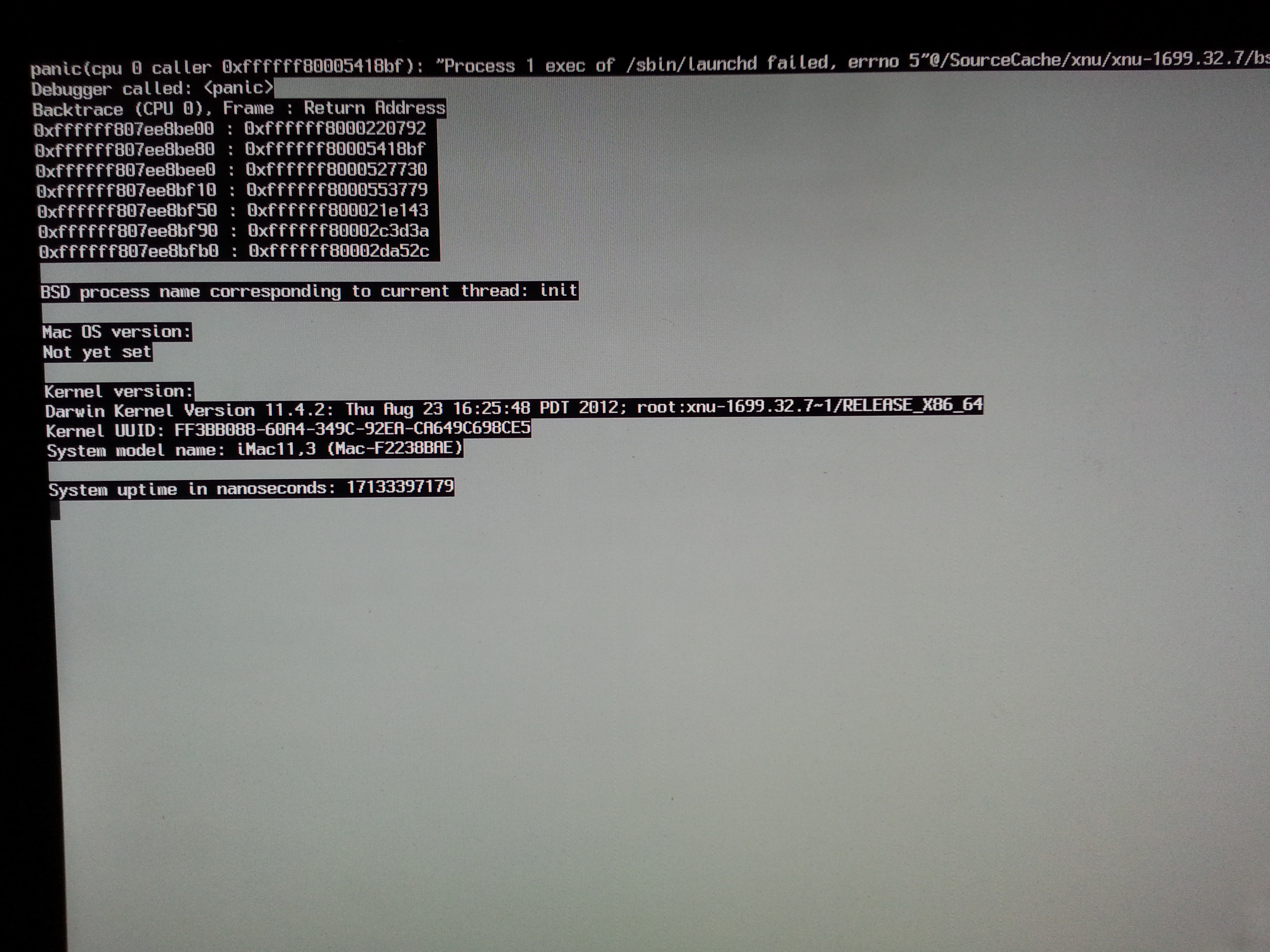

And now when I turn the iMac back on... I see this on my screen (see attachment pls) 😱
Does anybody know what happened? And more importantly, how on earth can I fix anything?!

I say there's more problems here, actually I think the GPU is faulty, the reason I say this is that the Display in your screenshot is shot.

I can't run the Apple Hardware Test... the screen stays like the picture for 30 seconds and then turns off...
So how can I figure out whether the problem is the GPU or the internald hard drive...?!

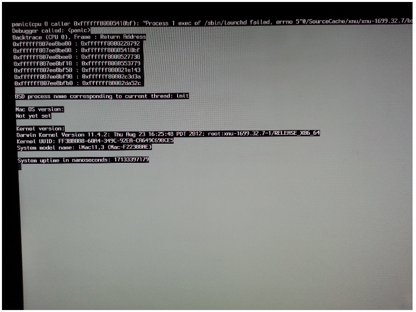

Don't be offended Maxi, but I don't understand why people post these huge images and not resize them, a shot like that should be a JPG of 200 KB max.
here you go
here you go
Cheers MonkeySee....
Seems like OS permissions or no OS available at this time.
In the first line it says:
Process 1 exec of /sbin/launchd failed
This process can't be launchd, this is a process needed by the System so I think it can't be launched due to the wrong file permissions.
