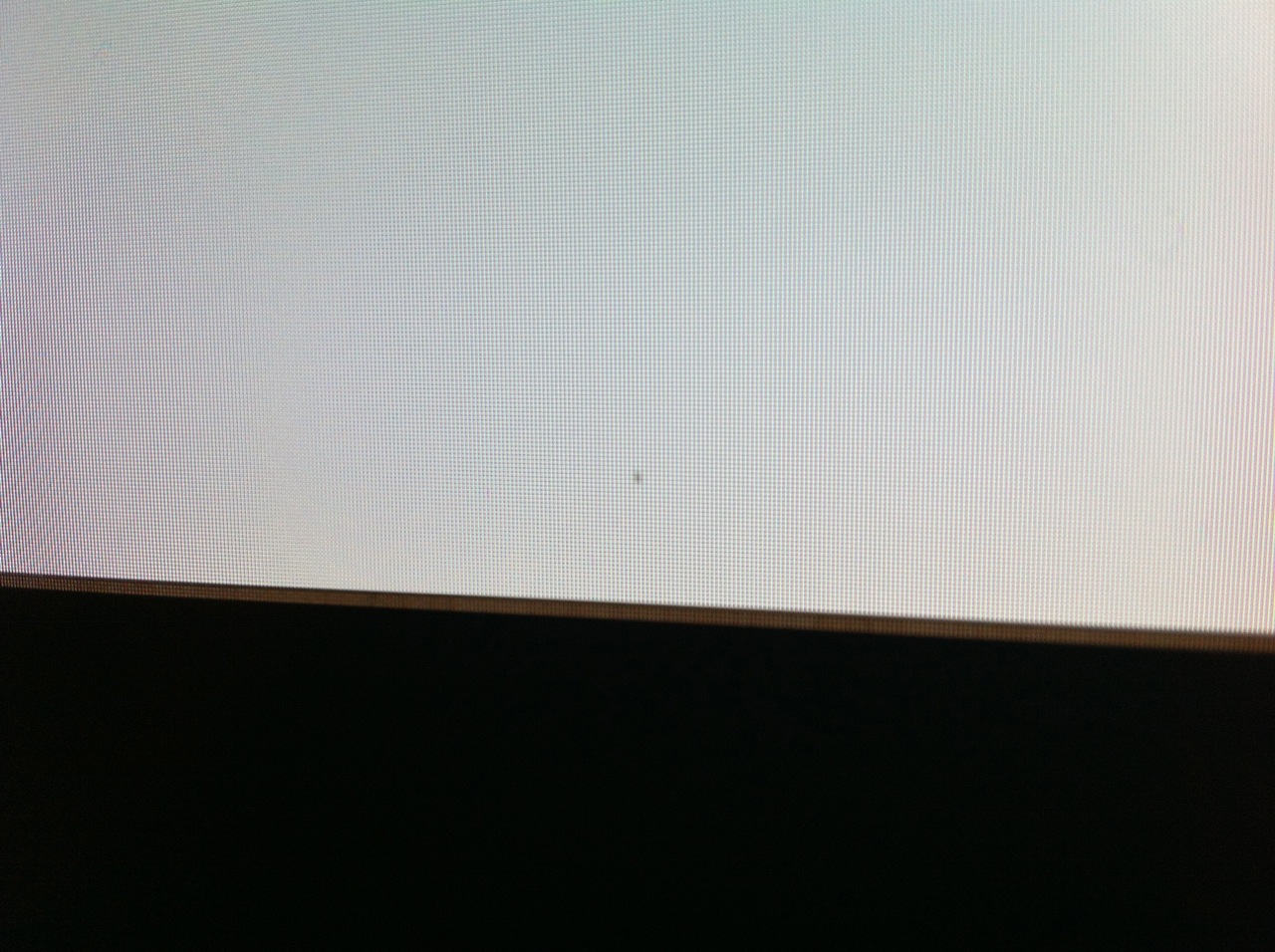

Just noticed I have something very similar to what you are referring to on my 2 day old mid 2011 27" iMac. Just got it the other day and noticed a very small set of gray/blurred pixels near my dock. At first i thought it was just part of the "Launchpad" dock icon, but once it hid the dock and set a white wallpaper, I knew it wasn't. Its not crisp but rather shiny/blurred, like its under the glass.
So you guys thinking this is moisture and might go away? Going to give it a few more days and then take it up the the apple store if it doesn't go away. They would just remove the glass and clean it or replace the glass and not the entire machine correct?
I had this exact same problem with my 2010 i7. It was a large blob of dust stuck between the backlight and display layers of the LCD. Mouse over it and move your head around looking at the dust and notice the parallax effect. I took it to the Apple Store and had the display replaced - entirely covered by AppleCare. My iMac has been trouble-free since.
Dust... that makes since. Yeh the parallax effect is correct. Its not bothering me since its located down by my dock, but paying 3K for a new iMac, I'm definitely going to get it fixed while i can. Thanks for your help!
