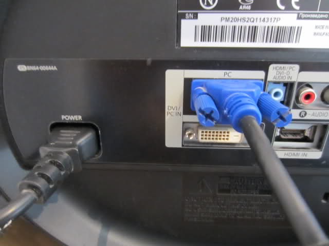

I brought an iMac 21.5 yesterday and the apple mini dvi to VGA converter so i could use my old samsung monitor as a dual screen with the mac.
I connected it all together and it isn't working. I've had the display settings up and tried 'detect displays' but still nothing comes up on the samsung screen.
It's a samsung 2032mw.
anyone know what i can do? thanks.
Heres some pics.
First, That is a mini-display port to VGA adapter (which is the correct one for your iMac) not mini-dvi.
Second, have you setup the Samsung monitor to auto scan the input ports or set it manually to analog?

opps yeh mini display, my mistake!
I haven't setup anything on the samsung monitor. Not sure what to do on it?

Do you mean like the source button? in that case yes, i am changing the source but still nothing is happening.
I am putting the VGA cable in where it sais PC IN. Could this mean it's not the right port for dual monitoring?
should i get a mini display to DVI adapter and a DVI cable instead of the VGA cable?

Yes, Source. Does the screen shown analog when you press source? Do you see the searching for source on screen when you switch?
Is this a 2011 iMac? I'm not sure it matters but the latest I've tried is the 2010 iMac.

The source it comes up with is just PC.

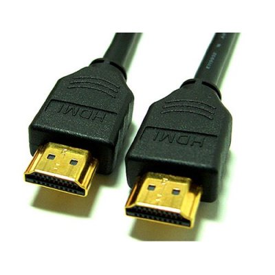

Hellhammer, i just had a VGA cable at the time. But i could buy a DVI cable i suppose? could you link me to the cable i would need please?
Just a side note, why don't you use DVI instead? Better quality.
Even better why not use a HDMI calbe? much better quality than any of the VGA/DVI cables.
I am sorry I don't know many shops around your area but you will be looking at something looking like this:

I ended up taking it back to the shop and changing it for the HDMI adapter and it now works.
Only problem is, i'm not to sure what res to have the samsung screen on. when it's in 1080p, 1080i, 720p the text looks very small and weird. Then other res settings i choose are not to good either. oh well!

Your monitor has resolution of 1680x1050 so you should use that.
