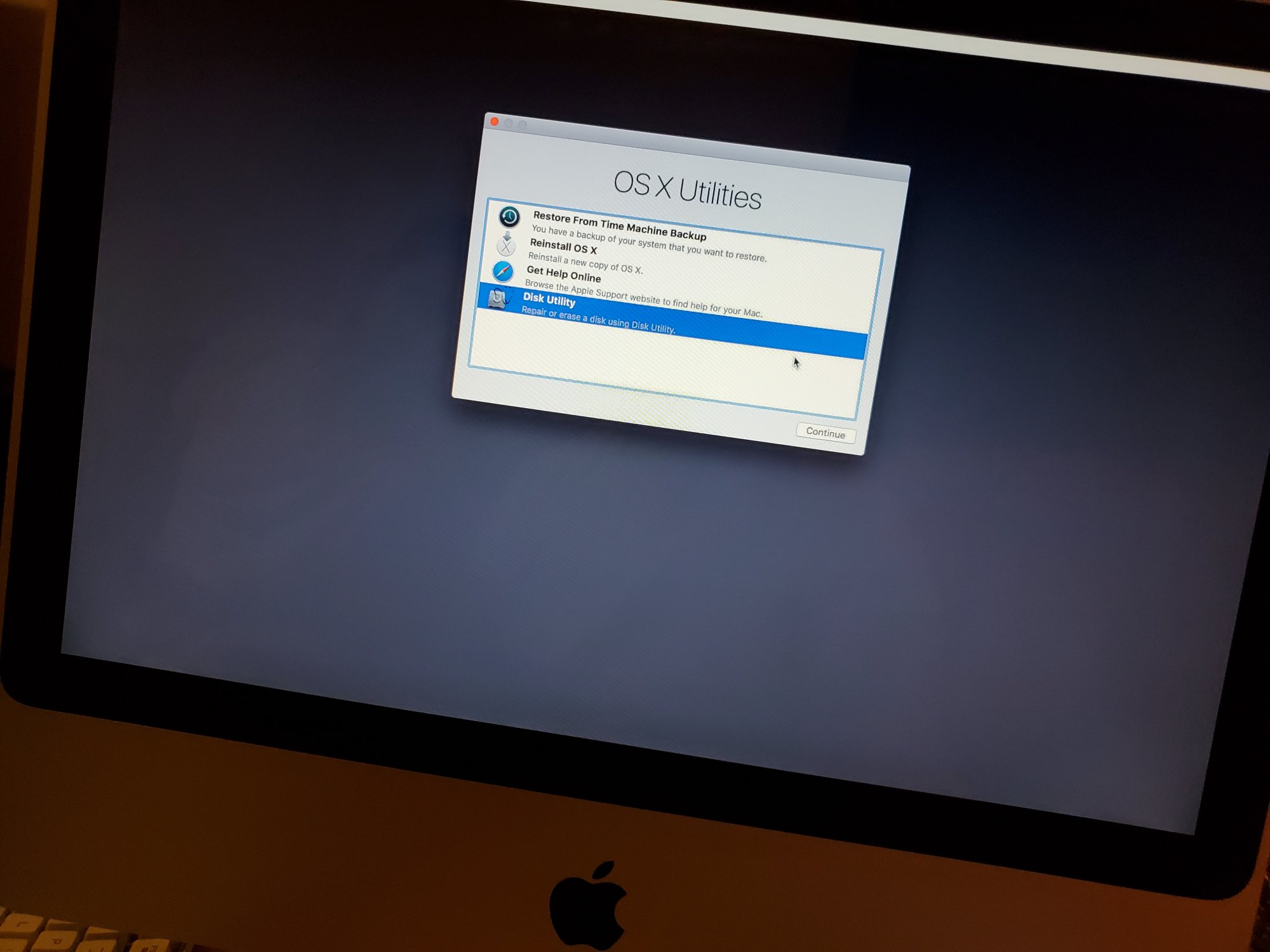

Okay so I'm completely new to macs. My girlfriend got one and it needed to be rebooted. Me thinking I was smart learned to put it into recovery mode and did a clean wipe. After doing that I wasn't able to reinstall anything because we weren't the originals owners of this mac. So now I'm stuck in recovery mode without being able to get into Internet recovery mode.

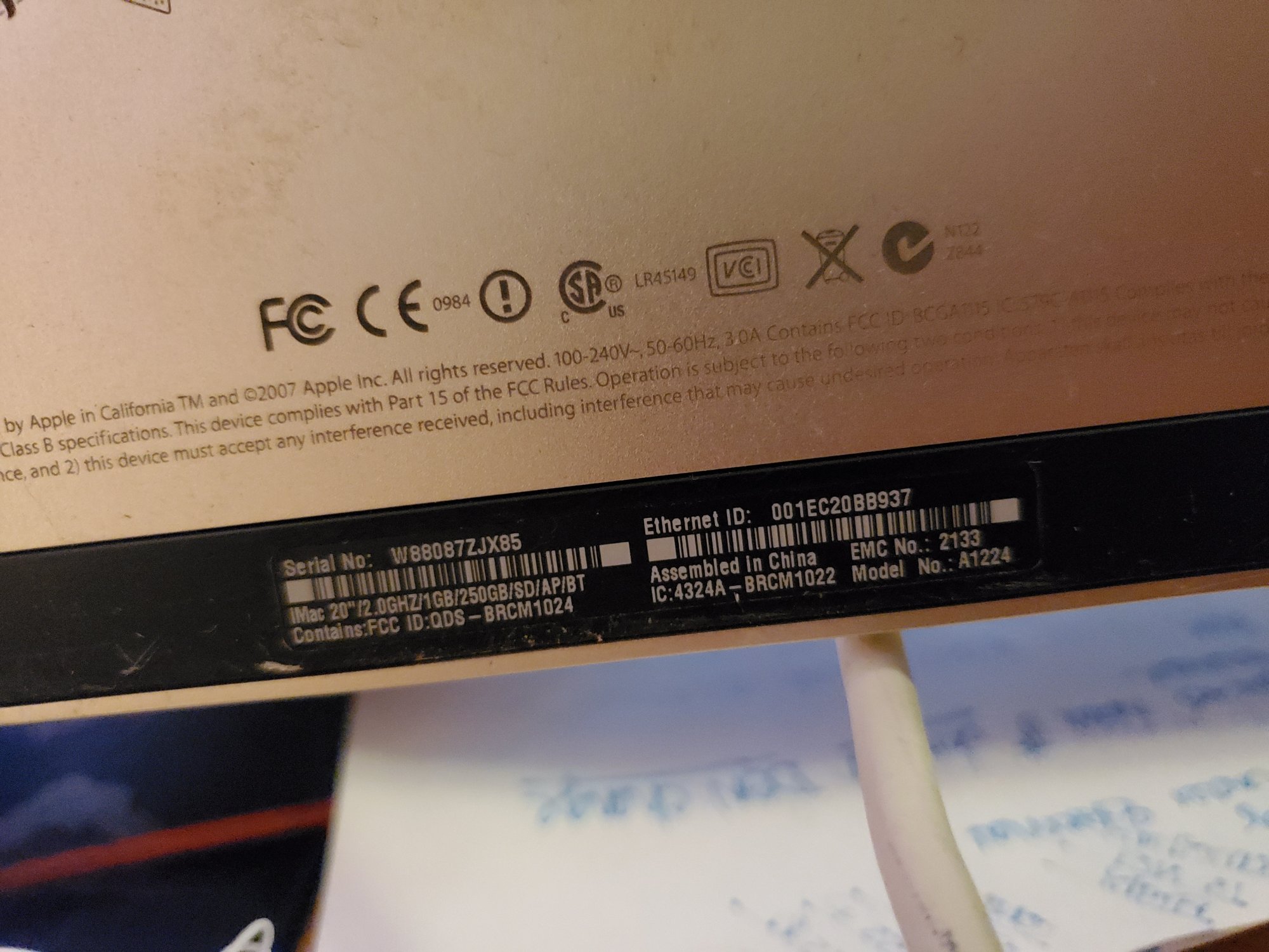

So I tried to get into internet recovery with cmd and opt +r and no internet recovery mode. So i figured it was a Imac 2007 A1224 model. its pretty old. i also posted pictures of it. The video i posted above thats the method I used to get the boot image but the usb isn't registering when I hold the opt button on start up only the recovery image that I cant use. After that it brings me into recovery mode not able to really do anything besides erase the hard drive over and over again.

Whoa that's a classic machine there. Looks like a 2007 model, specs here.
Check out this thread where they discussed what might be the best OS X for you to install. That thing is not going to take Mojave but El Cap should be fine.
Good thing it's booting into recovery mode. What happens when you select "reinstall OSX?"
So I get to the point where it asks me to sign in to my apple Id. Other than that nothing happens. I'm not the original owner so it just kicks me out and asks me to sign in again and again and again.
