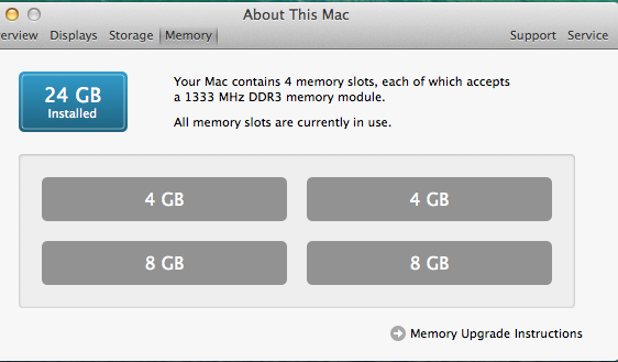

Regarding the memory, does the below image look right? I upgraded the memory in order to make things faster about 6 months ago but that did not seem to help. My previous iMac seemed way faster out of the box than this new one!
Image isn't working for me, sorry.
