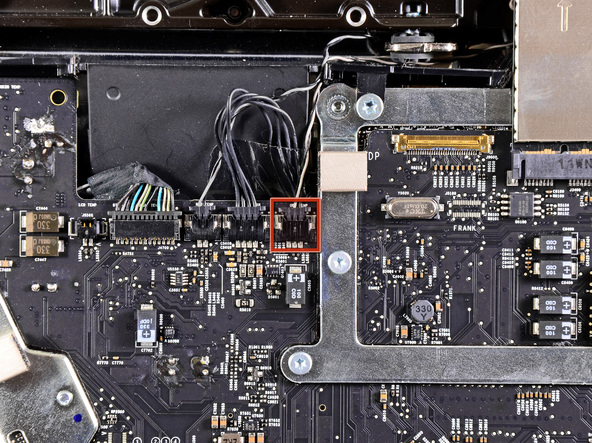

I would imagine the CPU fan is faulty. The ODD may be running up to max to compensate. Either the CPU fan is faulty, or the connectivity to the mainboard is broken. Check ifixit.com.
That's the optical disk drive fan...my guess is your "odd" sensor wire has come loose...
use ifixit to repair

The OP said the CPU fan was at 0 RPM, which to me reads like a issue related to that as primary culprit.
I would investigate both CPU and ODD fans/sensors anyway to be on the safe side 🙂

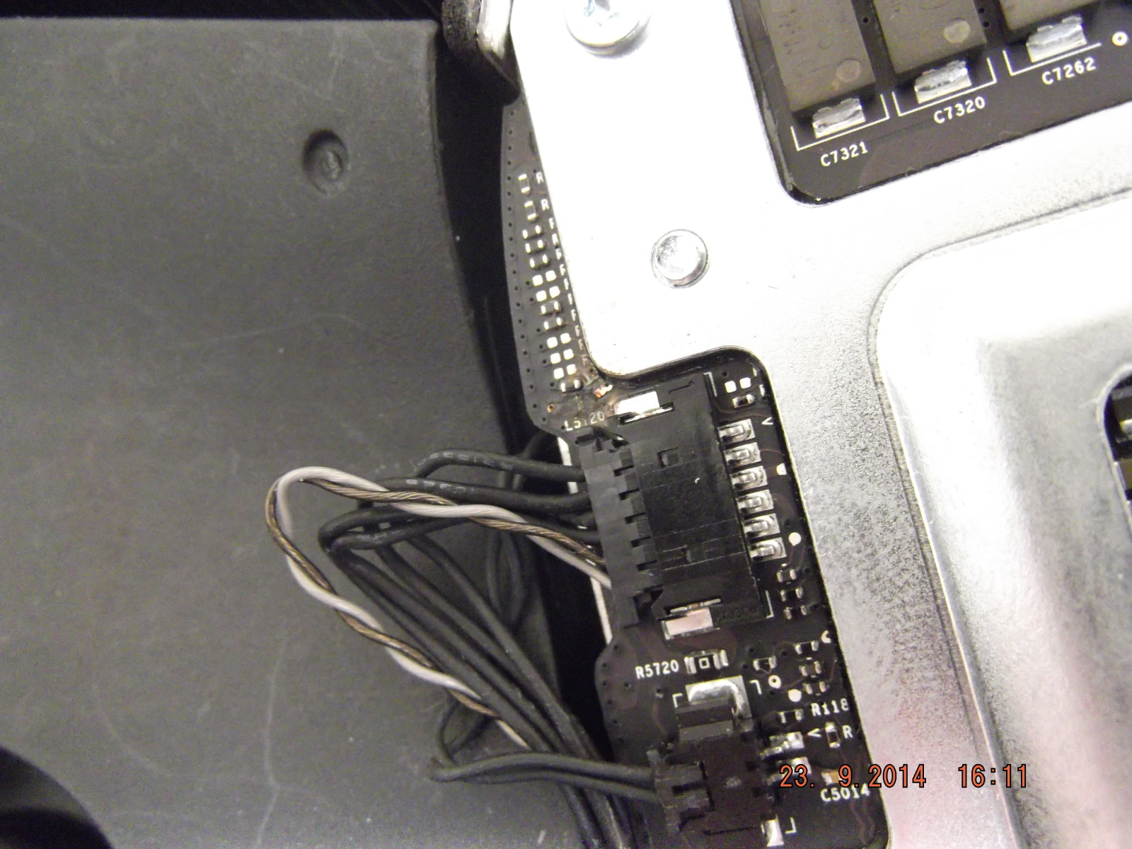

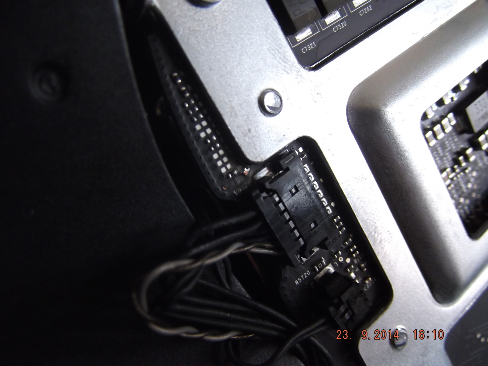

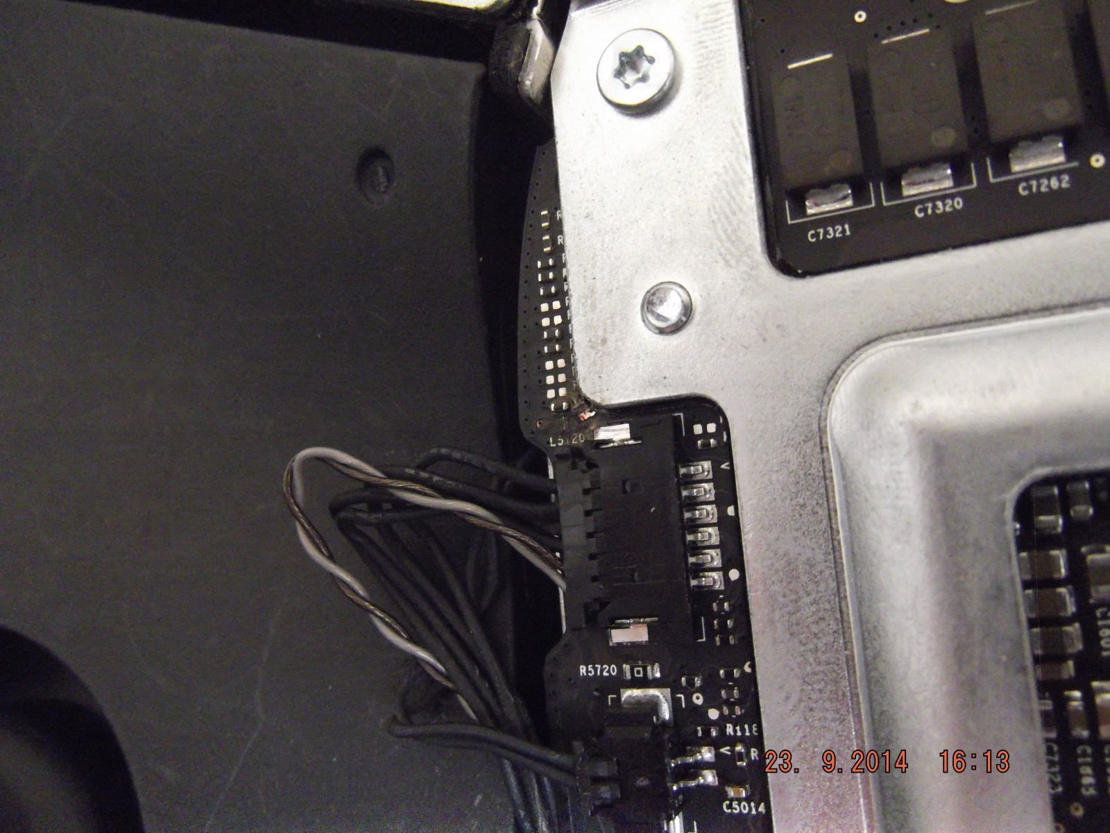

Tried a New cpu fan and it hasn't resolved the issue. On closer inspection there is a scorch mark next to the fan connector. I think one of the resistors has blown but I don't know if they can be replaced?
See below links to 3 pictures I have taken. I think the missing component says L5720. Would be good if someone could upload a picture of that area on a working logic board.
