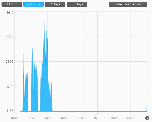

Yeah I've got those stats from iStat. The highest I've got was 3600 watching a YouTube video and now i'm getting 2200 while browsing the web. Not to bad right now, but at over 3000 it gets annoyingly loud.

are you sure it's fahrenheit? 64 Fahrenheit is room temperature..
perhaps extended exposure to full on fans will do that.
Maybe, i'm not sure. Still, it's constantly running high

What does the activity monitor show for CPU as far as percentage when the fan is up?
