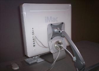

An additional suggestion (and yes, it's a serious one):
In the future, perhaps you need a desk that will support the iMac somewhat more securely.....
When you get it fixed, secure it with one of these:
